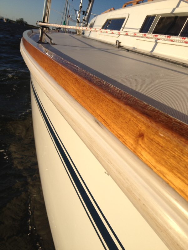

On the 36-2 and other similar vintages, there is a heavy plastic rub rail... L shaped that is through-bolted to deck/hull. The toe rail sits ontop of the rub rail and hides the bolt heads. I'll snap a picture today and post

A pic would help. How do I see them? I see an "insert image" button. If I want to upload a photo is that where to go? The button asks for a url. Do I have to find a place to put the photo outside of my computer? If so, I assume I can use dropbox? I've used dropbox for photos before so if that's all there is to it I've got it.
