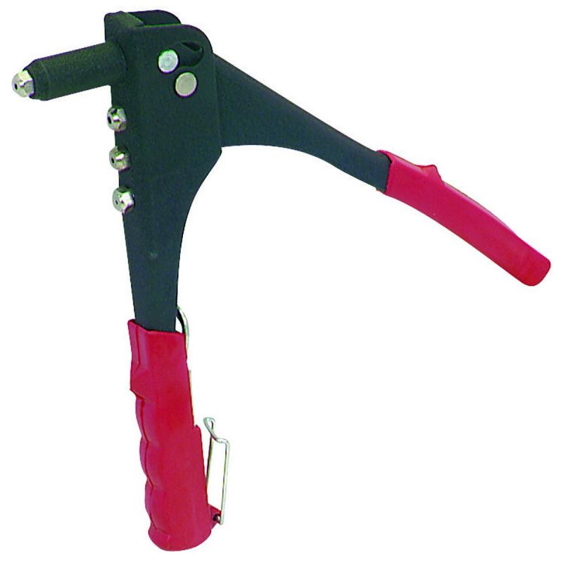

Not all rivet guns are created equal. I have a light duty gun that will handle rivets with a 1/16" nail, and I have another one that takes interchangeable tips that will accommodate nails from 1/16" to 3/16". I have used the larger gun to put in stainless rivets in my mast. I got the HD gun from Harbor Freight.
So if you have a local HF, and you are certain that the rivets are the correct length for the mast and the bracket together, I would be tempted to go and spend $5 on the HD rivet gun. You will probably be likely to need it another time. See the pix below for the one that I have from HF.
