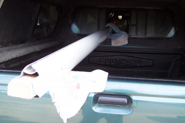

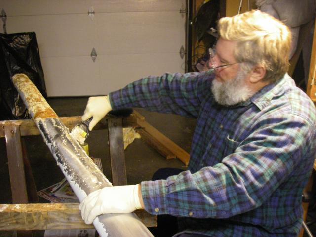

1 Removed old paint using paint remover and only plastic scrapers and "plastic wool"/cleaning pads.
2 Took it to a local body shop for painting
3 Put wooden plugs in the ends to protect against incidental bumps and dings while transporting.
Under the old paint it was really in prety good condition and I did not feel the need to fill or smooth out any pits or anything. The painting was about $120 and they told me that by bring it in in shiny, ready to paint condition I had cut off about $400 on the job.
