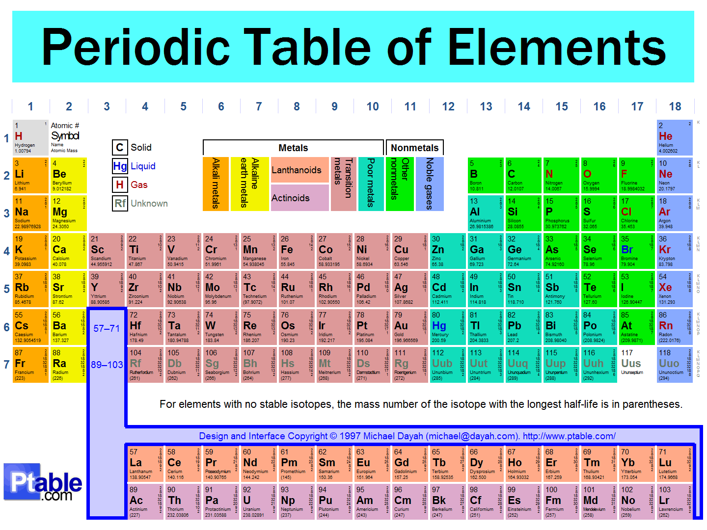

He said it was for the benefit of the bay as way too much magnesium was being deposited by zinc anodes
Say What?:confused:
So WM [clerk] thinks depositing Magnesium is Bad, from a Zinc sacrificial Anode?
But it is ok to deposit Aluminum.:doh:
OMG...
If you DON'T uses an anode you deposit IRON!!!!!:yikes:
My local WestMarine Store will deliver any on-line product to their store [I pick up] or directly to me.
I have to admit, the last time I swam in the Chesapeake Bay, it was Salt Water [ closer to Annapolis ]
Get you money back, write WestMarine why and go to where dlochner said...
Jim...
PS: To change the Element Zinc to the Element Magnesium would take splitting the Atom.:badbad:

@bawlmer It is the chart man.. the chart.
Not the insight or blind sight of the WM sales team...
High School Chemistry...
  • “Electrochemical corrosion of metals occurs when electrons from atoms at the surface of the metal are transferred to a suitable electron acceptor or depolarizer. Water must be present to serve as a medium for the transport of ions.”
It is kind of like the story of Roots...
“In a sense, corrosion can be viewed as the spontaneous return of metals to their ores;”​
