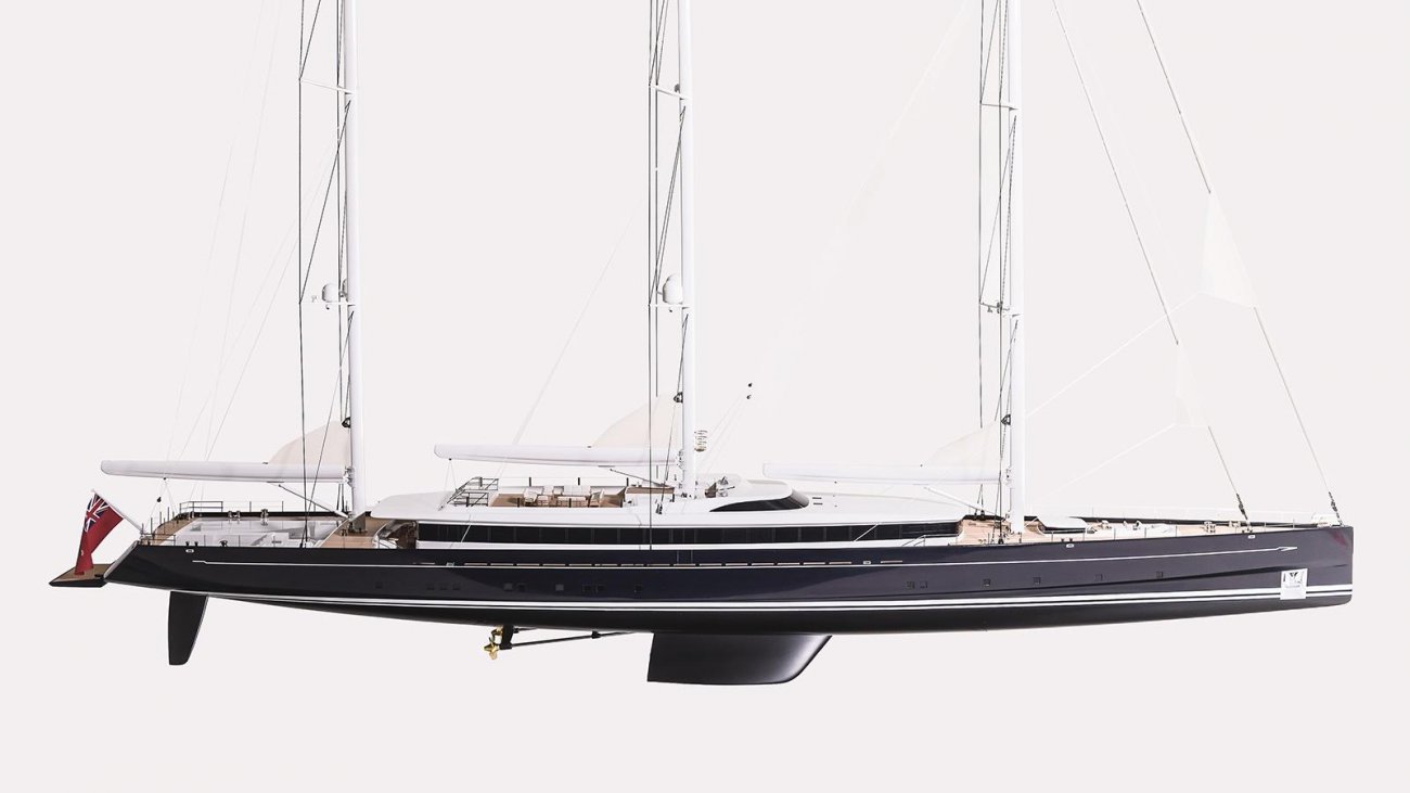

If Aluminum is so bad as a tool to use why would the someone invest so much money.
https://yachtharbour.com/news/world-s-largest-aluminium-yacht-in-build-at-royal-huisman-1829
This is a boat due to be completed in 2020
They just flipped the 81 meter hull.
https://www.royalhuisman.com/royal-huisman-turns-largest-hull-ever/
Quite a trick.
Because it is much cheaper for a non-production boat. Fiberglass needs to be built in a mold. Building a mold for a single one off boat adds to the cost. You end up building the boat 3 times instead of once. The process of fiberglass means you build a plug, then build a mold, and then build a boat. If you can't spread that cost out over multiple hulls, it gets really expensive.
For one offs, there are other approaches to fiberglass. You can build a plug to build a mold to build the hull or you can build the core and sandwich it in glass. Of course, then you have all the problems of cored glass construction. Done right and cared for, it can last as long as any boat.

It's still cheaper to build with metal than fiberglass for a one off, even if you build a frame, core, laminate structure.
In production building, fiberglass is cheaper. One offs, metal is cheaper. Steel rusts and is 3 times as dense as aluminum so a lot of customs are aluminum. Carbon fiber is stronger and stiffer than any of the above (fiberglass, aluminum and even steel) so is a better material for boats but is also more expensive.
