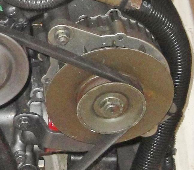

We are having a problem with belt tension and noticed our alternator seems loose. To our surprise there doesn't seem to be a nut on the end of our "swing" bolt. We just loosened the back and the alternator starting to loosen and we could push it up on the swing and tighten it back down without a nut on the front. Seems odd but it does hold so far. Do we need a nut on the front of the "swing" bolt?
We tried fitting a nut on the end and nothing seems to fit.

first off, you probably mean the "pivot" bolt? at the 9 o'clock position?
May 27, 2004
2,059
I think he means the "nutless" bolt at the 5:00 position. My Yanmar GM20F alternator mount has the head of that bolt on the front side and a longer bolt with a nut on the back side.
But, since we don't know what the engine model is or what a previous owner may have done in the past, it's just a SWAG.

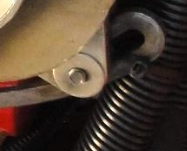

The nutless bolt in the 5 o'clock position is the one I am referring to

Most likely the engine is a Yanmar by its general appearance and a 3GM by the boat size. Please, always state your engine make and model as a Pearson will contain any number of different engine makes over the years.
The question now is "which swing bolt" as that is not a name for the three supports. I'll take a wild guess and say it's the top one under the belt in the OP's picture.

You've answered your own question. The alt. casing at that point is 1/2"thick which is threaded and no nut required.

Our solution was that after we loosened the bolt, one person lifted the alternator to tighten the belt, and then we tightened the nut. Seems to have worked so far. There is some vibration when we run the motor and we think that the alternator isn't 100% properly aligned, but it is a lot better than it was! We are getting there. How would we adjust the forward and aft alignment of the alternator?

You can just put a longer bolt through the alternator adjuster ear (should be 5/16" X 18 but may also be M8 depending upon the vintage of the Balmar.) then lock it down with a nut and locking washer. Also be sure the pivot bolt is sized incorrectly for the alternator feet. Those feet are typically a 10mm bore and some Yanmar pivot bolts are 8mm.

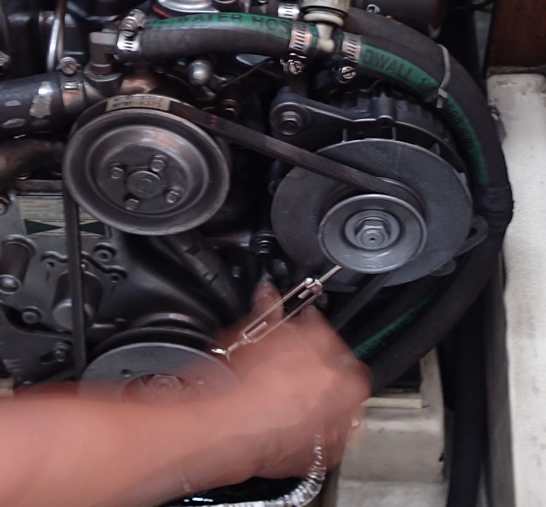

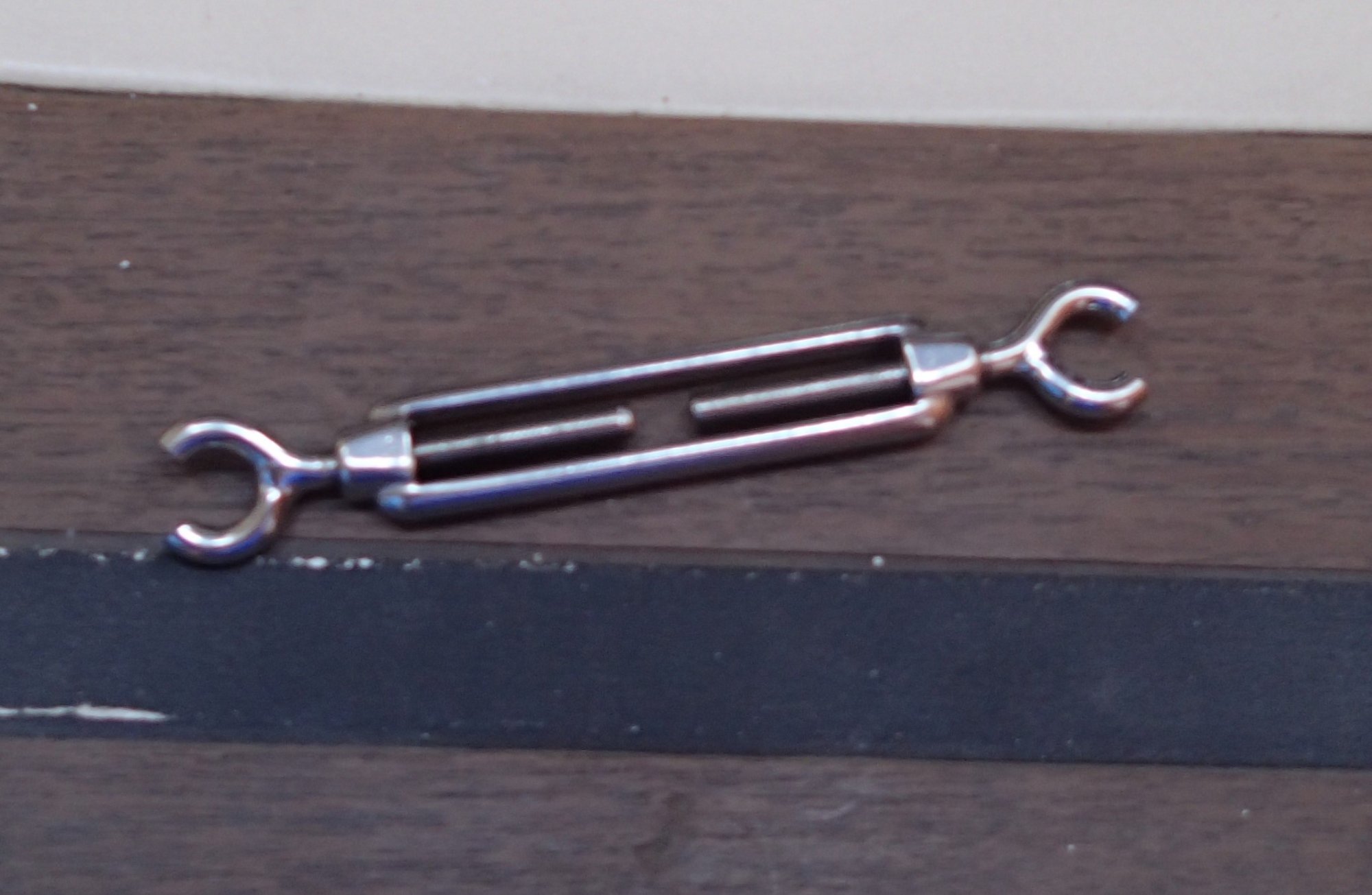

Belt tension can be adjusted single-handed with this turnbuckle. Use a suitable length ones and expand it between Alternator pulley and crankshaft pulley to tension belt.
Ken Y
How veeeeeeeeeeeeeery nice indeed. I thought I was keeping my head above water by using a piece of 1-1/4 X 1/4" alum. flat bar to pry in the curved guide. No damage with soft alum.
This is so much simpler and effective.

Thanks for the suggestions. Going to order a turnbuckle that is the right size for our set-up and check for cracks in the swing arm.
