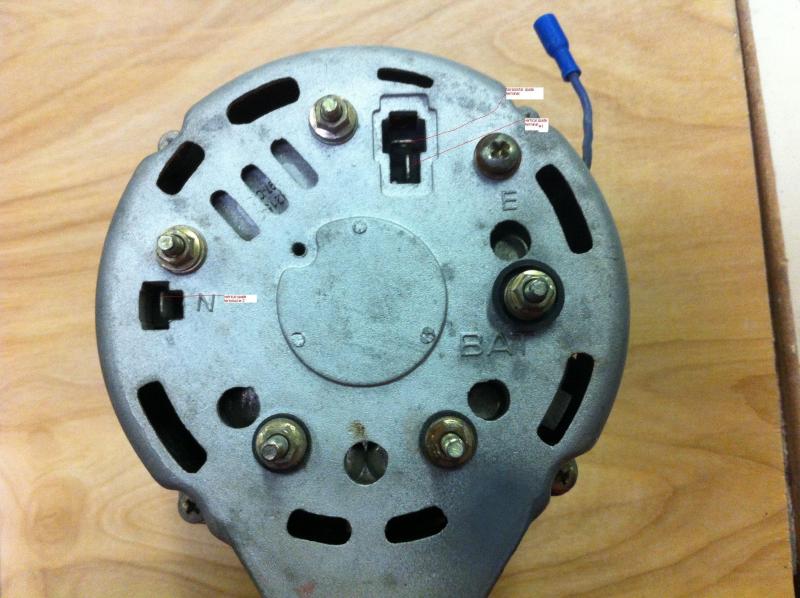

OK i have just installed my type c panel after building an engine harness to my 2gm20f in my 9.2a.....now for the brick wall part of this.....the positive terminal is for the positive side of the starter/battery......the E terminal is for the negative side of the battery.....simple so far .....now there are also 3 spade connectors on the back....one on the upper left side marked N and running vertical ....there are 2 spade connectors on the upper right side running perpendicular to each other ...vertical on bottom and horizontal on top....with no markings ....so my question is what do they hook to......i have a pic at the bottom of the page.....any help would be appreciated....

field windings I would suspect. the field winding is an electromagnet whose strength is controlled by the regulator. this is electromagnet is spun by the motor to create voltage in stator windings.
Sep 30, 2010
130
hunter 33 Hunter Morehead city
The top one (-) is labeled R mostly not used sometimes exciter voltage
The lower one (I)is labeled L power to excite alt from alt indicator light

thanks for the feed back the both of you .....if the R is exciter voltage and you say its not used some times if i hook up R and I and have them reversed will it blow a diode in the alt or will it simply just not work correctly.....

I had one just like that on a 2gm. Had to go to an alternator shop to get the proper plug for it. Has been a while, but if memory serves, the wrong way, and it puts out a constant 16 volts. Check with an alternator shop. I just don't remember which way it goes. The original Hitachi on mine had that same plug, but had a little metal box, with only one wire coming out of it.
that is the same thing the alt guy said...if they were reversed it would not be able to tell how much voltage it was putting out and would deliver all it had ....connected in the right order would let it do its job .....

Wish I could remember exactly how that thing wires up, but slept too many nites since then. But do remember when figured out it was pretty simple to do. My alternator guy had a plug for it.

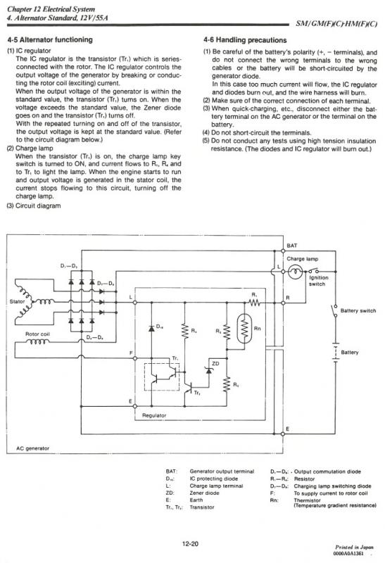

10,216
on the Hitachis, the topmost horizontal one is the "R" terminal which goes to the ignition switch for +12V when the switch is on. The vertical one just below it is the "L" terminal to the charge lamp. The N is probably tachometer output and if you are using the original "tooth counter" tachometer, you can leave it blank.
EDIT: Hope this helps:

I think kloudie is dead on. And if memory serves, you have to use the charge light for it to work. But don't bet the farm on that part.
thanks Kloudie...i have the fly wheel sensor for my tach and intend to use it..... when the yanny tach craps out i will replace it with a wema tach... they will hook up to the sensor or the alt and can be calibrated to with in 3 rpms of correct...and the cool part is they are around $85.00.....hooking it up to the fly wheel sensor would be more accurate that the alt because the belt will loosen up over time and go out of calibration....
