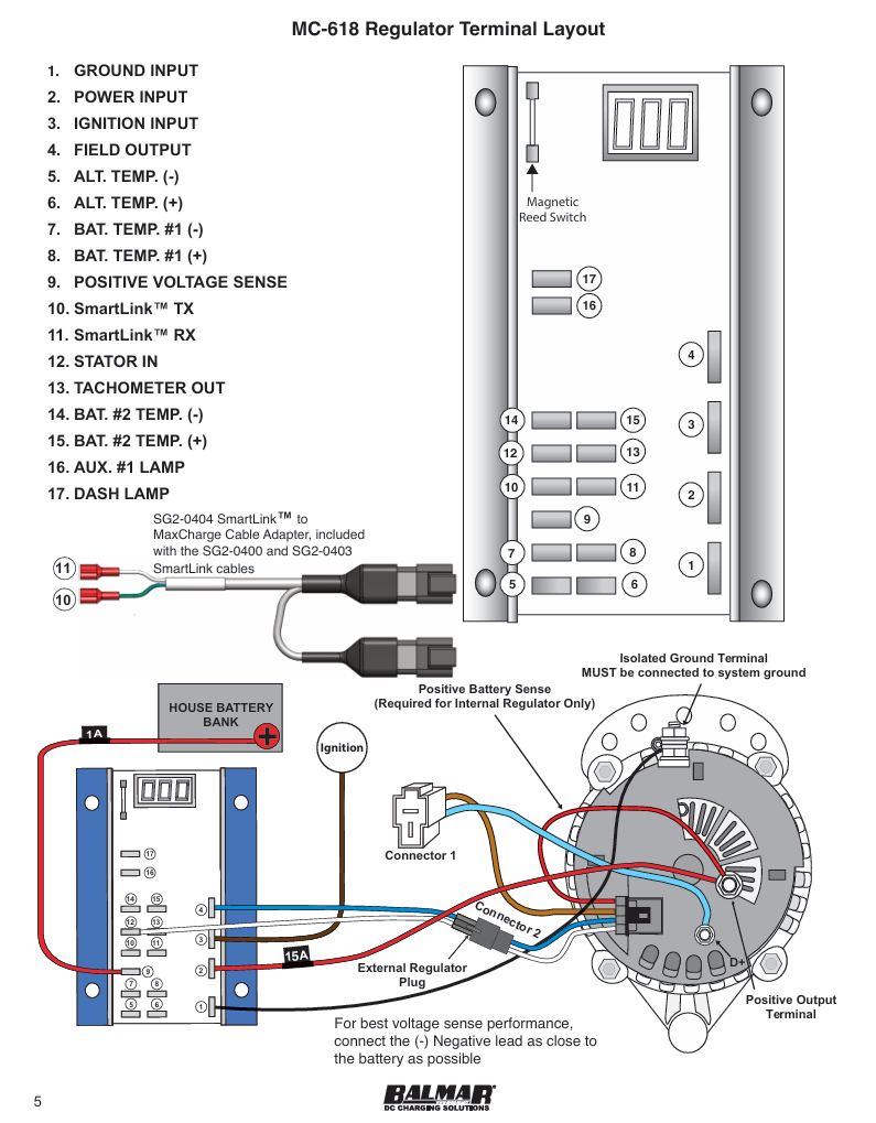

The reg should not be active when engine ignition is off.. Make sure brown reg wire does not have 12V on it..

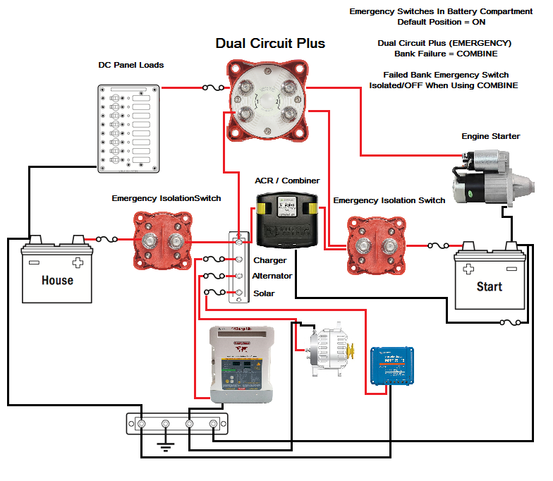

How is the alternator disconnect switch wired?

So, the brown wire should be connected only to the keyed side of the ignition switch?
Scott the manual for the MC-618 page 6 (identical to the MC-614 install instructions) states:
“Install BROWN Ignition Wire
The BROWN Ignition Wire #3 in diagram at right provides ON/OFF voltage for the regulator. This wire is included in the Ford-style plug at the regulator end of the wiring harness. The other end of the wire is fitted with a butt connector. Typically, the ignition wire is connected to the ON side of the ignition switch. This may be at the actual switch, or to a wire in the existing engine wiring loom that delivers switched voltage from the ignition switch. In some cases, an oil pressure switch may be used to activate the regulator. In either case, the regulator’s ignition wire must see zero volts when the engine ignition is switched off.”
As Mainesail has posted above:
Yes, even if the ignition wire is connected to an always "on" wire in the loom, I don't understand why there would be heat when charger is on.
The alternator disconnect switch is between the cable from the alternator and a cable to the 4-post buss. I believe the cables are 2 AWG and the fuse at the buss is 150 amp. The buss is "ON" as long as the HOUSE isolation switch is "ON". The buss has 4 posts, which also include cables to the HOUSE iso switch, ACR, and the AC charger. The HOUSE Bank is connected directly to the HOUSE iso switch on the power in side. The load side of the switch feeds the buss and the HOUSE side of the DCP on my panel.
Perhaps the alternator reacts because it has 12v supply from the common buss and 12v also hot from the ignition wire (which means the blue field wire sees voltage). I recall performing the tests and did not find any issues at the time of installation. In Test 2 the blue field wire sees voltage when the ignition input is hot but 0 volts when ignition input is 0 volts. I do recall the terminals are so tiny it is very difficult to make the multimeter leads connect during the tests. Perhaps I was reading 0 volts on the ignition input when actually it was hot during Test 1. I may not have discovered this issue while testing the installation. It's always very difficult to perform these tasks when lying on my back in tight quarters, without any room to get a good view of the multimeter while at the same time trying to fumble with the leads.
My diagram looks like this except I don't have solar, my cable goes directly from the HOUSE iso switch to the DCP switch, and I have alternator disconnect between the buss and the alternator.
Would that cause heat? I did the tests after installing the wiring and I believe I verified each condition for both tests (ignition on and ignition off). But perhaps I wasn't making connection during the first test as explained above. Will 12v power from 2 sources - charger thru the buss and field wire through the ignition cause this heat?
In any case, I will be checking the brown wire connection when I get back to the boat.
Is this a condition that may cause damage? I haven't noticed any problems with the alternator or the regulator. I do get curious OVER VOLTAGE messages on the Balmar monitor occasionally when I get back to the boat and I haven't figured out the reason. Perhaps this is connected. My batteries haven't been affected as far as I can tell.

Maybe, as a trial, rewire the regulator as per the manual and then again try charging from your shore power charger after depleting your batteries SOC somewhat. See if the alternator warms up or heats up. From my experience, I suggest it will not.

Not good at all for the reg as it just sits there pumping full field 24/7. The brown wire is what turns it on when you start the engine..

So I got back to the boat yesterday and found the brown ignition input wire connected with a male spade to a fitting similar to "Connector 1" as shown in the diagram below. The difference is that the connector appeared to originate at the starter in a wiring loom and it was very difficult to locate the same wires on the starter. I think that I simply duplicated the wiring method that the previous owner used, thinking that it would be a suitable connection.
I looked for an easy way to connect the wire to the "on" side of the ignition switch and found that it would not be a simple task - first to identify a suitable connection, and secondly, to physically make any wire connection in the restricted confines of the engine compartment. We wanted to go sailing so I looked for an easier solution.
Instead, I connected it to the oil pressure switch. It was a simple connection with a ring terminal at the face of the engine and the oil pressure switch was mentioned in the manual as an alternative. That worked fine, but I also noted that the regulator only activated when the engine was running, not when the start switch is "on". The manual also covers this condition. Currently, I can only adjust alternator settings with the engine running. I will eventually run a wire back to the brown wire from the control panel wiring. I think that will be the easiest way to make a connection so that the regulator is activated with ignition switch "on".
