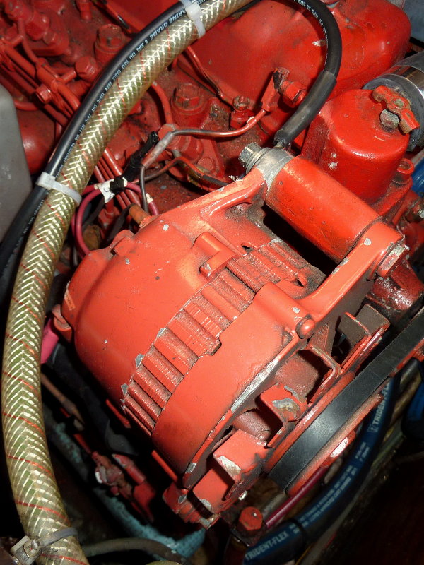

Rob,
The case of the alt is ground/neg so any clean spot will work fine. This engine suffered from severe voltage drop in both the positive and negative sides of the circuit with negative being the worst. I cleaned the alt mounting ear to bare clean aluminum then ran a 6GA wire direct to, and stacked on top of, the clean & new 2/0 Battery cable lug on the engine. After this change nearly 90% of the alternator current was flowing though the 6GA wire, not through the rusty block. Neg wire should be same size as positive.
