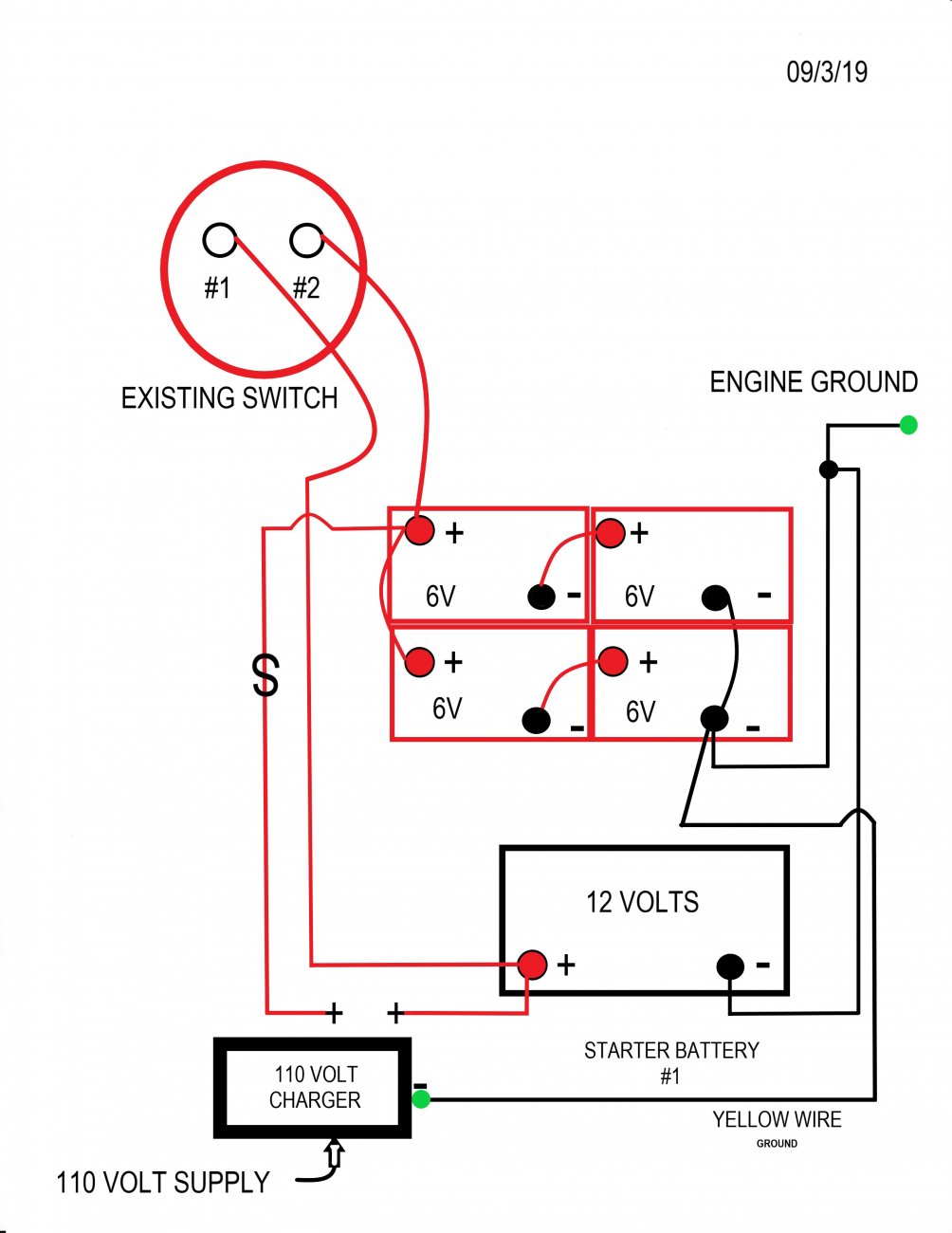

Found out that the alternator is a Motorola 51A
Cheers
2 Old Pirates
PS. Here is a new diagram, input is appreciated.

How were you thinking of wiring the alternator? Also, your starter battery is really just a spare/backup, unless you were going to wire it directly to the starter. Nothing wrong with what you propose, just clarifying.

In your diagram, you need a fuse between the charger and starter battery and between the house bank and battery switch. All fuses must be within 7" of the battery.
You might want to consider connecting your charger to just you house bank. Then wire a Blue Sea ACR between the house bank and starter bank. This allows for more efficient charging as the house bank is usually drawn down lower than the reserve/starter battery.
You also might consider a positive bus bar and bring both the charger and alternator wiring as well as the ACR to the positive bus bar. This will reduce the number of connections on the battery post.

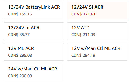

Checked out what both Marchem and Ward have said and came up with this. Which one?
Cheers
2 Old Pirates
PS. I noticed on JK's diagram he used a Blue Sea 7610 in his setup which look very similar to what I want to do.
