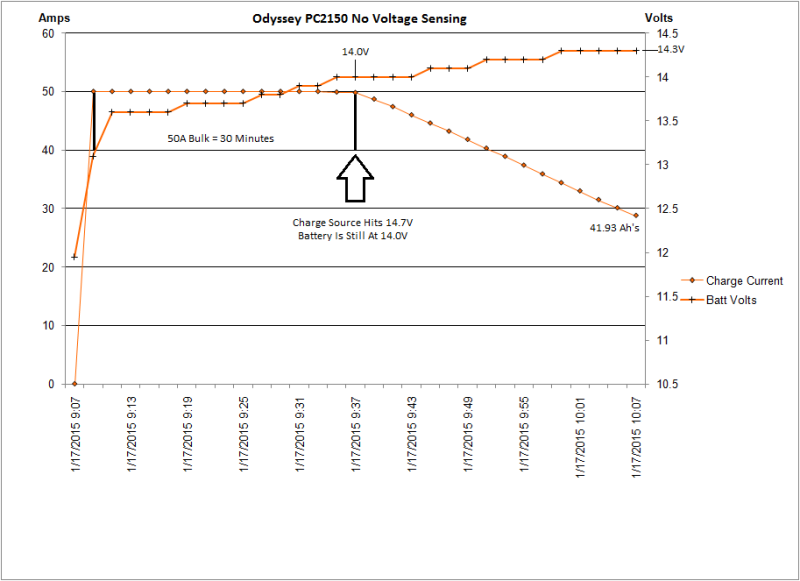

Last Friday, Saturday and Sunday I was working on a Sabre with a factory Westerbeke alternator. It had 1.3V of drop at just 30A of charge output (.8V in the negative side alone). That means the alternator was at 14.4V and in absorption (limiting voltage) while the batteries were at 13.1V. In this scenario current can only go down because the alternator is now limiting the voltage. This owner had been through a bank of batteries every two years. He now has a .2V drop at 46A which is about the max his alt will produce. Is this "ideal", no, but it fits his budget and will get him significantly better battery life. It makes him happy and that is what matters..
The way we use batteries on sailboats means we want to get as much energy back into the batteries in the shortest time possible. The owner above is adamant about not running the engine more than 1 hour per day. This is why his batteries were dead in two years. If you are losing .4V (3%) then you will dig into your fast charging performance and the regulator will enter absorption mode before the batteries do. If you have a remote sensing regulator wired properly then I'd still suggest aiming for 3% max on the alt circuit for the best charging performance.
These are the types of performance differences I am talking about with voltage drop issues.
No direct battery voltage sensing and a .7V drop at 50A (not at all unusual as installed)
Points to Ponder:
  • In 1 hour of charging, at a .5C charge rate, the battery voltage never exceeded 14.3V.
  • At just 14.0V, measured at the battery terminal's, the charger began limiting voltage. When measured at the charger end, it was seeing 14.7V and it began holding the voltage steady. This is what forces current to decline.
  • Once the voltage is held steady current tapers off and charging speed reductions are happening.
  • Maximum bulk time was limited to 30 minutes at 50A, due to the voltage drop. This resulted in just 41.93 Ah's delivered to the battery in the 1 hour recharge period.

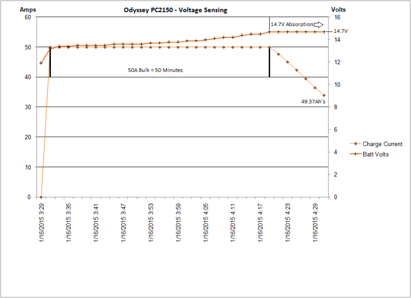

With Voltage Sensing:
Voltage sensed directly at the battery terminals and wires sized for minimal voltage drop. 1 Hour recharge at 50% of Ah capacity.
It looks a little different with good voltage sensing..
  • In 1 hour the charge source delivered 49.37 Ah's to the battery. This is an improvement of 7.44 Ah's in just a short 1 hour charge cycle. This equates to a percentage increase in charge performance of approx 17.7%, just by moving two small wires and essentially eliminating voltage drop in the charging circuit..
  • Bulk charge at 50A increased by 20 minutes to a full 50 minutes of bulk charging. This was a 100Ah battery charged at 50A for just 1 hour.
  • The battery actually attained the absorption voltage set point of 14.7V. This is healthier for the battery than stopping at 14.3V. It can help limit some of the effects of sulfation, even in a short 1 hour recharge. The effects of attaining your regulation voltage at the terminals, for a long enough duration, will have a direct impact on the longevity of the batteries.
  • In the previous test, with no voltage sensing, that battery would suffer performance issues considerably faster due to never even attaining the 14.7V target with daily 1 hour recharges.
It all boils down to what you are happy with. I like to see customers get their money's worth and I don't like to see short lived starter motors or battery banks when by making a few small tweaks we can certainly improve both situations.
