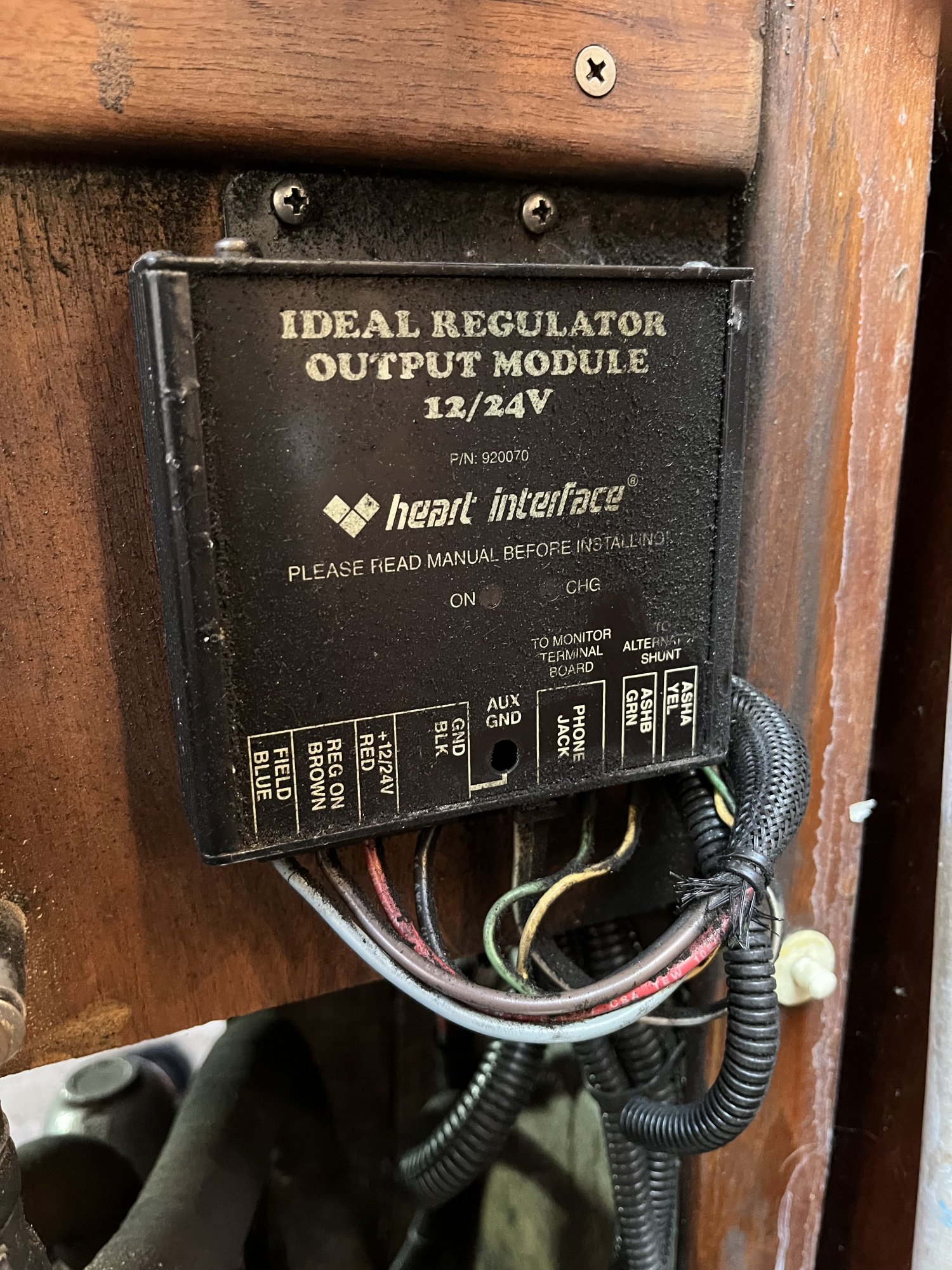

When I swapped out the heart inverter for the xantrax, there was only a single cable for the xantrax remote yet the heart one has that cable but also has other wires going out to what looks like a circuit board and then off in behind the bulkheads presumably to the engine or? The other confusing thing is this

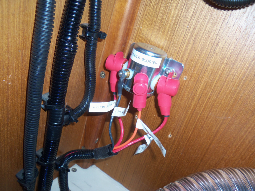

IMG_1144.jpegI'm trying to figure out if this is redundant now. Is this independent of the heart inverter/charger that was removed?

That is a voltage regulator. It manages the output of the alternator to charge the batteries. It may or may not have any integration with the old inverter/charger. I doubt it, but I didn't research it very deeply. That module is pretty old and a manual for same was not immediately available on the interwebs.
You can swap out the alternator and regulator module for a Balmar 80 amp alternator and Balmar 614 or 618 voltage regulator. If everything is working you have time to research the alternatives. Do you know if your alternator is charging the batteries?

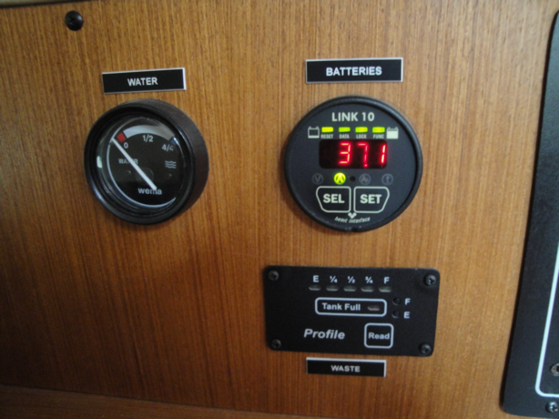

............... 37.1A to the same house bank at approx. 50% SOC during the bulk charge. I now had Amp-hours to spare for my house load and hours of motoring.
The "Ideal Regulator" which you show may be an alternator regulator but definitely not up to today's standards.

An LR 155 is internally regulated. That old regulator likely powered an alt that is no longer there…. A new Balmar alt & reg would be great..

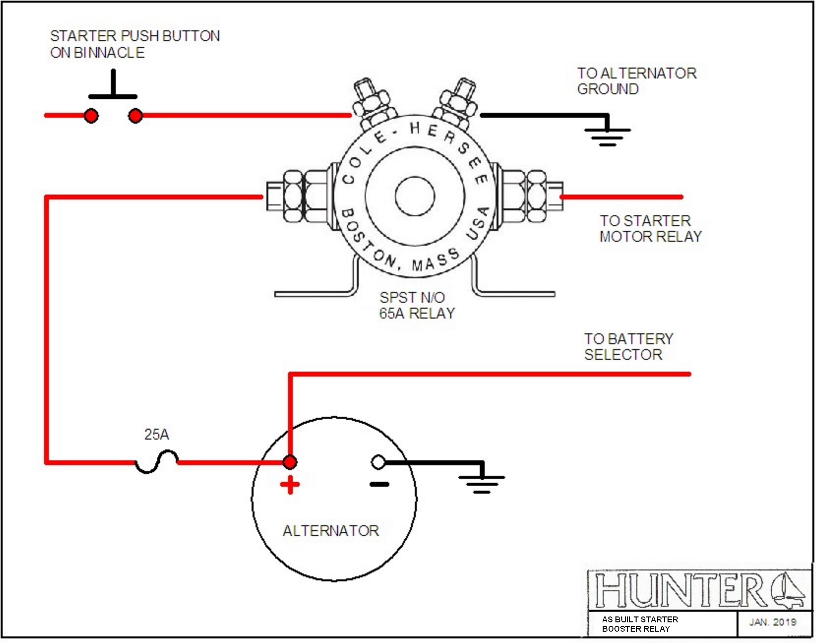

Before getting into a lot of cash outlay, try this with the starter relay. I too was plagued with starter problems. Thought maybe the starter, but previous owner had just replaced it already. Maybe start button, but again previous owner had replaced it twice. I insalled the relay as in the diagram above and have never had a start issue again. The relay costs about 20 bucks. Just my take on the situation.

I by-passed the original start wire in the harness with a separate No.10 wire and that solved the problem. You have probably purchased a new start button already. Even though it did not help, do not throw it away. Put appropriate quick disconnect crimp connections on the short leads and use it as a remote start button at your motor when needed. I would not leave it in place, just plug it in near the starter solenoid when needed.

like somebody else said, this is a common Hunter/Yanmar issue of them using the undersized tractor harness in a Marine environment. see this Youtube video for How I fixed it. I have been running this cheap fix for 2 seasons now and it has never let me down.
