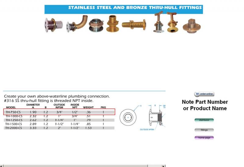

I've replaced all my above water line thru-hull fittings with SS ones for appearance sake.
Defender puts out a nice one as shown below. It has a hose fitting on the end.
Groco also puts out an interesting one in that it terminates in a female tapered pipe thread if you're in a cramped location and need an immediate 90 turn.
