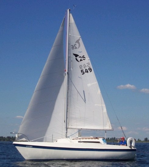

We cruised a Niagara 26 for a decade. Fast and easy to sail. High quality design and build from Hinterhoeler Yachts. I raced it for two seasons and won almost every start, albeit with a really good crew. :)
And it draws 4 feet. :)
Likes: LloydB
