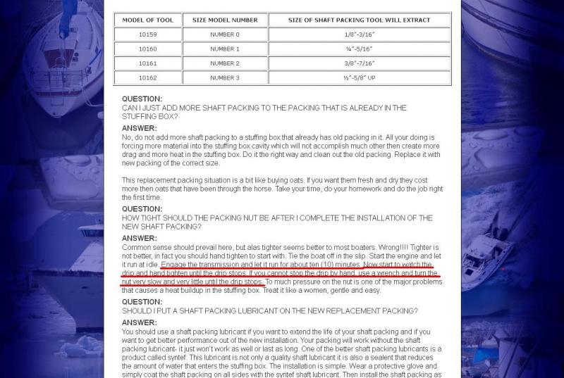

........................ the boating community comes to the realization that conventional stuffing boxes on slow moving sailboats DO NOT need to leak in this modern age of teflon. Our bilge is bone dry and it's used to store the toilet paper. I vacuum out the dust every spring as part of the annual housecleaning.
Maybe I'm a little cheaper than others here in that I'm using teflon-impregnated flax for my drip-free, dripless, no- drip, or whatever you want to call it type packing. I just replaced it last fall after three years of bone dry running and this time I'm going for a personal best of, count them now ................. five years running without a drip. Using some of the more exotic packing materials like GFO or Gore would probably give even longer service.
This is a note which I posted here a few months back on running your stuffing box BONE DRY:
http://forums.sbo.sailboatowners.com/showthread.php?p=872589&highlight
Additionally, I recently noticed that Western Pacific Trading (suppliers of teflon impregnated packing) also recommends that the packing be JUST tightened (and no more) until it no longer leaks while the shaft is turning. Yes, while the shaft is turning. And for sure it won't be leaking when it's not turning.
http://www.wptinc.net/wpt_tech.html#wptc
I see that most manufacturers of packing materials continue to blanket themselves in all-encompassing dire warnings to absolutely, positively, and most definitely ensure that the gland leaks at least 2 - 3 drops per minute. It's the only was they can ensure that boaters don't overtighten the gland nut. I mean, c'mon, this is a big nut and needs lots of manly torque to properly tighten it up, right ? Wrong ! No, they don't need to leak but it's the only way they can keep people from overtightening them until they burn, scorch, score, carbonize and quite possibly worse.
Now please understand, a leaking packing gland is strictly a personal preference. If it leaks, one is perpetually dealing with a wet, stinking, bilge and its effect on the surrounding cabin space. On the other hand, choosing to go with a dry packing gland, you're stuck with vacuuming the dust out of the bilge with every spring housecleaning but no musty smell in the cabin :stirthepot:.
