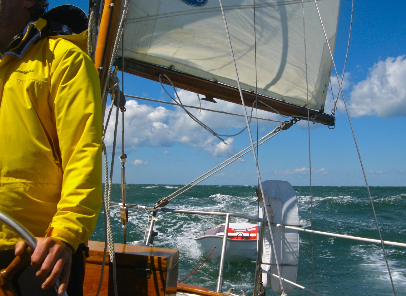

Stronger painter, good solution, with a hard dinghy. We tow everywhere, even overnight, so we need a foolproof attachment.
Our painter is a 20' 1/2" braided nylon dockline that has the loop spliced into the tow end. The loop end comes aboard and gets cleated whatever length we need to keep the dinghy planing. Then we throw the loop over a cleat or a winch. At anchor, we just throw the loop over a winch. You can't loose the tow from the tow boat with that loop over something.
The attachment to the dinghy is through a hole in bow transom and tied with a bowline through another hole in the forward laminated frame. You can't loose the dinghy attachment, even if the dinghy disintegrates.
We've only lost the dinghy once with this system because I looped a similar looking dog leash loop, over a winch. :)
