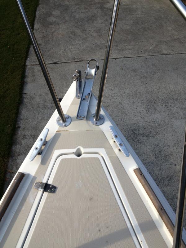

Ust about finished. Still need to troubleshoot trailer lights

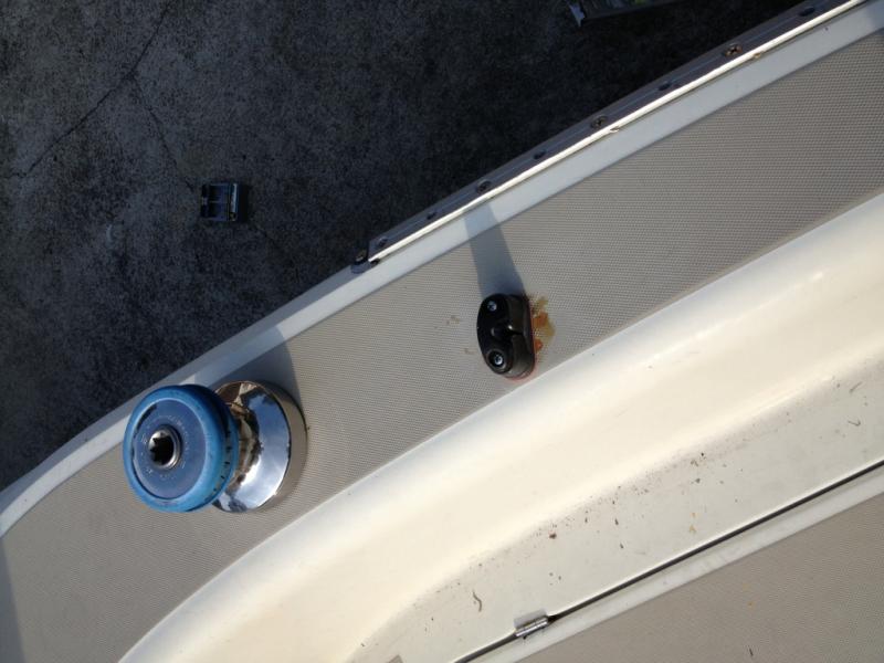

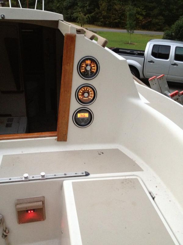

Installed new and reinforced batteries and water tank, reinforced and new installation of stern and motor mount, compost toilet, powered vent, new trex instead of teak, new through hulls, reinstalled and reinforced bow cleats and roller, new instruments, cockpit light and cabin light, , trimmed sliding hatch with the old toerails to hide the overhead cabin light wire, and for looks. Also not shown new stern rail grill. Also fixed a leaky chainplate and rear cleat. Reinstalled and reinforced the anchor locker hatch. Buffed and waxed the hull, whew! Gotta do bottom paint next week.

Nice job I like the color of the non-skids. What color is that? If you get anxious to go and are still having difficulty with the lights, Harbor Frieght has some towing lights that attach magnetcially and are prewired. Just Zip tie the lights and the wire to the frame and go. They are only about $10 at the store. They show $15 online.

Really nice work and I know it was a lot of work!
Love the anchor roller, new toilet, handrails and motor mount, actually I love it all.
Congrats.....

Whew, lots of work, nice job on all of it. What kind of nav lights do you have on the bow?

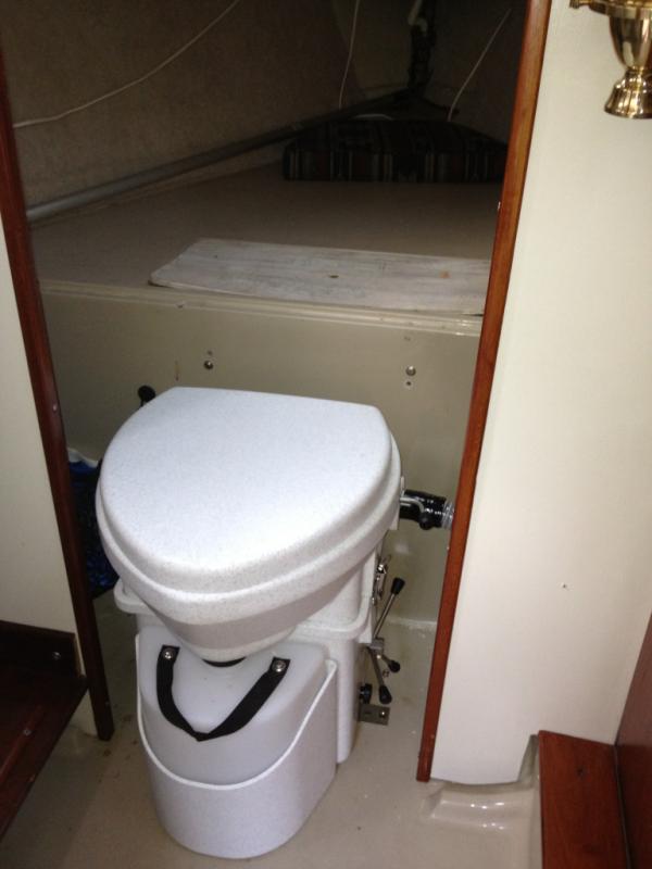

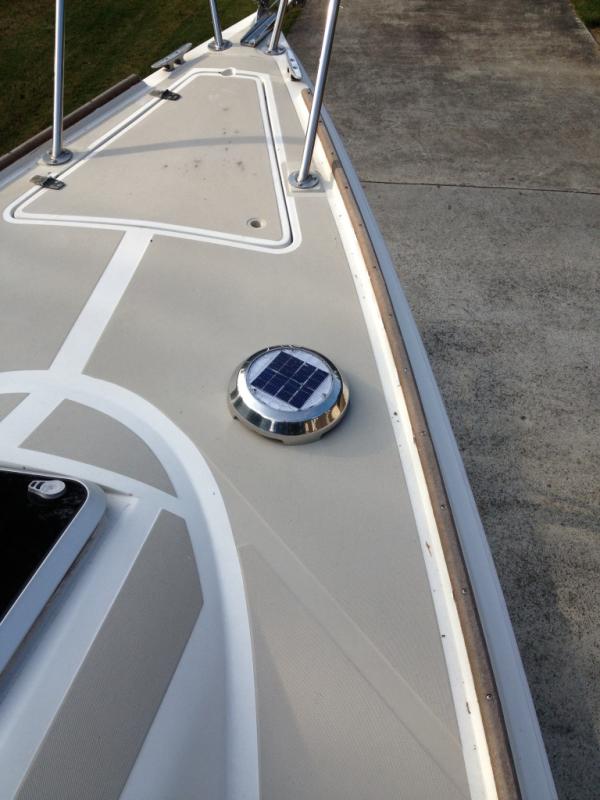

But why did you put the solar vent in a high traffic area?
I THINK thats the vent for his compost toilet. The toilet needs to be positively vented 24x7, and the hose run should be as short as possible to minimize pressure loss.

Great work Keith! It was fun, wasn't it? You're going to love the anchor roller believe me.

Boy Keith you have really been busy. As always the work was well thought out, with excellent craftmanship. Like the trex idea. Thanks for the great ideas and posts.

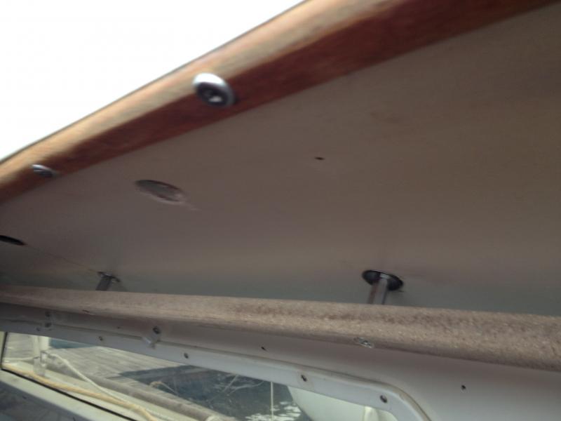

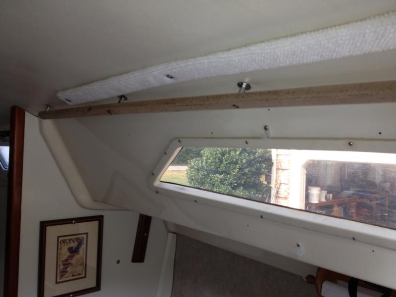

Nice job! Curious: What is that terrycloth material up by the handholds for? ...and what is that red light in the cockpit wall, under a handle?.....

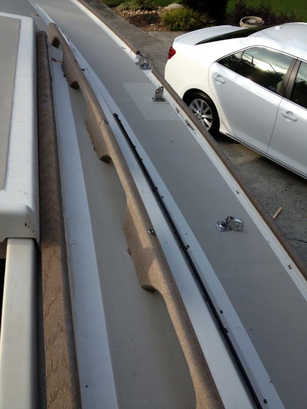

Trex as Handholds?
I can see Trex as toe-rail, but it looked as if you used it for your handrail as well. Did you, Or did you use some other HDPE product?
I used TREX while making a 'ladder' base for my outdoor train layout, and it tended to snap if subjected to any lateral force. (I.E. Bending) With the thinness of the handholds where you actually would hold it, I'd be concerned that it would not hold if you REALLY needed it.

My friend Wayne used HDPE for his handrails and companionway slider moldings. I think the Trex is a little stronger. The floor on my farmer's porch is all Trex. That stuff is pretty tough. I've been using Trex for certain things on my boat and PVC trim board for other things.
I like PVC trim board because you can glue it with PVC cement and it can be spray painted with Krylon. It's a lot lighter than Trex.

Ooops, forgot about this thread, Let me answer one question now, then other replies later.
Regarding the padded strips along the top just above the handrails: that is a cover my wife and I fashioned to cover the holes cut in the cabin liner. I had to drill these holes to get access to the bolts that we are using to attach the hatch rails.
Initially, I thought I would be able to drill straight down through the deck into the cabin and simply attach the hatch rail with machine screws. But, as almost anyone else would have known, the interior is curved and you cannot tighten down the bolts without bending the bolts. And because when you tighten the bolt it pulls it sideways it breaks the seal underneath the hatch rail. So it did not work. To eliminate the curve I had to drill out a 1 1/4 inch hole, using a spade bit, until I got to the inner surface of the deck. It was flat there. So then I was able to fasten the hatch rail using machine screws.
Regarding the choice of a cover, I initially used some small round covers I made but it looked patchwork. When I used the padded strip it, almost, looks intentional.
