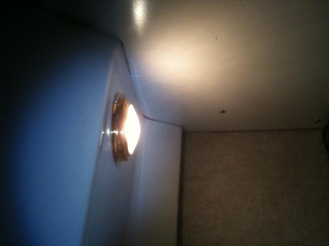

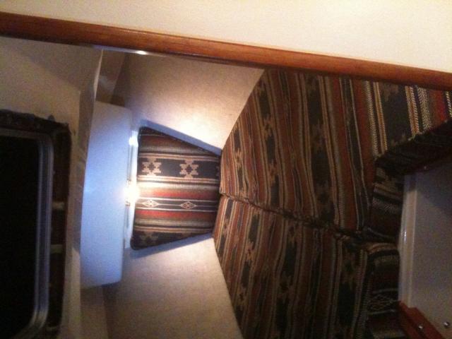

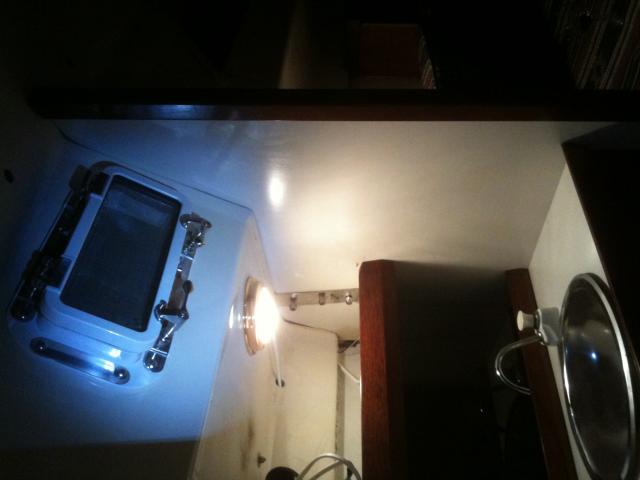

I wired a D.C circuit with four 10 watt lights in parallel. The first is in the bow of the v birth just aft of the cubby hole under the anchor locker (pictured), the second just forward of the forward bulkhead on the starboard in the v birth. the third over the forward sink the forth in the salon. Then i ran another circuit for the galley sink. I connected it (for test) to the battery and it worked!. I had nice warm lights.

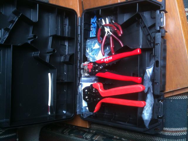

The wire was 16 G boat cable. Used marine grade connectors, with heat shrink tubing. Used ratched crimpers, but still had a bad crimp every now and then. :cussing: The self adjusting strippers were worth the 20 bucks. they strip the outer jacked, then you reinsert both wires and they strip the wire cover. Those tools are the ones pictured.
