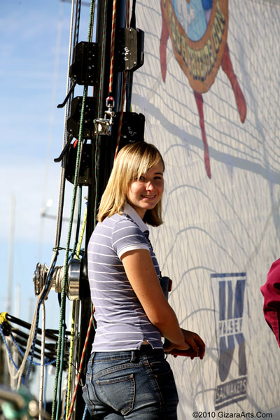

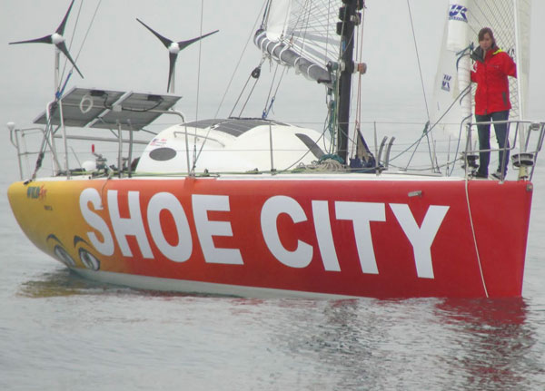

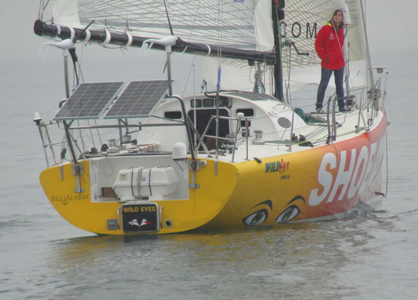

I have been mulling the idea of leading all the control lines back to the cockpit of my Allied Seabreeze , convinced , until now that it would make singlehandling her much easier ,but looking at Jessica Watsonn S&S, with sealed hard dodger and all winches and lines , still on the mast......I wonder ?
Has anyone led everything , back to the cockpit , and decided , afterwards , that the benefits were not that great afterall ?
With a dodger in place it would be MORE imperative to have lines directly back to the cockpit. I do not have a dodger. I did however runn my main halyard and slab reefing lines to the cockpit. Smartest, cheapest and fastest upgrade on my boat. I can reduce sail to the doulble reef position single handedly in about a minute! I have reference marks on both the halyard and reef line.Releasing the halyard from it's side in a double cam cleat, i pull the bitter end thru the cleat until positioned at the reference mark. Fall off and winch in the reef. viola!

All I know is when I see that photo on the home page, I cant even remember what the question was. Oh well..... What beautifull scenery! If I were able to get pictures like that on my deck, I would leave everything just where it is and wouldn't change a thing.
