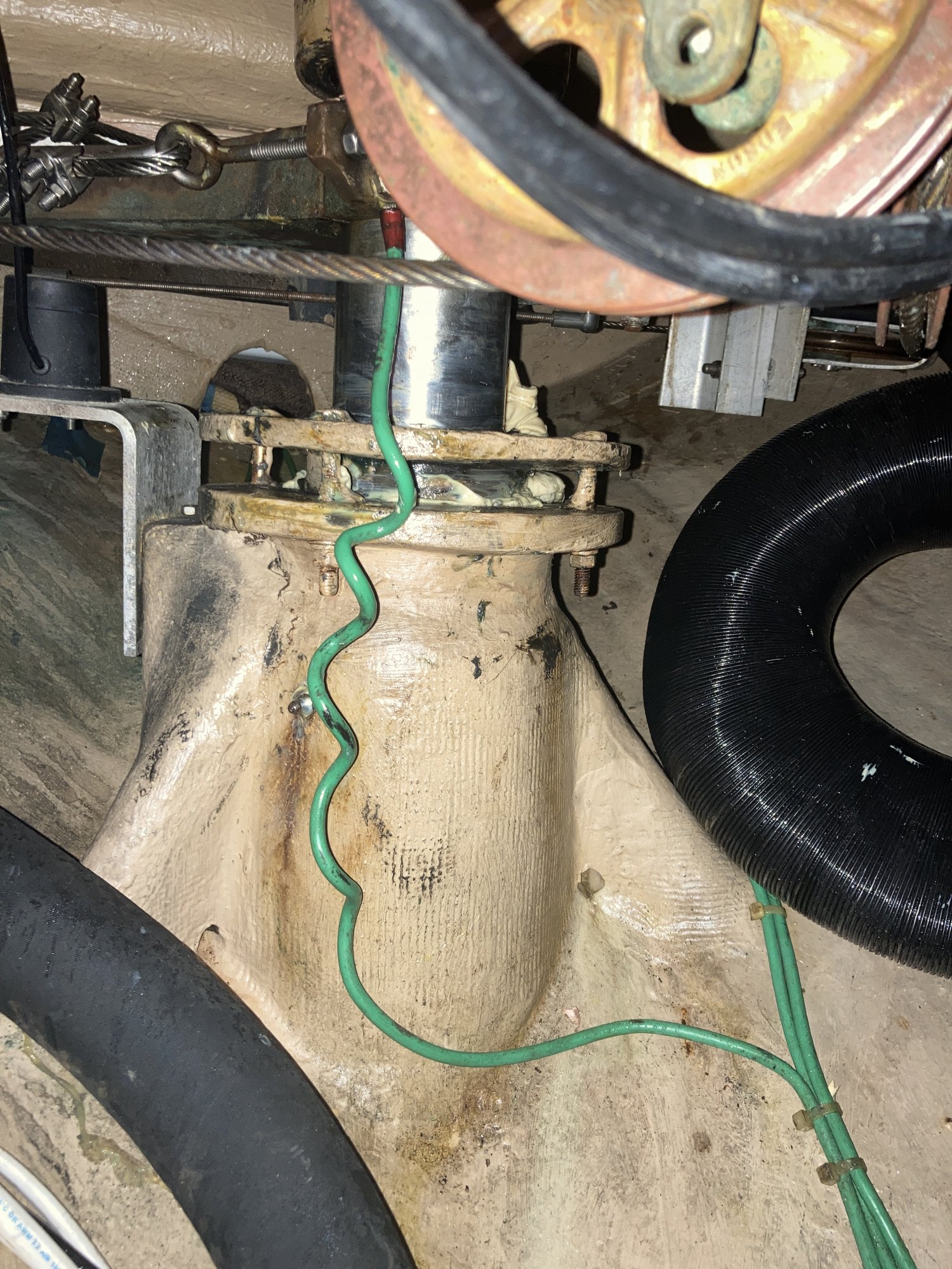

Hello! We have a 91' Alden 44 with water leaking while underway from the rudder post after some cold weather spurts. It doesn't appear to use the typical packing gland most rudders have. There is a grease nipple there which we filled with a grease we had on hand, but that doesn't seem to be the right grease, as it's happened again, perhaps it was too viscous? Does anyone know the correct type of grease we should be adding to the rudder post?

I can’t help with the grease, but maybe a photo of the post and where it is leaking would be helpful to help diagnose what is going on.

@alison.davey,
Does the top plate on that rudder tube compress packing ? If not, what is it‘s purpose?
it looks like it should be tightened down on packing to seal the rudder tube.
