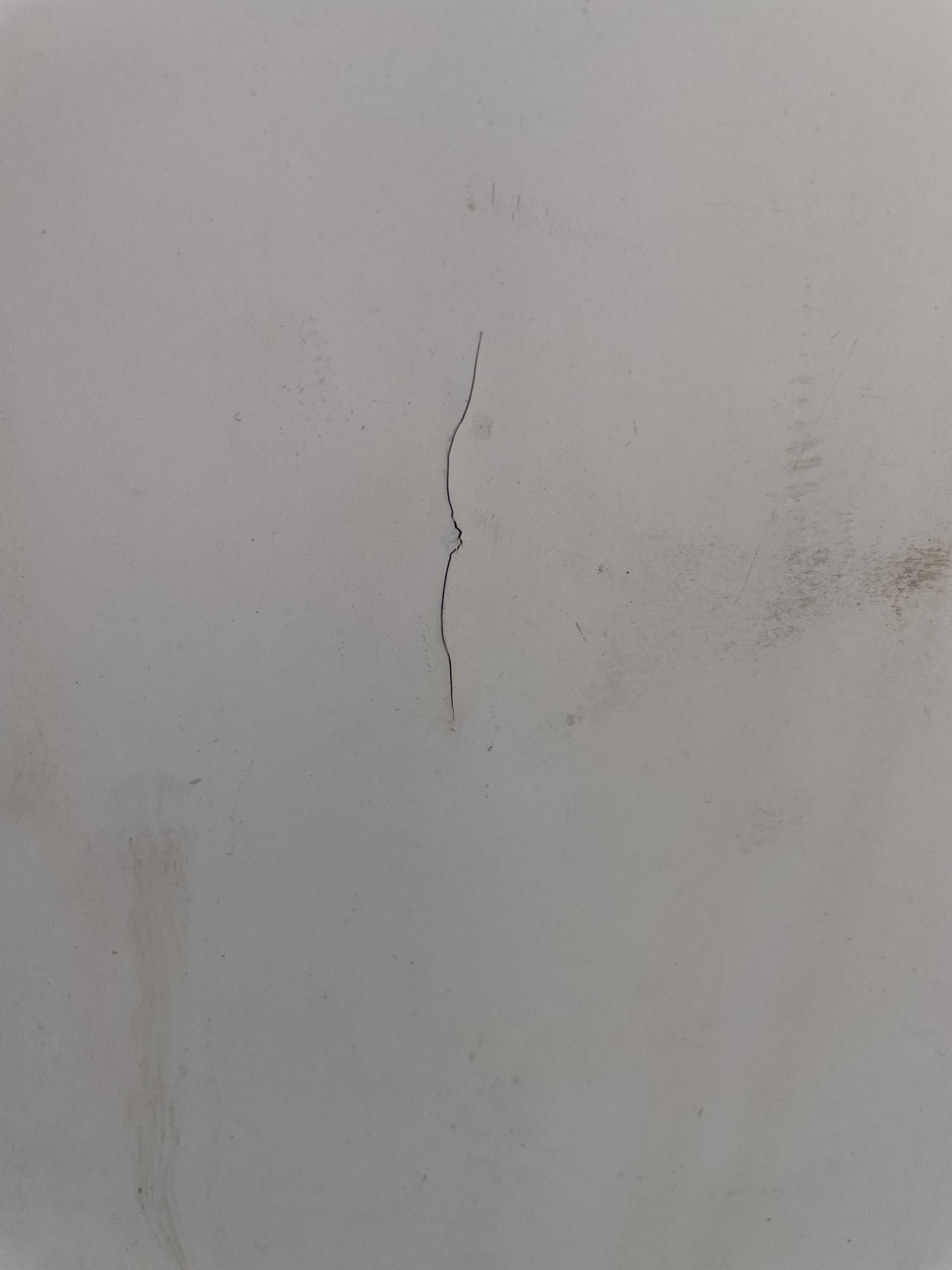

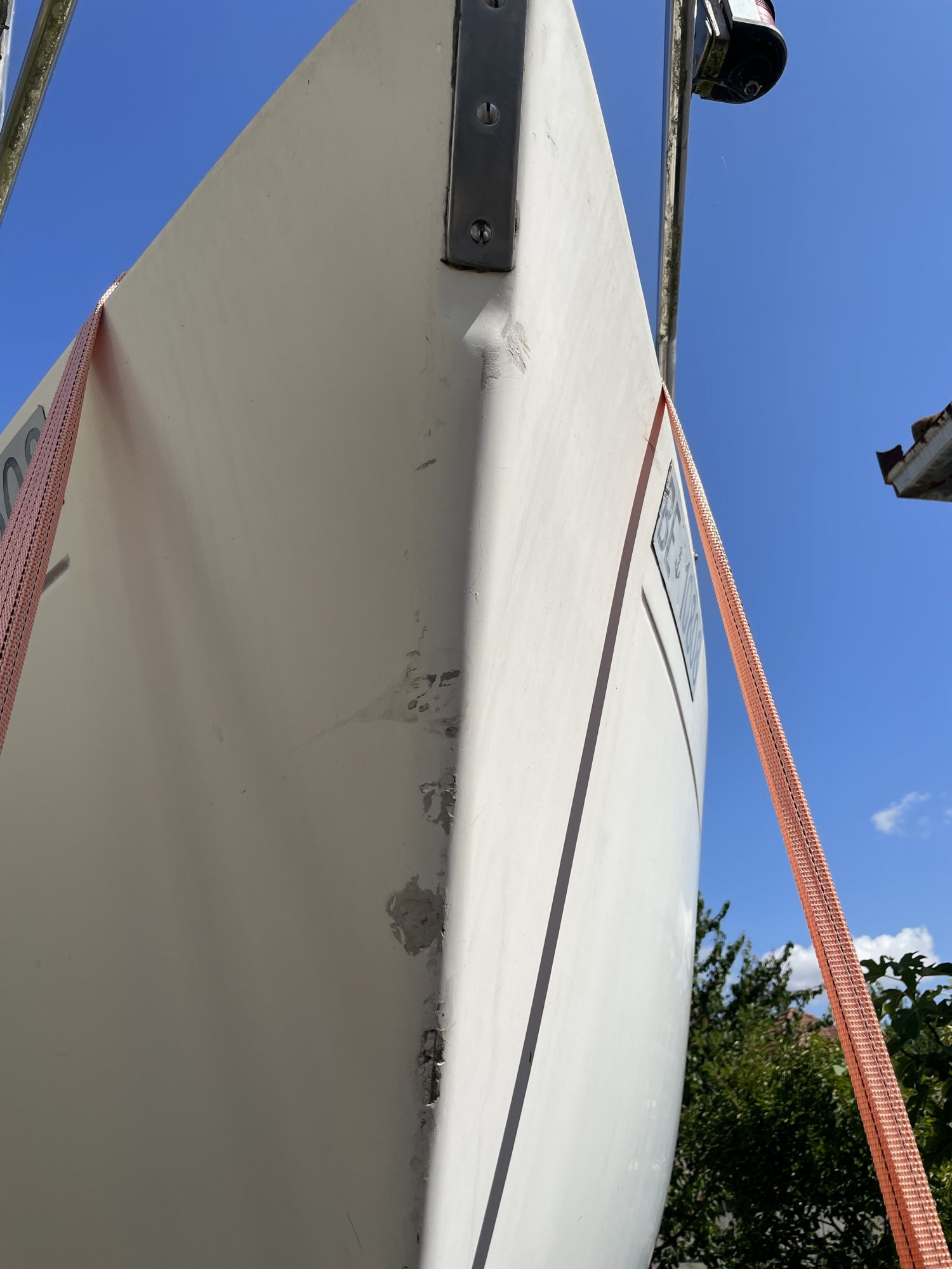

the boat is in a good shape. Its a 1977 and has been owned by the same guy since new. The biggest damage is seen in this picture. So my question would be how would you go about repairing this what would you use. there are some other scratches along a section of the starboard side but they are superficial and not a big deal at all. the only other place is a small crack on the transom.

The dings on the bow are normal wear. Cosmetic repairs caused by:
  • Coming in a little to fast to a Dock,
  • pulling up an anchor that bangs against the bow.
The transom damage is a bit more questionable. Could be something struck the transom in the middle and the crack has elongated over time. Check the inside of the transom for any damage. I would want to open up the crack and check for separation, along the crack, of the outer layer of fiberglass from the inner core.
The surface type of damage you report is not unusual for a boat that is 48 years old.

The problems with the bow are small. Filling the divots with something like MarineTex (white) would probably do the trick. Be careful with other epoxygoop products because they might look good initially but then UV degradation sets in and they turn into brown blotches. We ended up having to repaint our entire deck because we filled some dings with the wrong stuff.

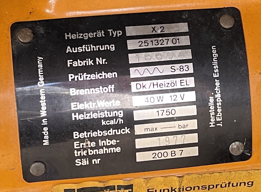

I forgotten to mention i have a airtronic heating onboard as well Eberspächer x2 cant fin the manual anywhere for it. its full functional and in good shape even for its age. On the net the consensus is that these old units were overbuilt and if you treat them right they will last forever. Can you guys maybe help with that as well?

While I could not find the X2 model in a search it would appear that the X2 is similar to the D2 model. You may have luck contacting the manufacturer. They may have the manuals archived. Perhaps a parts list.
I did find these potential sites
  1. Eberspächer Direct → Parts Finder, select “Airtronic D2”, and download the Spare Parts List. This will include exploded diagrams and part IDs — it may provide part information to your X 2 that are equivalent internal components.
  2. Butler Technik Technical Library, browse the Airtronic D2 section for workshop manuals and also spare parts info.
  3. Download the “Ersatzteilliste” (parts catalogue) for Airtronic D2 from ImPEK in Germany; the diagrams and model numbers may match the parts in your X2.

i did write to them and they didn't answer at all. And its also quite near my birth place, i was born in Böblingen and they are the next town over some 6 miles away. As far as the part list the unit is fully functional i would just like to have the manual i also speak german so its not a problem if it is a german version.

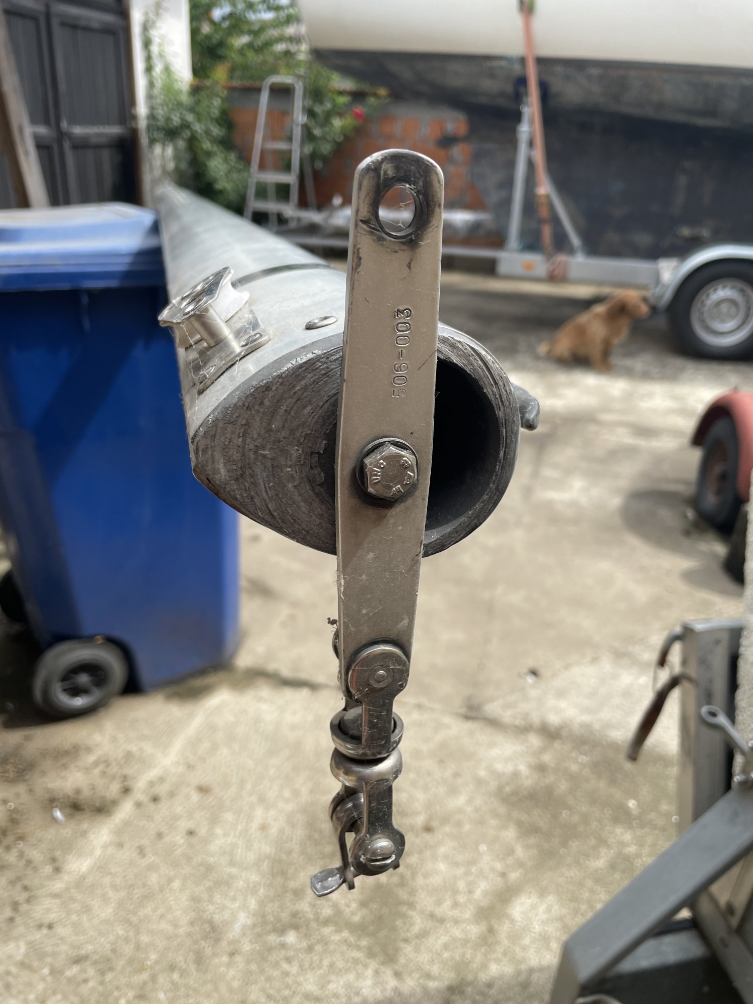

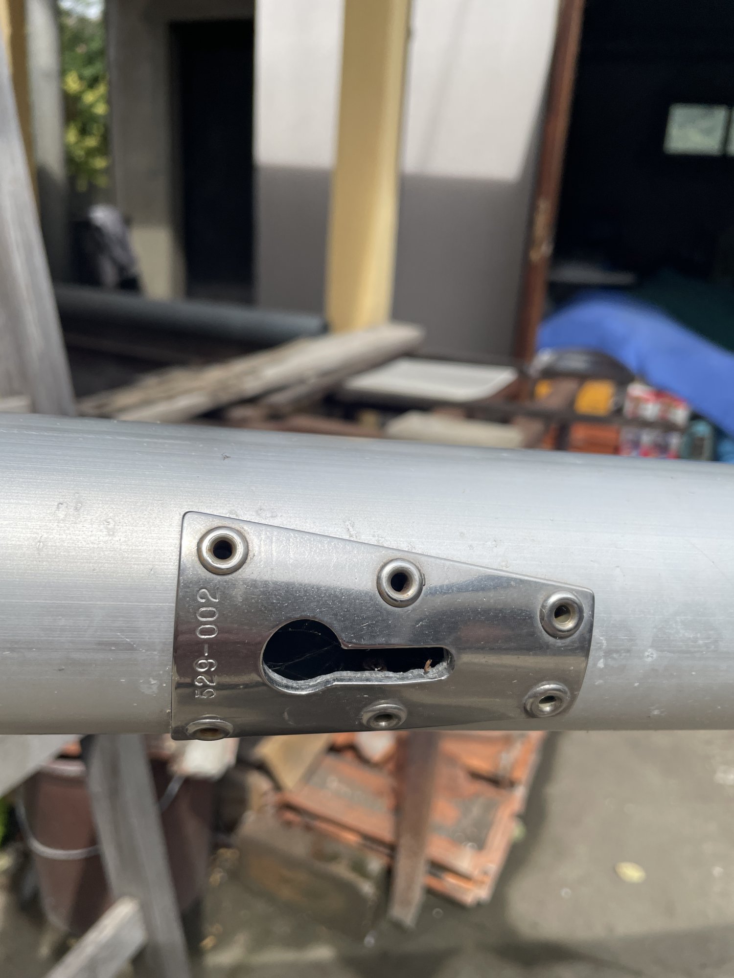

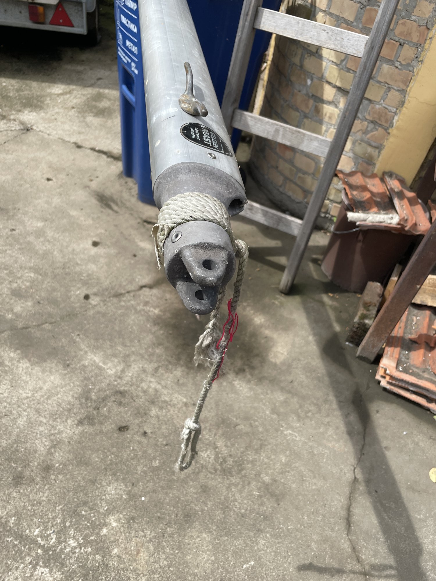

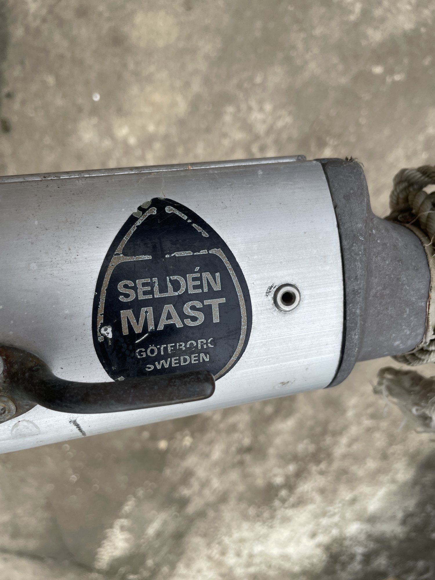

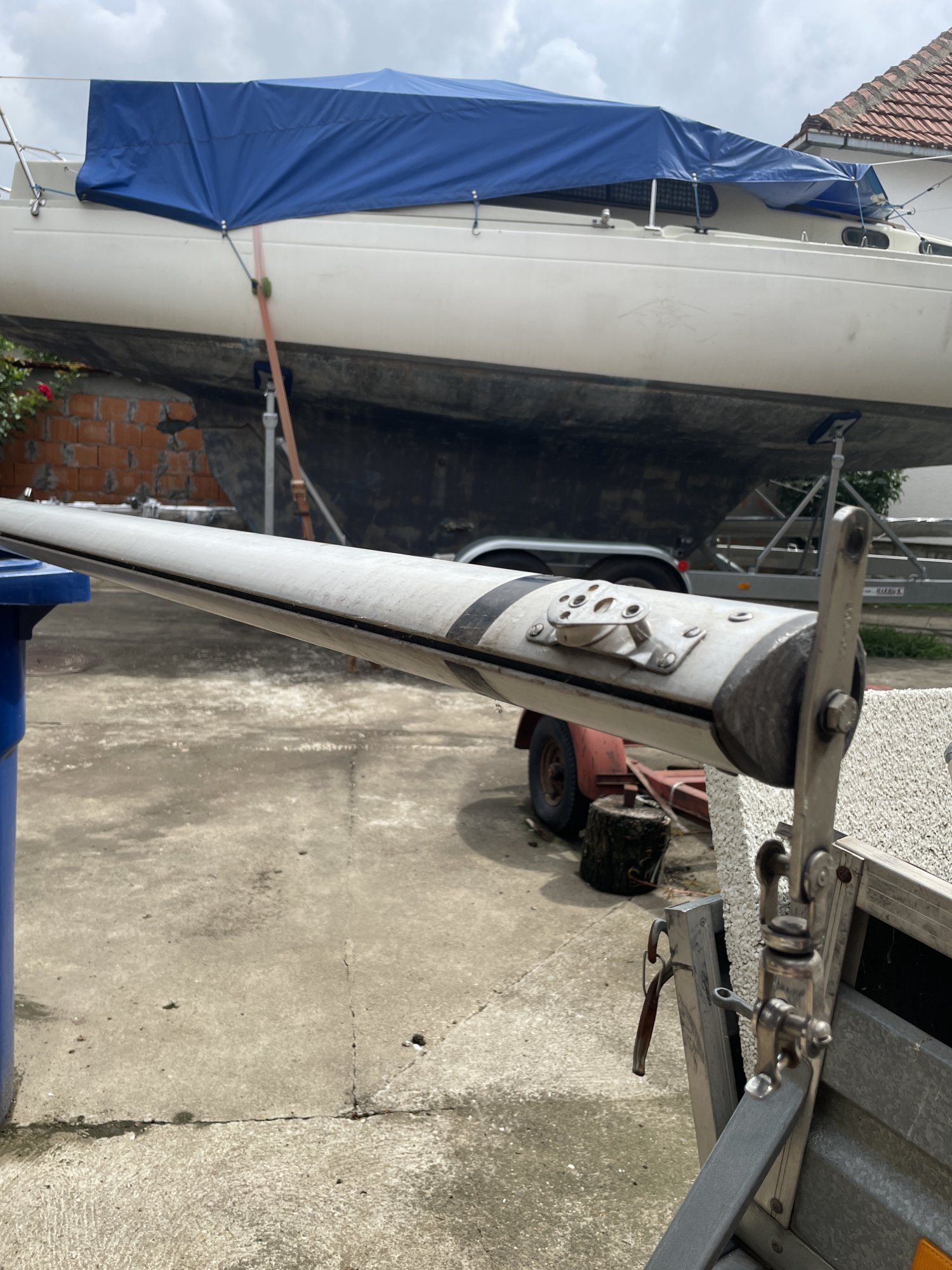

Did just that. Had about half of an hour but i got it out and back. Here are the pictures. Sry for the poor quality but i was in a hury.

Looking at your pictures I cant really tell where on the mast side the boom rotates. It may be under that rope. But I don't know. The other end with the flat bar is where you attach your main sheet, most likely on the bottom side with the swivels, and your topping lift attached to the top side where you have that single hole.
If your boom is rotating somewhere near that rope that's wrapped around then actually you don't have much of a problem furling your main sail w.r.t. boom angle to the mast. I'd have to see how your sail connects to the mast and the boom together to get a better idea.
Looks like a pretty nice set-up.

i was hoping to get a reference about the boom itself so i can look up documents. I know a little bit but its only theoretical and the shipyard did the laying down of the mast and everything else without me present (just the way it went) when they loaded her on to the trailer. My transporter could only do Sunday so they did the transport and crane and mast and everything else on Friday so i didn't see anything while it was still on the boat. But it is what it is
