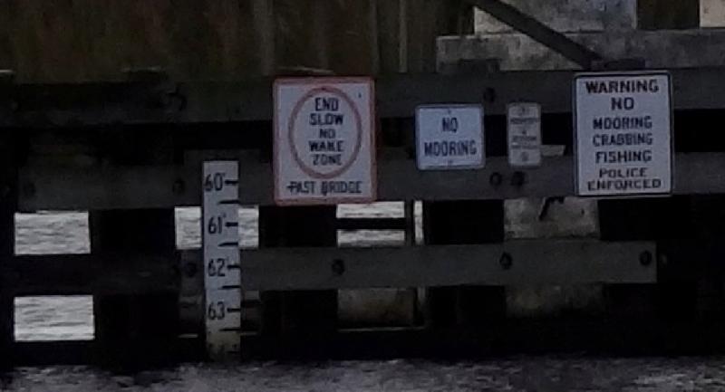

The problem with the Wilkerson (and also the Pungo Ferry) is that they can be substantially less than 64' in periods of wind driven high water. Conversely, when the water is low there's plenty of room. Here's a picture of the tide board of the Wilkerson last time I went through (64' mast clearance). My VHF whip is higher. My notes with the picture said that the amount of whip bend indicated 65'6" this day.
We now prefer to go around the Wilkerson via the Albemarle sound unless strong unfavorable winds are forecast. The distance is about the same, the bridge is high, and you typically get some really nice sailing time. The towns of Manteo and Ocracoke are two of our favorite stops on the ICW.

Thanks Carlf,
Reading the tide board in your picture, the water was low on the 65 meaning close to 66 feet? Or the same question if you see part of the 65, does this mean 65+ feet or does the whole number have to be showing? I draft 6'10" so this is the only route besides outside.

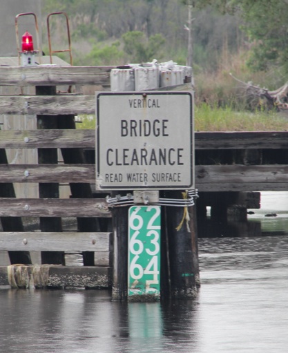

My "rule" is that when I see the whole 65 including the line under it if there is a line - then I have between 65' 0" to 65' 11" depending on how much margin for error the guy with the tape measure felt he needed the day he hung the board.
We've never seen a bridge that was tighter than this interpretation of the tide board but some 65' bridges seem to have a couple of feet extra room. And some bridges have no tide board at all.
And while the chart says Wilkerson is 64' and the Pungo Ferry is 65', I find Pungo Ferry tighter (the tide board seems accurate). Maybe it's sinking.

Here's a picture of Pungo Ferry at somewhat high water. We've seen it worse. Our VHF whip got a good cleaning but no mast hit. I think the tide board is accurate showing 64 and a couple of inches.
If your trig is as rusty as mine, here's a nifty calculator to figure out whether swinging the dingy out will help enough. 10 degrees get's you a foot.
