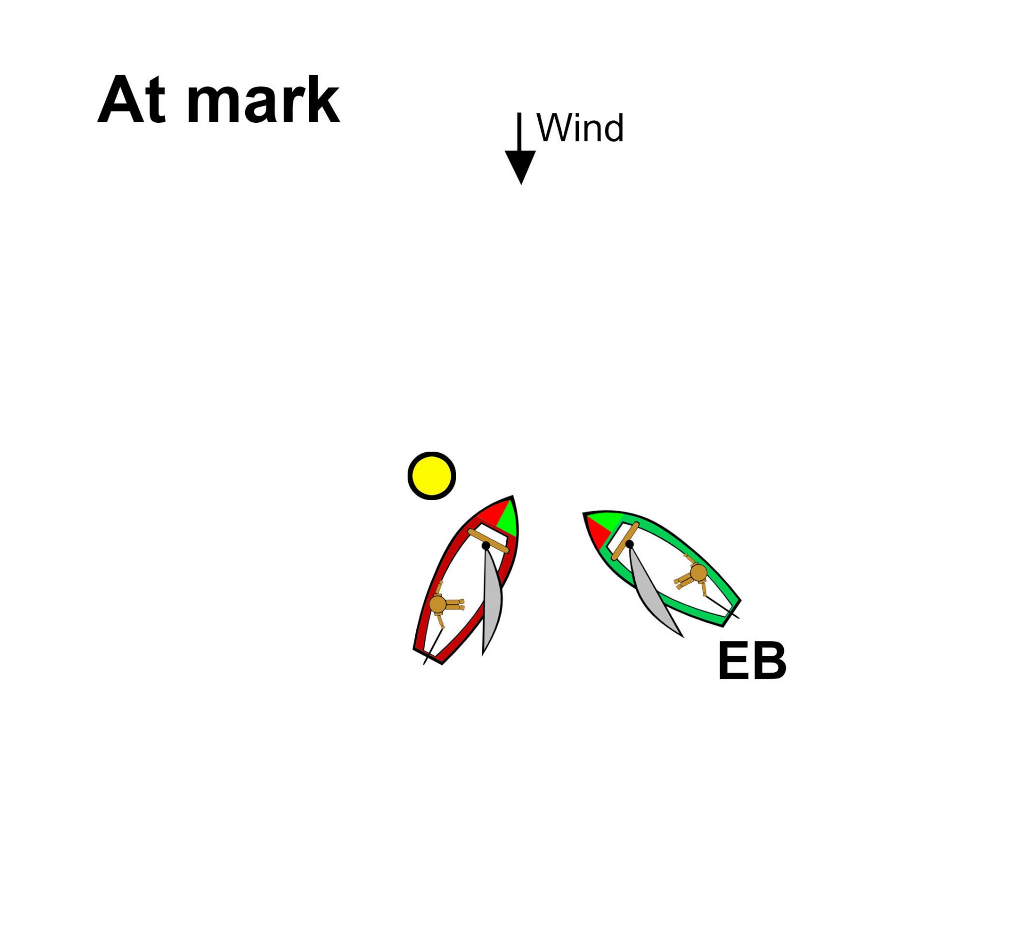

A situation developed in a recent race, and I am thinking it is the other skipper who is in the wrong.
OK, here we go.
In the second race yesterday, We (EB) were approaching the windward mark on a starboard tack. (see the first graphic "opposite tacks at mark developing") Another boat (name not known), after failing to make their lay line on a starboard tack, had to turn to a port tack as they approached the mark.
This created a situation where we would both be rounding the mark at the same time (not overlapping, as they were on an opposite tack). I called "starboard", expecting them to yield. Instead they attempted to round the mark directly in front of me (see the second graphic "opposite tacks at mark"). They were pretty much in the irons at that point, with only momentum moving them forward. I had to take evasive action to avoid a collision, so close that I had to fend us off by hand. By then they had lost directional control and velocity and drifted into the mark. Frankly, I'm hoping my push had something to do with that.
After getting in the way of another boat on a starboard tack, they did a penalty 360 and continued sailing.
At no point did they call for room at the mark.
As I see it, they were entirely in the wrong. As we were on a starboard tack and they a port, they were supposed to yield, yet it was I who had to make an evasive maneuver. Given the difference in boat angle, I'm not sure they could have claimed an overlap situation, which would be required before they could call for room at the mark.
I would love to hear your thoughts, especially if you think I did not react to the situation properly.

I've only raced a few times but I would think this scenario would fall under the "Rules of the Road". The boat on a port tack gives way to a boat on a starboard tack. I don't believe the down wind rule would apply here. So, with that, IMHO, I would give you the RoW. Let the discussions commence.
May 17, 2004
6,260
Since you were at a mark Rule 18.3 is the one most in play here - “If a boat in the zone of a mark to be left to port passes head to wind from port to starboard tack and is then fetching the mark, she shall not cause a boat that has been on starboard tack since entering the zone to sail above close-hauled to avoid contact…”. Since you say you had to fend off by hand I assume you were forced to sail above close hauled? If so I’d say they broke rule 18.3 and were right to do their turn.
Some other incidental thoughts based on the situation:
- Mark room does not apply between boats on opposite tacks on a beat to windward. So there is no way either of you could have been entitled to mark room until after they tacked.
- After they tacked if you were momentarily behind them you could have quickly ducked below them, and you would have been entitled to mark room as the inside overlapped boat per the later part of rule 18.3.
- Being on different tacks does not affect the presence of an overlap. If one boat’s bow is ahead of a line drawn off the other one’s transom that’s an overlap, regardless of relative tacks. This doesn’t matter so much on a beat, but it’s important to remember approaching a downwind mark, as a boat on port gybe will be entitled to room if they’re overlapped inside a boat on starboard.
- If this same situation happened somewhere else on the course, not inside the zone (3 boat lengths) of a mark, rule 13 would apply instead. That rule says the tacking boat must keep clear of one who is not tacking until she is on a close hauled course. So the burden on the tacking boat there is slightly less than inside the zone. Inside the zone the tacking boat must not just keep clear until being on a close hauled course, she must also not force the other boat above close hauled at all.

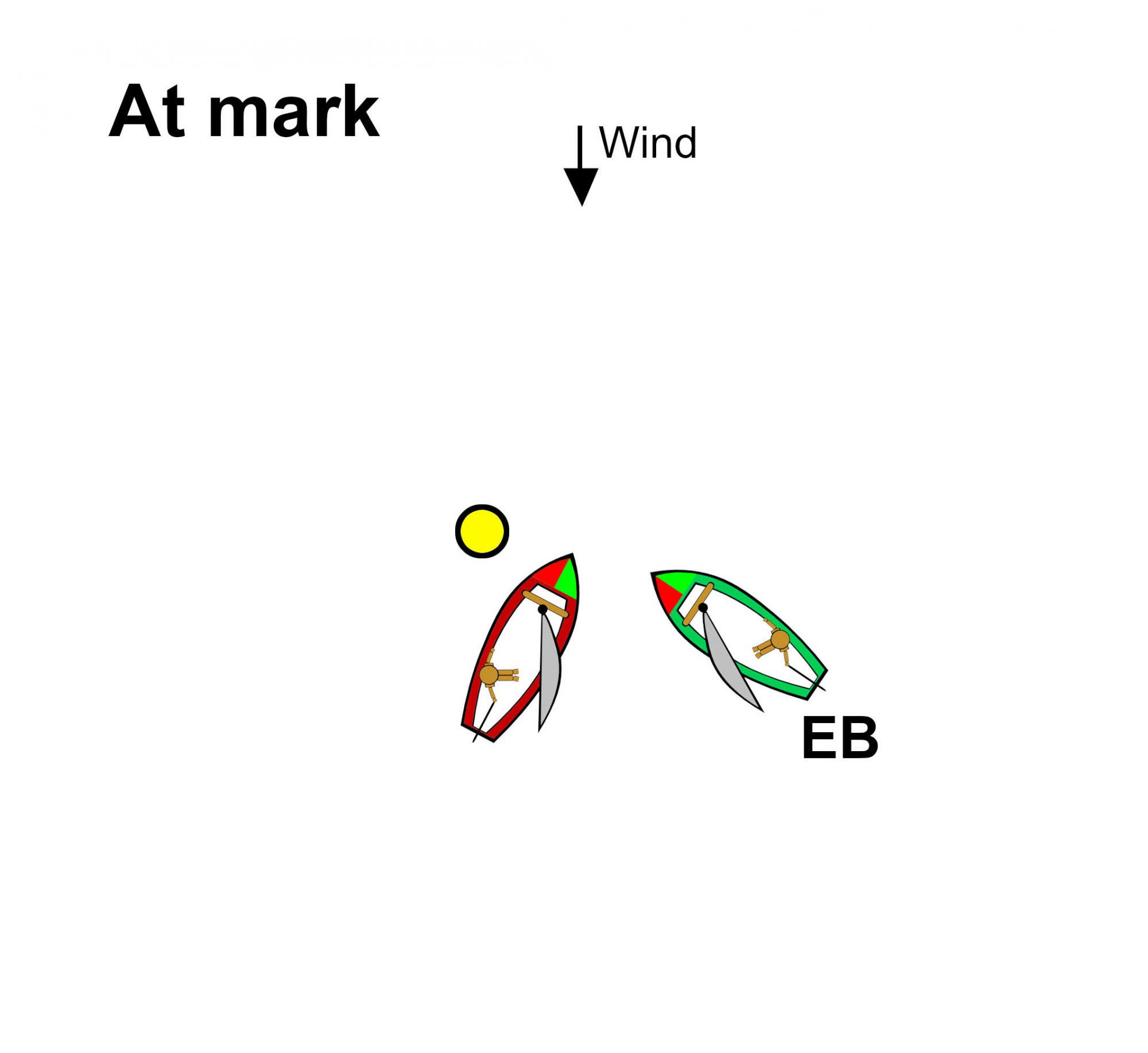

Not sure if this applies to the situation. My second diagram might more accurately depict the other boat as in the irons, drifting past the mark, and directly in my path. The turn I had to make did put me above close-hauled. Only my momentum and the fact that they were drifting slowly made it possible for me to get around them and continue sailing.
Makes sense.
Not the situation here, but good to know. Thanks!
Makes sense.
Yes, I have encountered this situation on a few occasions.
Thanks very much for this detailed and thoughtful response. I sure have a lot to learn!
Ah, so they never really cleared onto starboard tack before the “contact”, they were still trying to climb in irons on port before making it far enough to tack? In that case it’s even more clearly their fault - it’s a simple port/starboard, and rule 18 doesn’t apply at all.
The other boat would’ve been much better served ducking down below you, picking up some speed, and tacking on your transom. With a good tack they could’ve been right behind you rounding the mark, and if the next leg was a run they’d be postured to take your wind.
This is also a good example of why it’s not great to be approaching a mark from the port layline. If they were 3 boat lengths below the layline they could’ve chosen to duck you or make that tack outside the zone where they wouldn’t have the rule 18.3 issues.

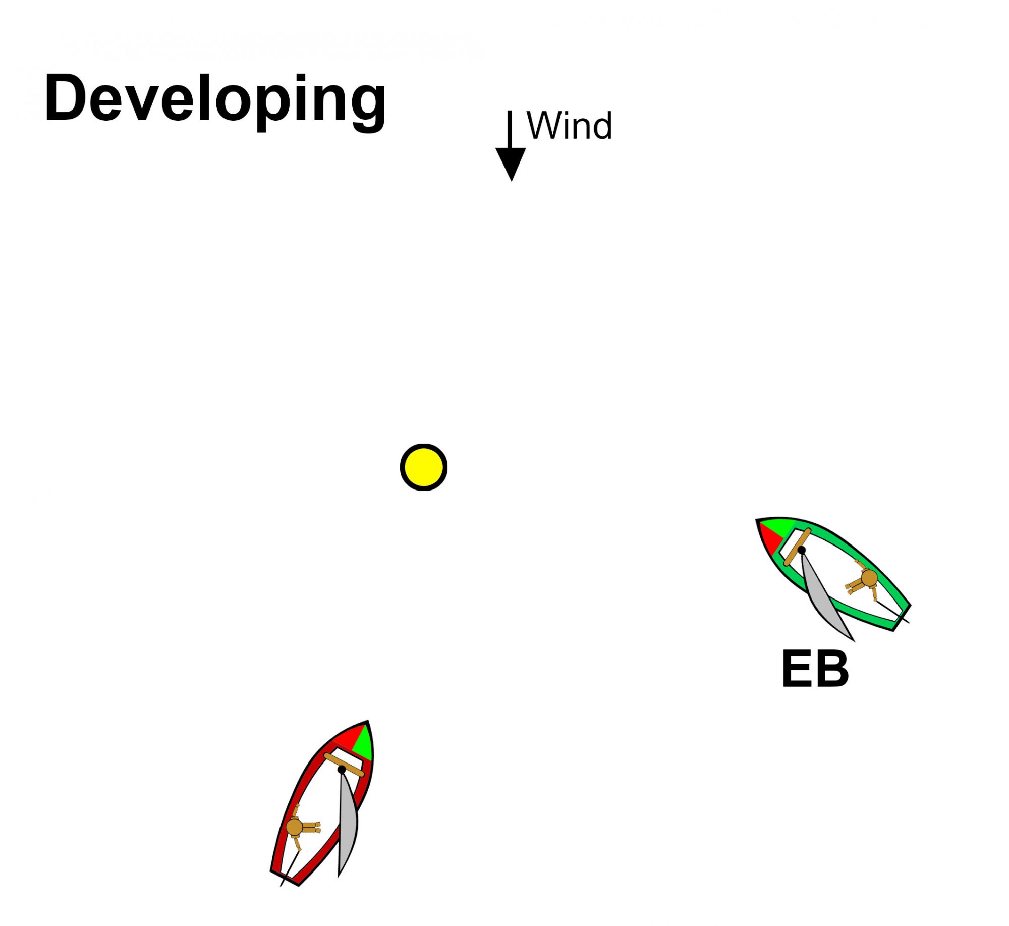

Yes. A little additional background: Well before the mark, we were both on a port tack. They went to a starboard tack and I told my crew they would not make the mark. I waited until I was sure I could make the mark before I went to a starboard tack. As we approached the mark, they, being unable to make the mark, went to a port tack. Approaching the mark, I called "starboard", at which time they tried to go to a starboard tack, but could not do so and clear the mark, so they ended up in irons, drifting past the mark directly in my path, eventually drifting into the mark.
Yes, but they would have to catch me first! :biggrin:
Agreed. There have been times I have approached a windward mark from a port layline and I have been forced to change course to stay clear. They made some strategic mistakes, and I think frustration hindered the skipper's judgement. That or HITA. I'll go with the former for now.
