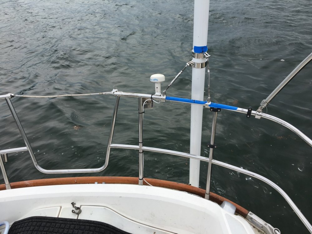

Yes indeed it will be at the helm...... vesper xb8000 looks nice. Is the Gps antenna mounted on your transom/deck level or does it go up the mast?

14,197
Thanks to all for all the great responses! Quick education......
Greg
On the pushpit rail.
The tape and numbers are measurements for a new Fairclough cover.
