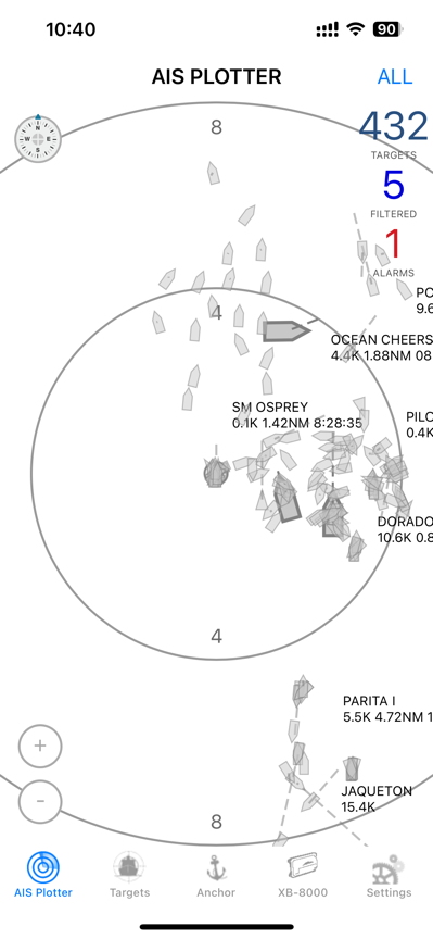

I had a tug and barge “sneak” up in me on day…scared the crap out of me…realized I had turned off my AIS alarm when leaving the marina because a Laker boat in the other side of the steel mill was broadcasting. And even though he wasn’t moving, there was a steel mill between us and I was heading away from him, my Gamin GPS740 was chirping away.
I typically use my AIS receiver and display targets on my CP map. I have some settings to eliminate most of the false positives.

Maybe I’m being thick headed but please help me to understand why a limit of 100 (or 200) closest targets is impractical or dangerous. I‘ve never seen a situation where I’d need to worry about that many collisions at the same time.
Edit: 100+ boats all with a CPA less than 1/4 nm within minutes if each other? I know I’d have a hard time processing that with my eyes-on view, and think it would be near-impossible onscreen with the screen quality of my 9” chartplotter.
Until I became aware there was a limit on the number of vessels in the target list there were several moments of "Where the heck did that high speed navigationally restricted ferry come from?". That was just before some immediate evasive action was taken. Given that most other manufacturers do not have this limitation, I do believe it is unnecessary and inconvenient. Let's just say a Raymarine MFD is not on my Christmas list this year.
