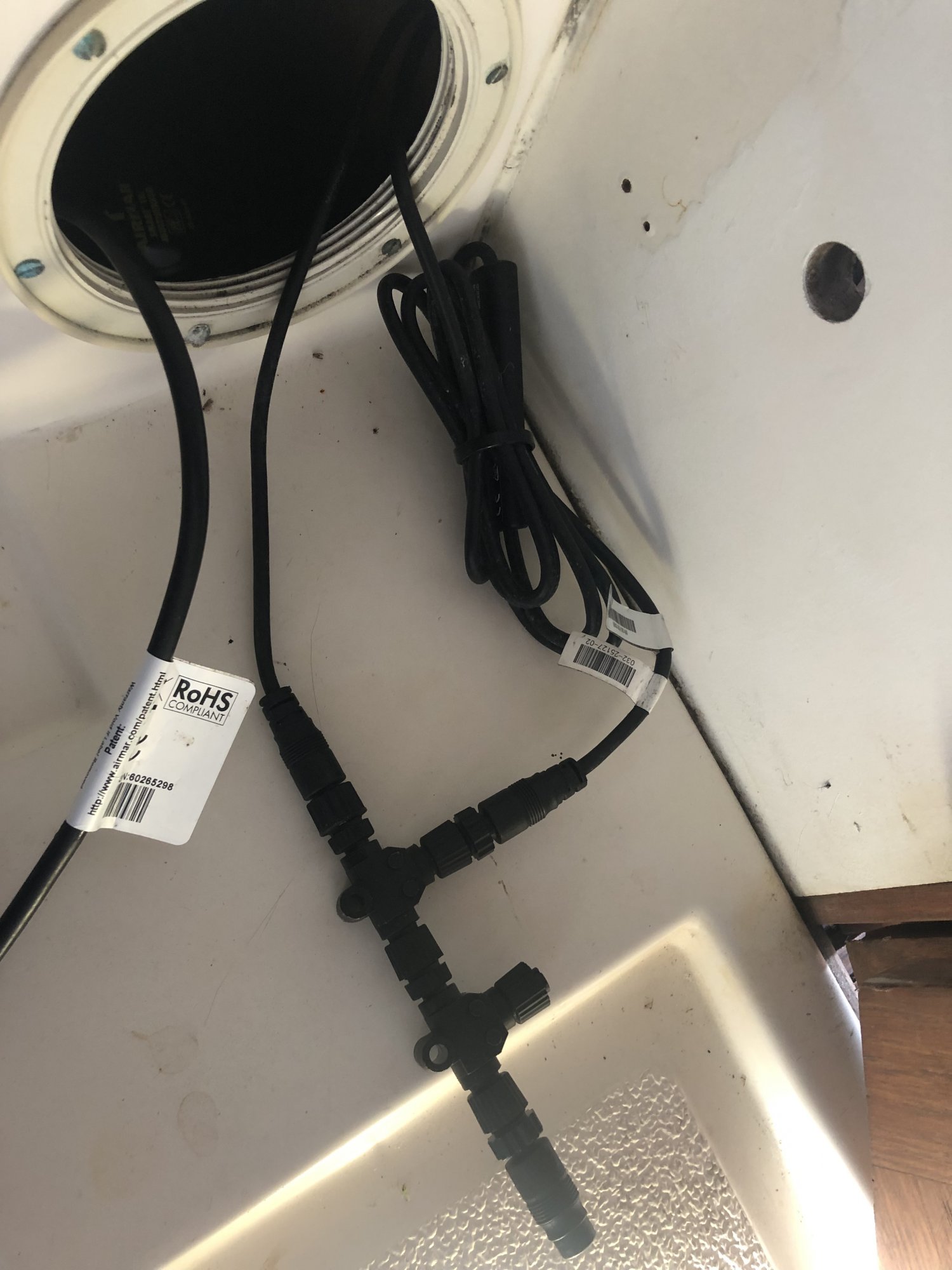

My transducer is located under the head and accessed through a deck plate. There is no way to get two hands in there, it's almost impossible to even get a grip on the cap nut. I had to make a tool out of PVC pipe to loosen/tighten the cap nut.

Yeah, that's tough. Is there any way to either enlarge the deck plate, or install another on the adjacent wall to allow both hands? Picture doesn't have enough perspective for me to see if this is possible.
