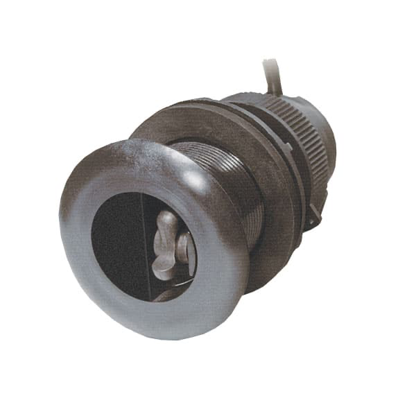

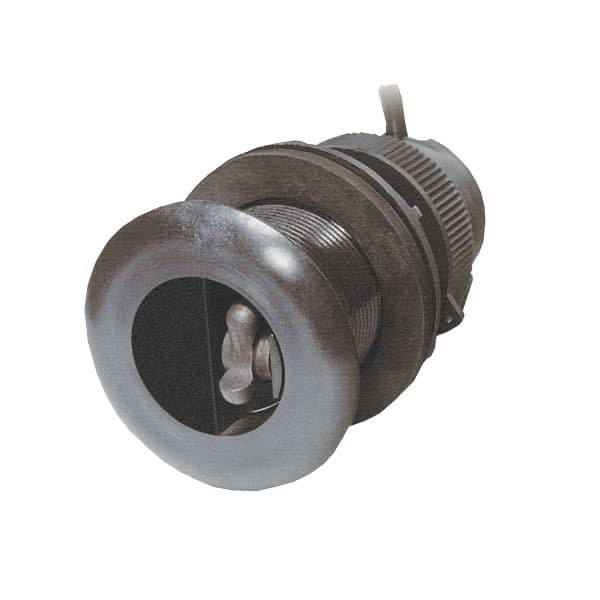

The functional difference is the 810 provides an Attitude sensor.
Possibly also cost.
  • DST800 Smart™ Sensor Thru-hull
    Category: Smart™ Sensor
    Power: 60W/NMEA 0183 & 100W/NMEA 2000®
    Function:Depth,Speed,Temperature
    Frequency: 235 kHz
    Mount Style: Thru-Hull,Flush
    Housing Material: Plastic, Bronze or Stainless Steel

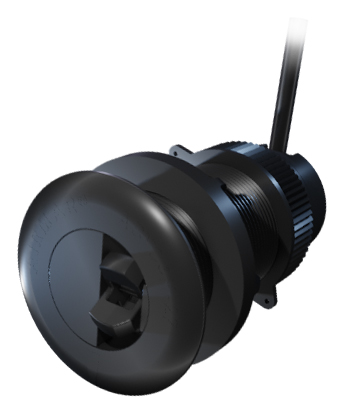

The attitude that they are talking about is heel angle and trim. I just installed an 810 on my H376 with a Raymarine system and I'm waiting for the snow to melt before I can fully test it. There's a good U-Tube video on how to calibrate the transducer, since it has a bluetooth controller. The 810 was only a few dollars more than the 800. I upgraded from the 800 because I forgot to take the transducer out when the strap from the travel lift crushed the unit. Fortunately, the 810 fits into the same thru-hull as the 800 so I only had to make the Seatalkng connection.
