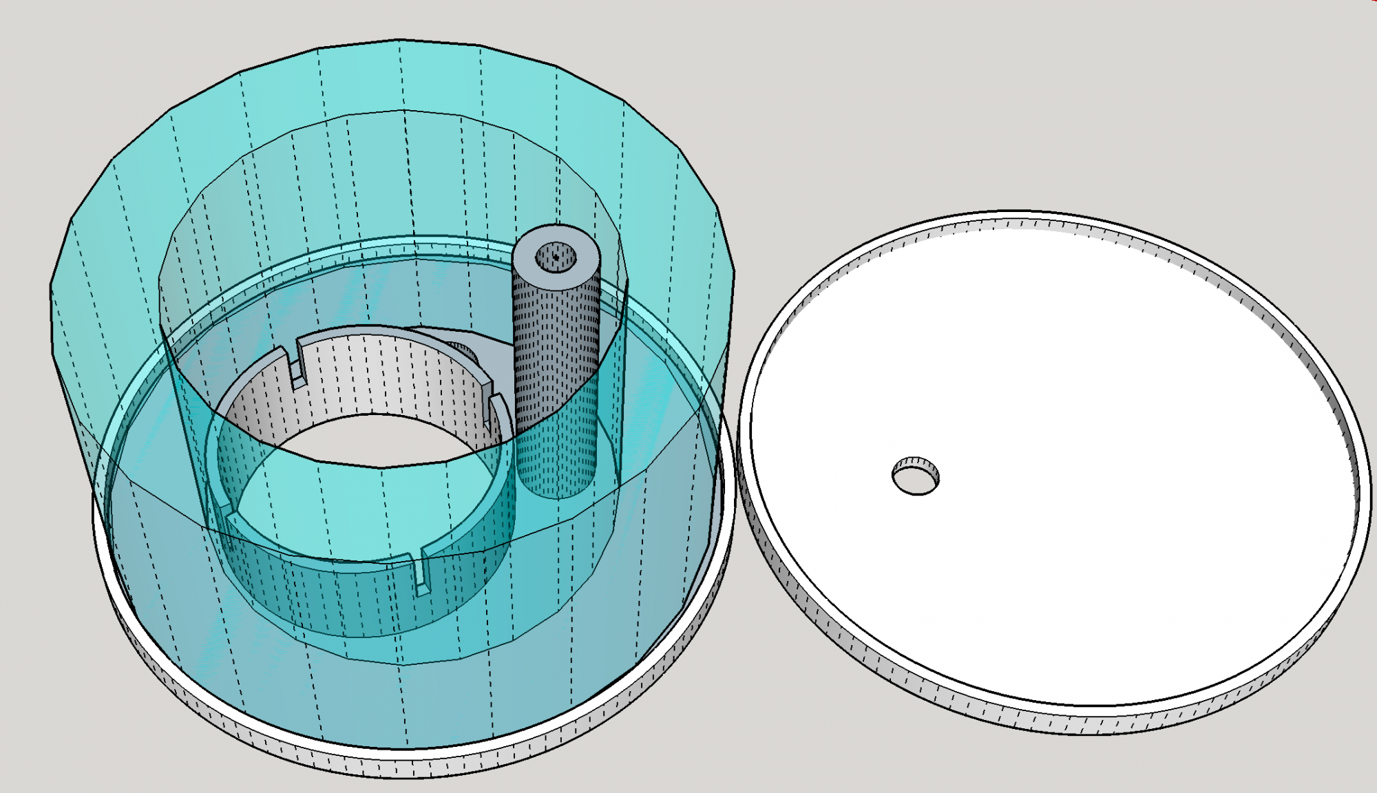

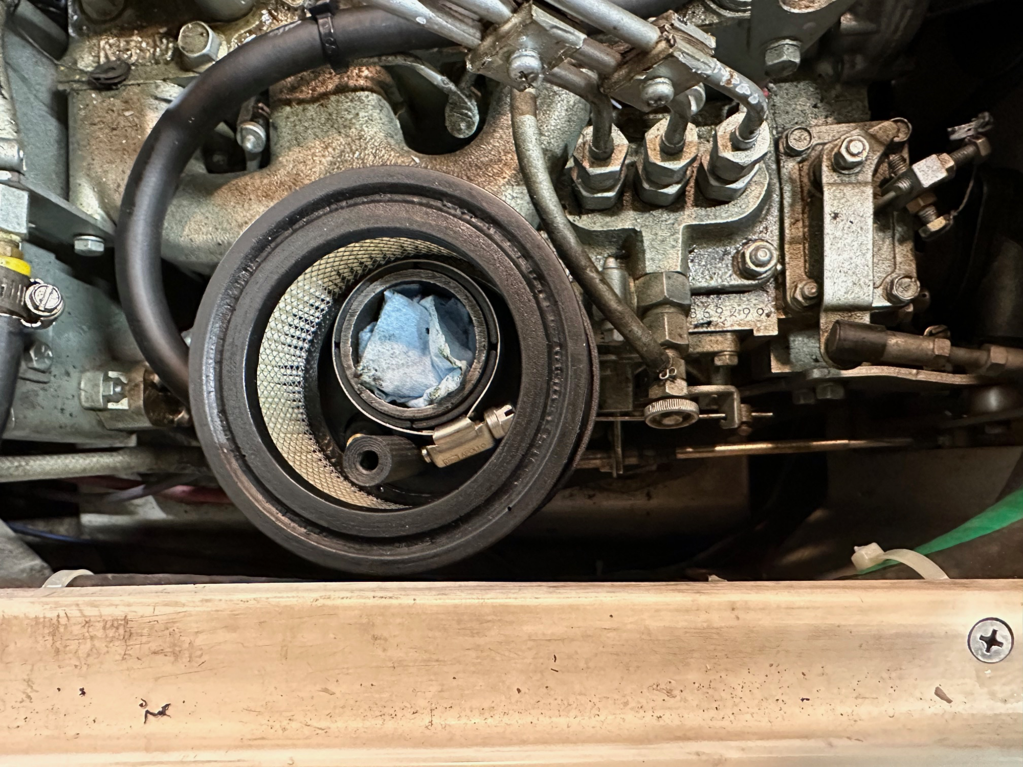

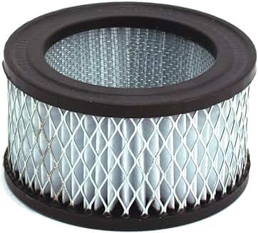

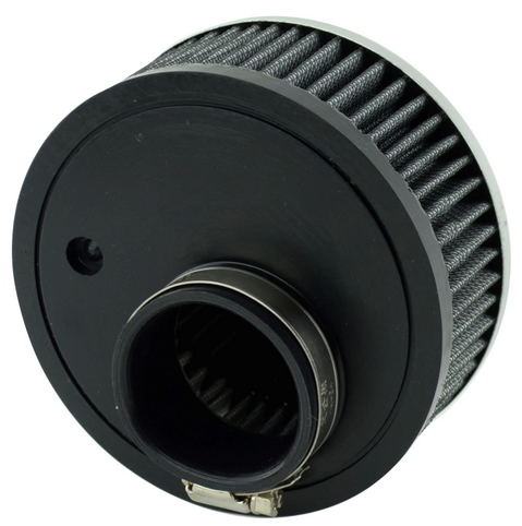

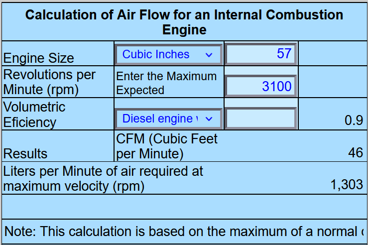

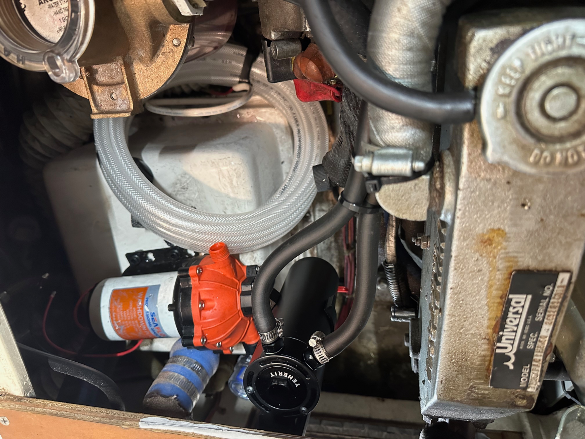

I'm redoing the air intake on my M25XP. The primary reasons for doing this includes proper routing of PCV and replacing the steel wool air filter that's disintegrating. This is a 23hp/57ci engine with a max operating speed of 3100RPM. I found a calculator online to find the liters per minute of airflow coming in to the engine at max speed. Would a 4x2" filter be enough?
Seat of the pants calculation:
There's one reviewer that stated that they saw a drop in RPMs when they installed one filter on their 53' Chevy 235ci gas engine. They discovered that they needed four of them stacked one on top of another to get enough airflow. The same calculator states that this engine requires 18cfm. Since I plan on using a single filter, I divided this number by four to get 4.5CFM per filter. Since my little diesel only needs 3CFM, it should work but I'd love to hear a confirmation from someone with a bit more knowledge on this subject
