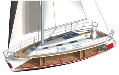

Hello fellow Sailors! Just wondering is anybody has installed Air Heater on Hunter 38.
I am planning to buy WEBASTO Air Top EVO 40 for my yacht to "extend" sailing season through all year. If you have Air Heater already installed in your boat - few photos with heater positioning, ducting, etc. would be VERY helpful! Also I would like to know how noisy is it - my wife is very sensitive so I should take it in consideration. Thank you in advance
