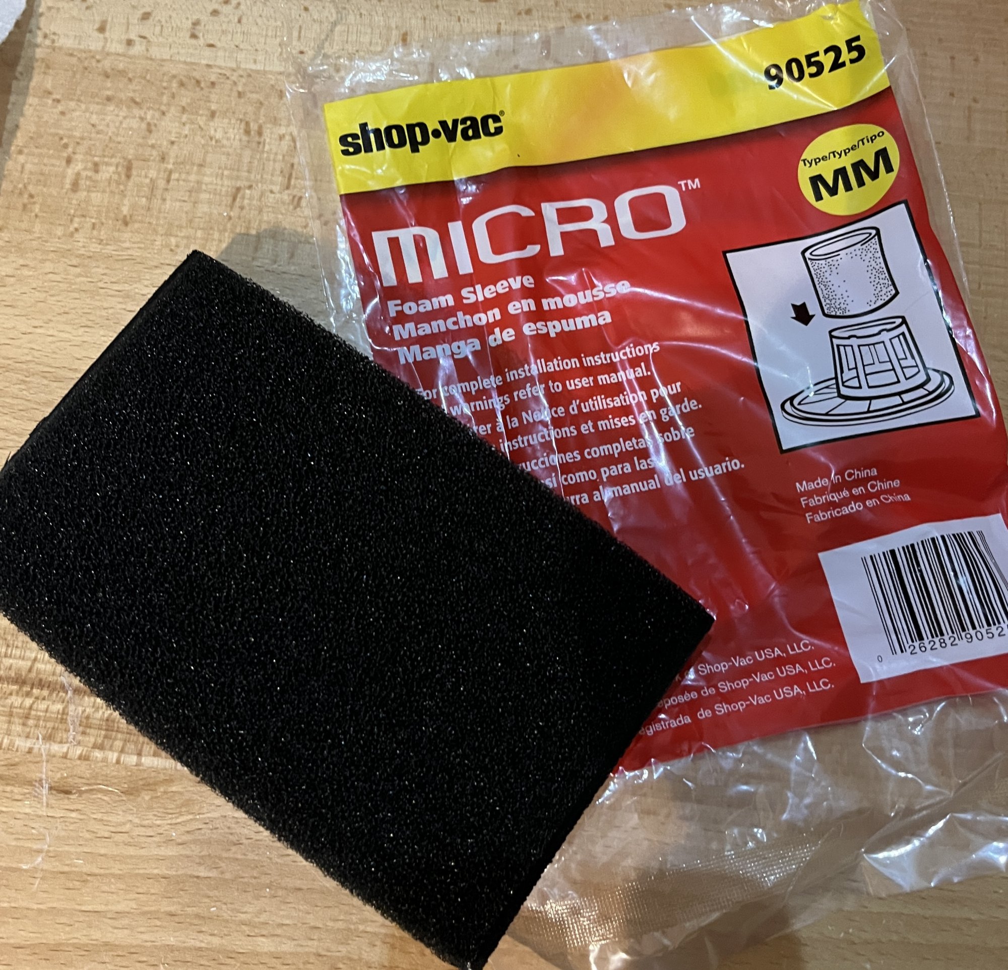

Nov 12, 2023
1
Catalina 28 MkII Vancouver
I found a great alternative for the Foam Element on the original air filter. Shop-Vac Micro Foam Sleeve PN 90525 is the perfect fit (same diameter as the original Universal air filter). Cost was $11 CND on Amazon.ca.
