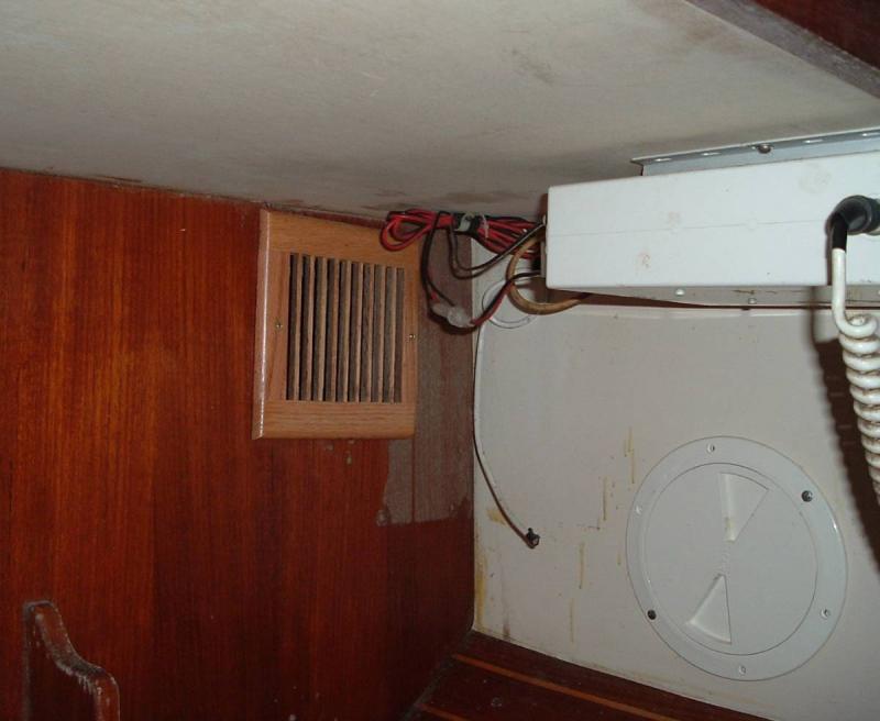

I have been thinking of installing a/c in the V berth: a fellow Hunter friend has one just as you go into the V berth, my question is: which one do I go for?

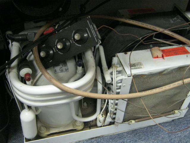

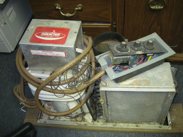

A while back, the owner of the salvage yard phoned me and told me I could come pick one up; a few days later, gave me another one.
One is a Cruiseair and the other is a Aqua Air
I suppose testing them first will be a good idea: I guess just plug onto current will determine that
Which one in your opinion should I install? Does anyone have one? The Cruiseair still has a price sticker of $1256.00, so I think either is good

Many A/C units are under settee's, some in cabinets. On our boat we have a hanging locker opposite the head. A/C is on the shelf above the closet pole. Using a location between the v berth and the salon lets you run cool air to both. Bear in mind you will need raw water for cooling and a drain for condensate. I used a T off the head intake for my raw water. If you do this, you have to have shutoff valves so the water flows the way you want. I have had marine air units on all my boats. Not familair with either cruiseair or aquaair

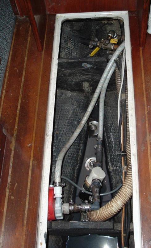

I don't see the waterpump in either picture, a major component. They are small and do not take up much space in the bilge. In the picture you can make out the red pump and filter. Like Bill I Tee'd off an existing thru-hull, in my case the engine cooling seacock. I did not run any ducts. My Mermaid blows directly into the salon under the nav table. On a really warm night I will use a fan to get more cool air into the v-berth.
