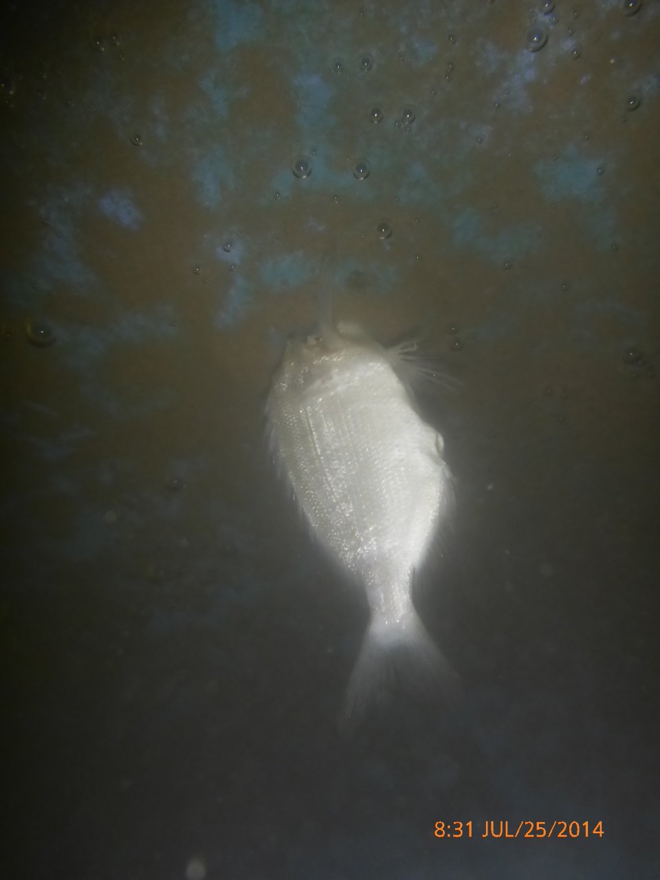

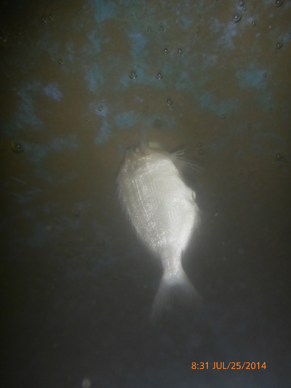

WayneH
1,125
Tartan 37 287 Pensacola, FL
Sometimes, your blockage is outside of the boat.
Yes, he's stuck in the A/C inlet. I told the owner she could restart her A/C and cancel the service call.
