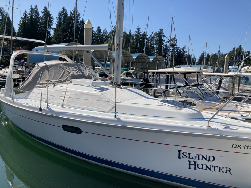

Do you have exterior window coverings for your ports and hatches. I emphasize exterior as if they interior, you've already let the energy in and you hooped (or cooked) which ever the case may be.
I don't have AC as 75 deg. F outdoor temp is a hot day here. I only have port covers so far as I have not come up with a good design for a hatch cover yet. The port covers caused a large drop in interior temp when I installed them.
