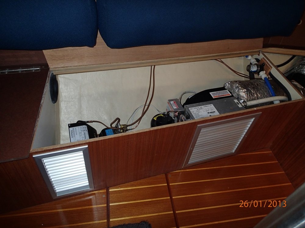

Do you find 12K enough? Where are you located? I'm in Georgia and was thinking 16K.
Gunni
Mar 16, 2010
5,937
Contrary opinion: 1/2 dozen or so low-draw boat fans and a 12k BTU A/C unit. You will want the fans anyway when away from the shore-power. Fans were what we used before marine A/C came along.
Oct 29, 2005
2,362
I'm located in Singapore. Weather probably like Florida but minus hurricane/typhoon.
For us, 12kbtu just about ok in day heat but pretty cold at night. Your mileage may differs.
Johann
Jun 3, 2004
485
Leopard 39 Pensacola
I have an H336 with a 12k mermaid located on the FL panhandle. It works well at night, but on a hot sunny day it will only maintain a temp delta of 12-15 deg from outside. There are a lot of losses in the long ducting runs. I plan on eventually adding a 5-6k unit in the aft berth area.
