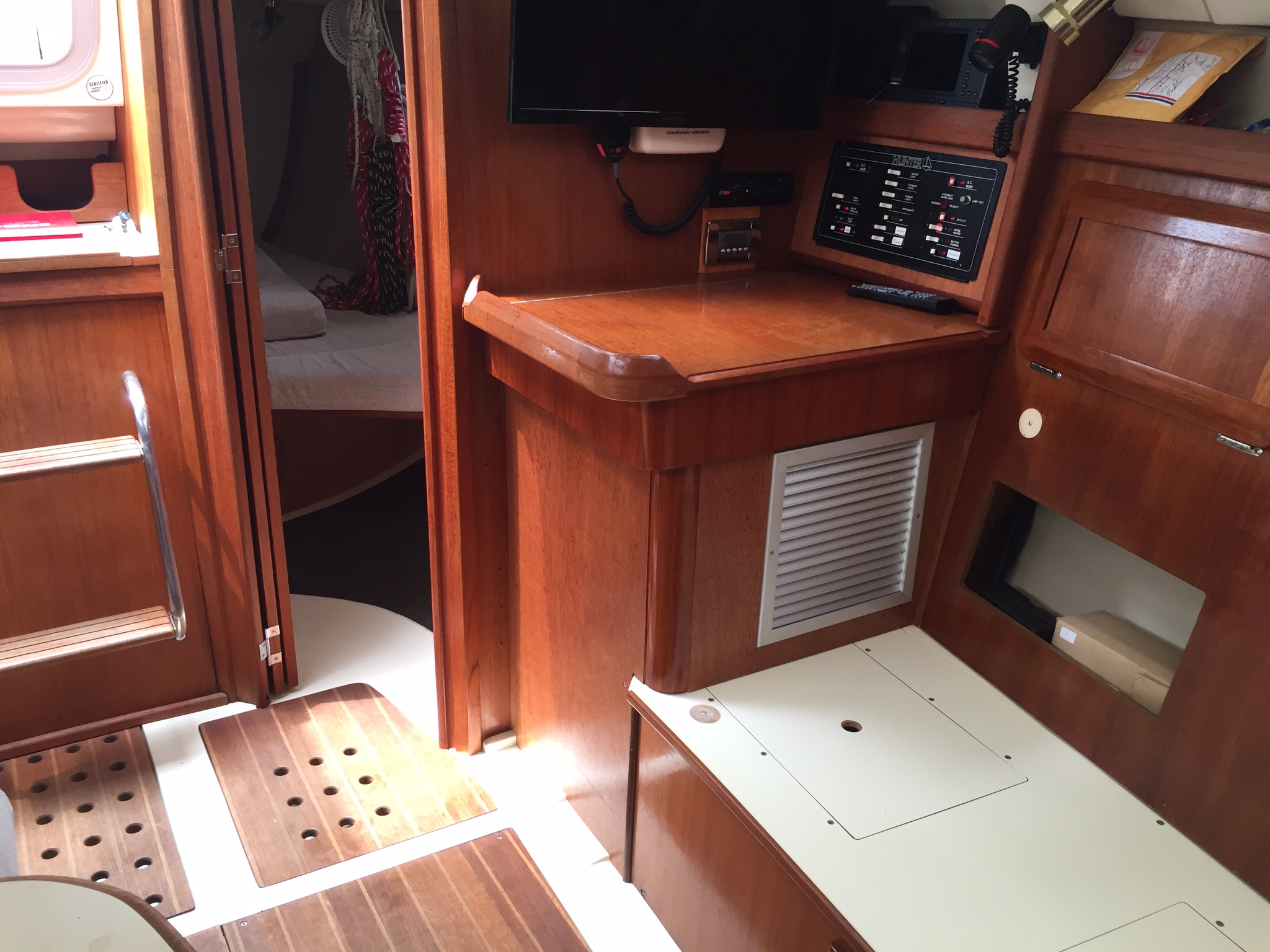

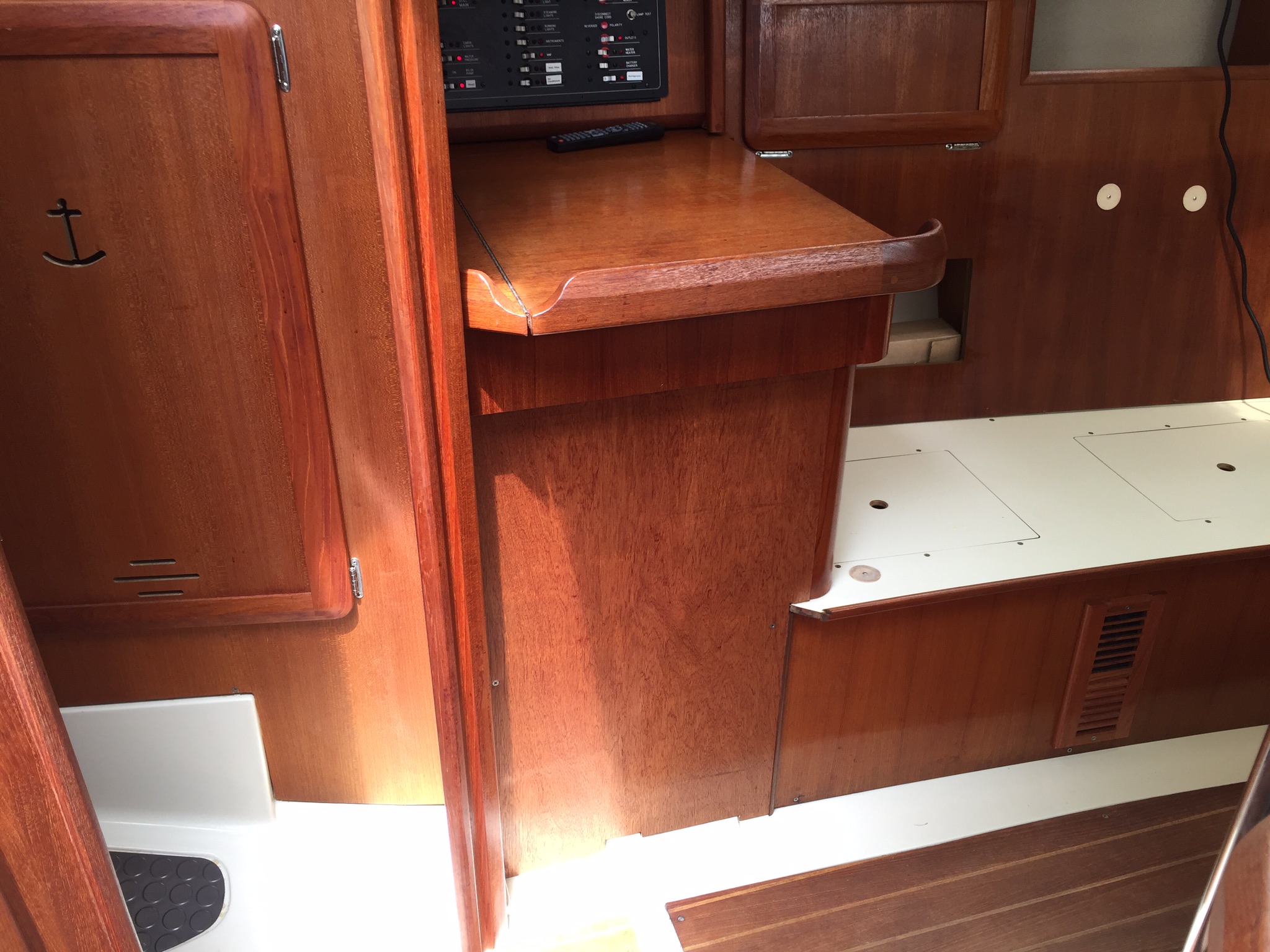

I have a 1993 hunter 37.5 I would like to install an air conditioner in the boat this year. After doing lots of research and finally finding one with good reviews I realize it won't fit in the area that I was intending on using. (under the couch near the nav station) is there anyone out there that either had or had installed them selves a AC unit for this same boat? If so where was it placed and what BTU and what manufacture. From what I hear I need a 16,000 BTU unit. 12,000 woodwork in the area that I intended. But I feel that will not be enough. Thanks for everyone's input and time.

I am not sure if that will work for me. I will have to look. The holding tank and the diesel tank are back there or mine. I was also thinking about under the nav station and having a cabinet built around it. Thank you for your reply!

Just looked up the vector. The price is a lot more than others. The dimensions seem to work. I am thinking about making a cabinet under the nav station and installing a unit there. That way I have more room and more options of other units. So you're saying a 16,000 BTU unit will be more then enough to cool and heat my boat? Thank you for your response
