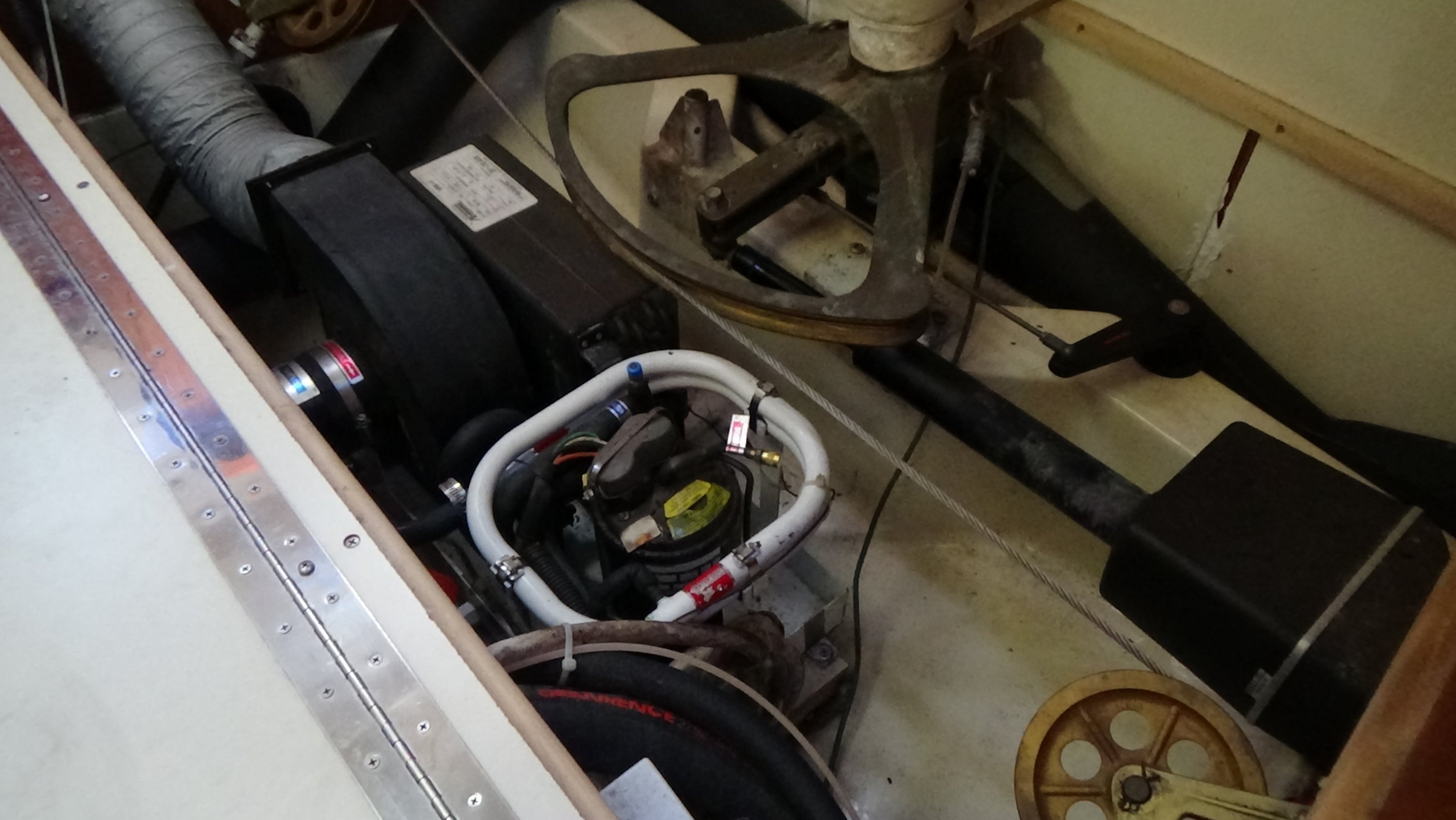

the exact same freeze up happens on cool
Different brand here (MarineAir), but soon after taking possession of our 1991 boat in 2002, I turned the forward heat pump on to get heat, but after awhile no heat. I later learned that the seawater pump (relay breaker) needed to be on. When I checked the unit, it looked just like yours; frozen. After that little episode, whenever I turn either system on, I check to make sure seawater is flowing from the discharge through hulls. Not sure what you mean by "the water is rock solid".

Thanks for the clarification. Unfamiliar with the symptoms of a stuck/broken solenoid valve. It would seem that as long as water is flowing through system, whether heating or cooling, that it would not freeze up like that shown in the picture. Unless the solenoid valve is diverting water flow, bypassing what appears to be the condenser (not sure from the picture)?
A picture of ours shows the condenser (white pipes that frost over in the absence of water flow), compressor in the center of the pipes and the evaporator to the upper left that is connected to the fan.
