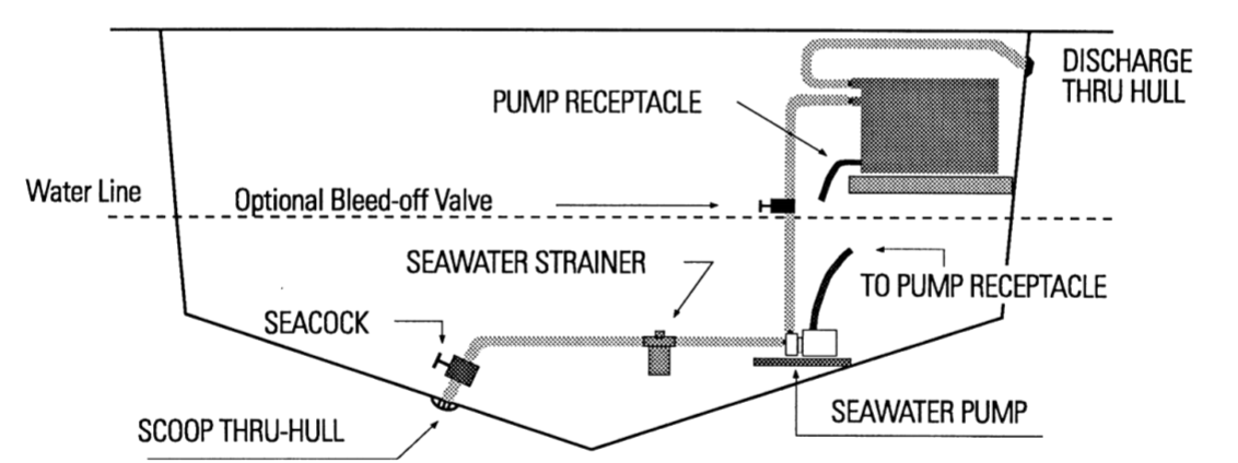

Inlet at the bottom and outlet at the top since the raw water will heat up and expand while pumped through the unit. Installation guide attached for your reference. Do you have a dedicated raw water thru-hull fitting with operable ball valve?

Thank you sir! I was planning on using the thru-hull for the engine since I will only operate the AC while at the dock, but I may have to rethink that decision. I also believe I will have to look at a few installations to make sure I install the return correctly.

Using the engine raw water intake thruhull might be acceptable but check diameter acceptability for short term until next haulout during which time you can install a dedicated thruhull. Install valves to isolate the AC inlet. Outlet should thruhull above the waterline is not a big deal.

Separate inlet needed. Has Mermaid sold any units for the 33. Do you have the owners manual with the information.

I’m wondering here about using the engine raw water intake. seems like a potential big problem. Not to mention what about running the engine at the dock with ac on. However, wouldn’t using the engine intake possibly cause the AC raw water pump to suck water and then air backwards through the engine cooling system resulting in a stalled pump. Just speculating.
