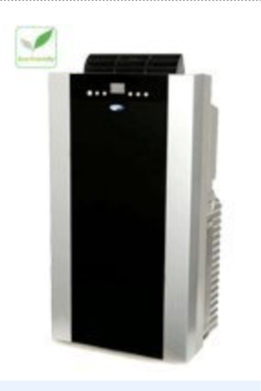

I took delivery of this today. This is one of the higher dollar units with the best ratings. $555 at Amazon
Will try it out first in my camper. Camper has two AC units and we discovered a week before our vacation one unit is not working. Discovered too late to get it serviced. This portable unit to the rescue. After the three week vacation this moves into our 32 foot sailboat.
This is a zero condensation unit that pumps moisture outside, leaving the water vapor in the exhaust. No drip tube to fill the bilge.
I will put this under the stairs and run the vent hoses out the engine room to vents I already have. Should be a very clean installation.

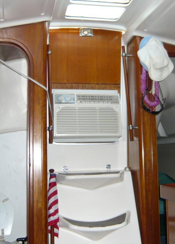

my LG window unit is awesome. 5000 btu with added fan which i place in main saloon, and entire boat is comfy. i use it in a formosa window in the dinette and is not in the way nor a problem. when sailing, is wrapped and placed inside the boat in my master stateroom or in the forepeak, wherever the safest place is--and window is replaced and rebedded for safety. is no big deal and i am comfy as is my fuzzy gato.
unit cost me 140 usd and runs sweeeet....dehumidifies as well as cools--and i am not living in cold interior--outside air is brought in--i can tell by smelling it..LOL
other folks here use an overhead hatch--i didnt like that, as it tilts the unit so water can drip inside of boat. not good.
i have been advised these units are more energy efficient than the built in boating ones. i like that. less problem to repair or replace also. mine is 2 seasons in age now. love it.
vflowe--looks like my LG unit!!!!

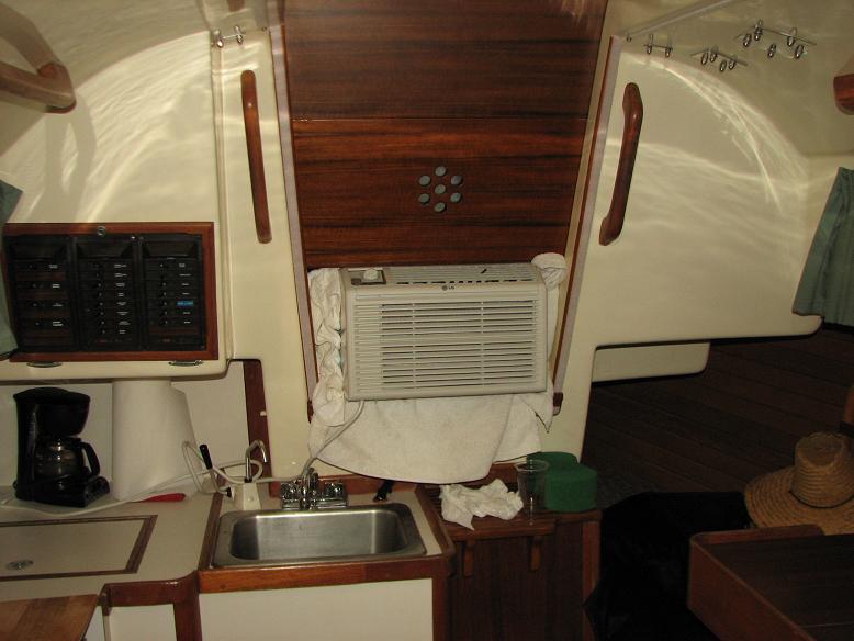

Ron,
I switched to a window unit installed in an altered hatch board. It was cheap, worked well and didn't get in the way except you had to step over it getting in and out from below.
I did the same thing (pictured). But I just removed the bottom hatch board and stacked the top 2 on top of the unit. I just stuff small towels in the voids at the edges. I put a small plastic crate in the cockpit to support the rear. It keeps the cabin about 13-15 degrees cooler than the ouside, and is perfectly comfy even in the Chesapeake summer. You just have to step over it when entering\exiting. The only pain is having to pour out any lingering condensation, and stowing it. However, I only need it about 6 weekends a year, and total cost was $104.

Small AC's at Sams Club $99 Would be perfect for sitting in the companionway.
Issues I see with that, it is only 5,000 BTU. Not exactly a lot of cold air. Hot day, in the sun, this is going to help a little, but how much?

cold air is not issue here--humidity IS. 5000 btu DOES the job for LESS electricity use, dollars -wise, than larger units. 5000 btu is perfect--i only use lowest 1/4 of the damnable thing. dont need COLD air in tropix--you will die of heat prostration when you try to go to shop for food and water---out in the REAL world.
bigger is not always best---LOL

just wondering if you do have one as with a unit that powerful on a 32 ft boat you will need one to wake your bohonkus up just before you freeze to death :eek:.....:stirthepot:....

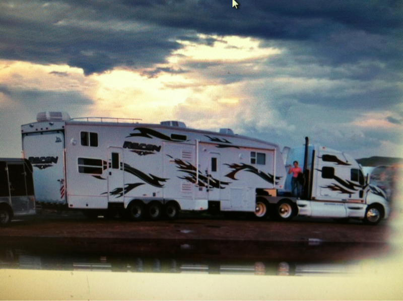

I will be getting double duty from the portable 1400 btu unit. Sometimes it will be used in our camper.
For the next three weeks it will be helping cool the 42 foot camper. It has two roof units, but one is not working and short notice made it impossible to get serviced before my vacation that starts today.

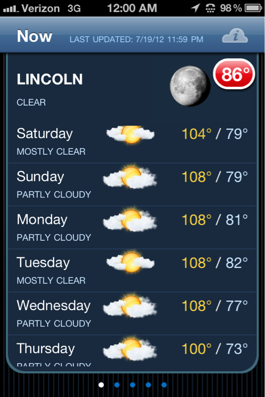

The summers here can get over 100 with high humidity.
