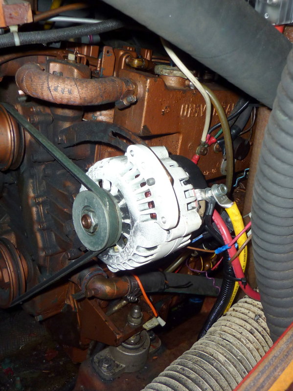

Two words......... BELT DUST !!!!!!
Here's a 1 season old K&N installed on a Universal M-25. The reason it is black is due to the load on the alt and the belt dust created by it.. The loads on today's alternators with their undersized belts are quite tremendous. Even when properly aligned, pulleys cleaned and the belt properly tightened, they can shed quite a bit of dust in bulk charging..
New:
One season later:
After cleaning up some of the belt dust...
The manufacturer installed that foam element for a reason. Our Westerbeke has a paper element filter identical to a car, it gets dusty.
But of course there's no dust in a marine engine bay..... Like none here either...;)

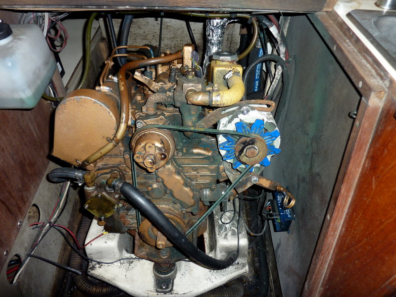

And this engine bay is also dust free...
On a ski boat where the batteries are rarely if every discharged then the engine space will be quite clean. On a sailboat with deeply cycled batteries belt dust can be pretty darn messy..
