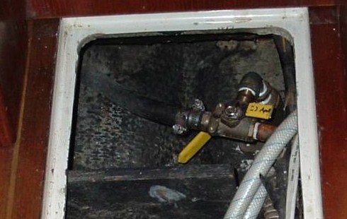

5,802
Before I replaced the 1/2" with 3/4" thru-hulls I used ball-valves. I put an elbow on the thru-hull and then the ball-valve. This gave me the necessary threads because of the straight NPS threads(thru-hull) versus the tapered NPT threads(ball-valve). Only problem is getting the elbow tight and pointing in the right direction.
Even with the seacock I use an elbow to keep things low and horizontal. Picture is of seacock with elbow and 'T-valve'. Left goes to engine and right to A/C. Had to shorten a handle as you can see.
