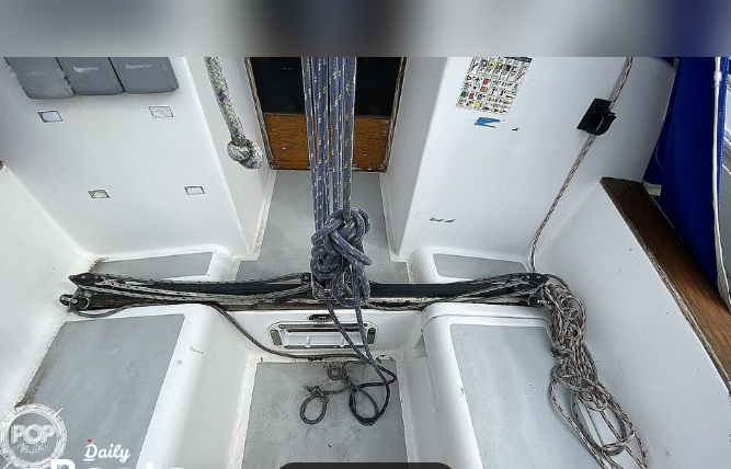

The travler is located int eh cockpit on our 1982 Hunter 33. A real PITA. I have seen the cabin retrofits but was investigating teh arch as well.

The traveler (original Hunter) is on the cockpit. It is rite in front of the companionway and a real Pain when there are non-sailing
guests.
Pic should tell the tale...

Thanks for the clarification. We like our bridge deck traveler. When under sail the loaded-up mainsheet is a great handhold coming and going from the interior. When at the dock we move the sheet over with the traveler so it's on one side of the companionway or the other. Never been in our way.
