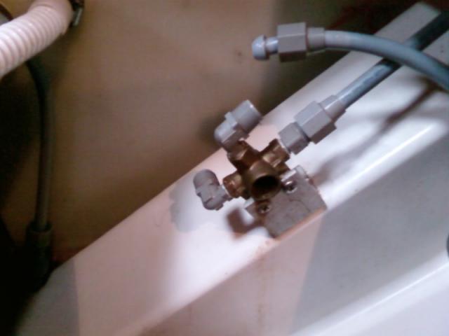

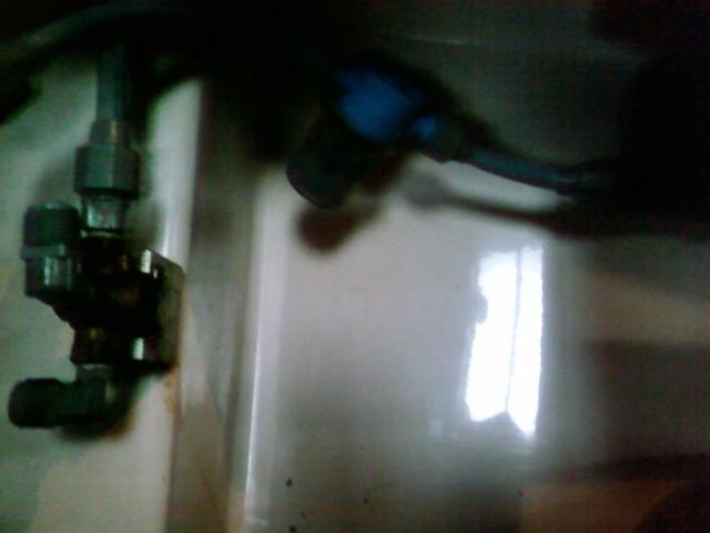

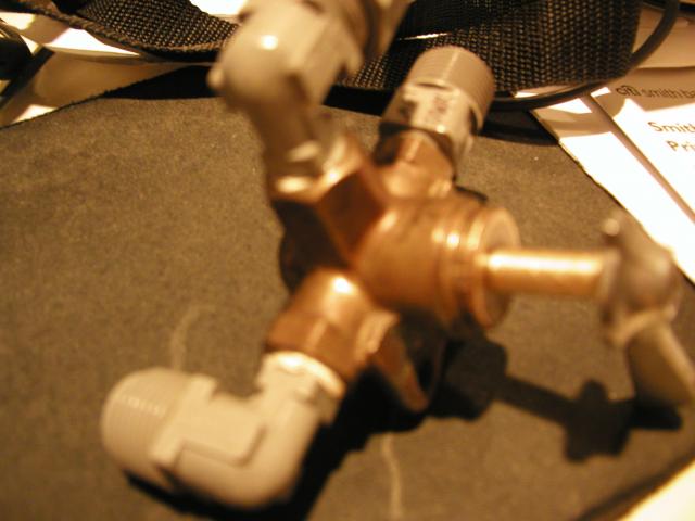

H-34 Tank Selector Valve
Tank selector Valve notes:
The tank selector valve has a non-stainless spring inside which will eventually corrode away. When the happens, the valve will leak air into the pump suction line and cause a lot of spitting at the faucets and cause the pump to run excessively. The valve can be rebuilt by unscrewing the round top plate where the stem enters. Once this is apart, the body seats and the plug seating surface can be cleaned up, the spring and o-rings can be replaced with stuff you can find at a good hardware store. New valve is a lot more than the $3 in parts that were required for the rebuild. Attached pics are of valve, without top, and rebuilt.. I was a dummy for not taking pics of the internals. :redface:

great point about the tank selector valve! I never thought about that. It may explain why my pump can't hold pressure for very long without running sporatically. I previously replaced the pressure switch which solved a major part of that issue.

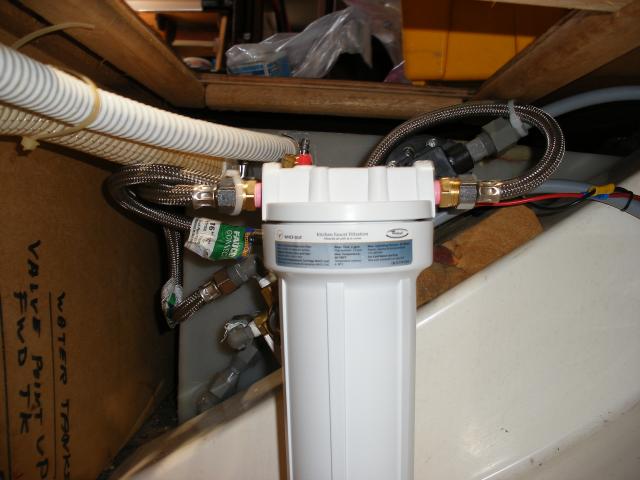

As I don't use the aft tank at all, I may just bypass the three way valve entrirely and run my filter connect directly to the tank.

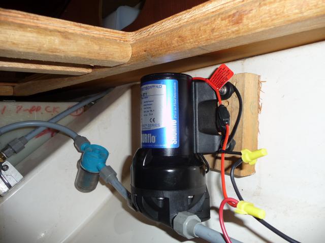

PS: Where did you hide your pressure pump?
10,256
Hey, Dan.. My pump is one of the new variable speed ShurFlow ones. It is in that same compartment but is mounted tucked up in the outboard upper side .. I don't think I have a good picture of it .. This shot (looking down into the space) almost shows it.:confused:. ya can see the water line going to the pump and the fitting on the pump on the right side. The pump is mounted vertically on a wood plate which is screwed to the liner. PO had changed thte mount, I think. I'll be back there in a couple of days and will get abetter shot

Claude: I followed up on my comment on your water valve rebuild and disconnected the feed from the 3-way valve and ran it directly into my filter then water pump. Once the tank was filled and I had the water system flushed out, I left the pressure pump on to see if it would periodically cycle as it did last year. It went for hours without so much as a murmer! I think that the 3-way valve was leaking down pressure into the rear tank feed (no apparent external water leak), causing the pressure pump to cycle. Thanks for the idea!

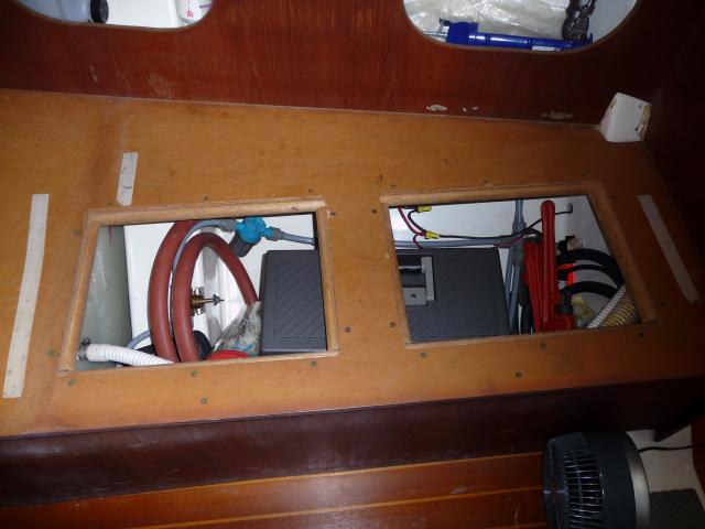

Port Water Tank and Pump, H 34
Dan, It took me a while to get the pictures but here is a shot of the area and where the pump is mounted. I keep tools and spares in the compartment to try to correct the normal stbd list that the boat has. Glad to know that the valve air leak was letting air in.. That is what mine was doing too.. air from the stem and the empty aft tank..

Thanks, Claude...
for the pictures. I may move my pump and filter further outboard like yours to give me more storage room. Like you do and for the same reason, I keep two small tool boxes in there--one mechanical tools, one electrical tools. Anything else heavy gets stored either on the centerline in the aft cabin or in one of the port side storage bins.
I shut down the pressure pump after washing dishes last Saturday morning and went out racing on the boat I drive. When I came back to my boat in the afternoon, there was still strong pressure in the water lines, confirming that the tank selection valve was the culprit for leaking down pressure. One more problem solved!

Dan, yeah, right below that mechanical tool box is the electrical box, which is a Tupperware flat (maybe 6" deep?) box that is on the bottom of the compartment and just leaves enough room to tilt the RubberMaid tool box into teh compartment. The Tupperware box is maybe 12X18 and holds spare filters and impellers as well as crimp on connectors and shrink tubing.. There are 24" bolt cutters and a Bosun's chair in there too.. and teh fog bell..
