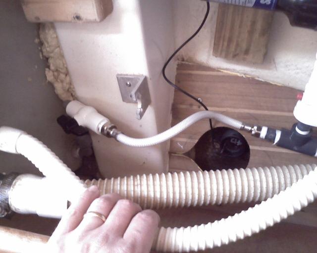

Replace the selector switch with two ball valves.
Move the aft tank fill to a more reasonable location.
The aft tank is covered by the panel at the back of the aft berth.
