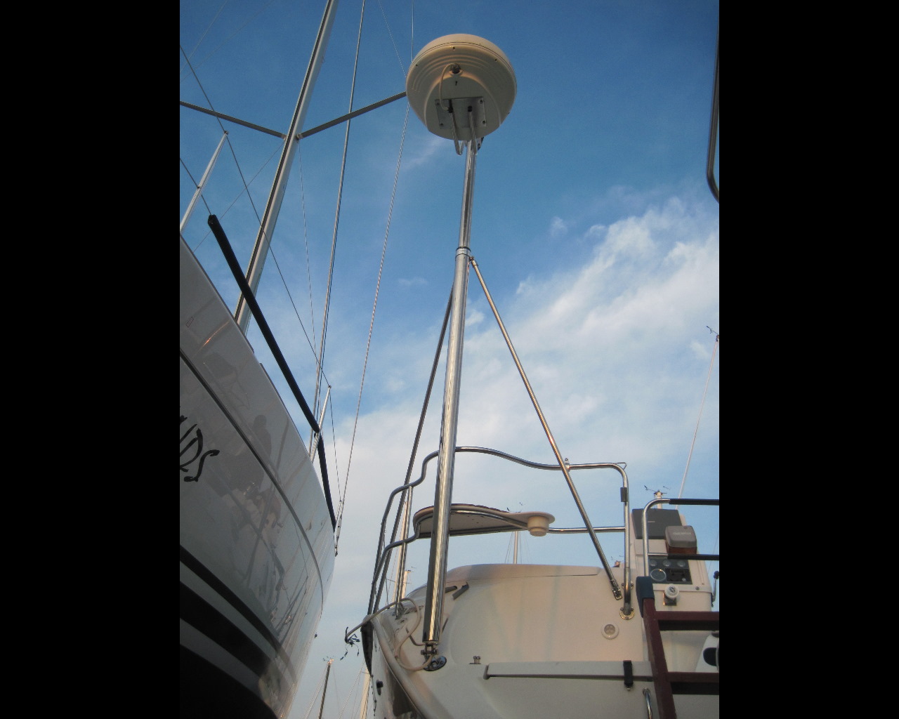

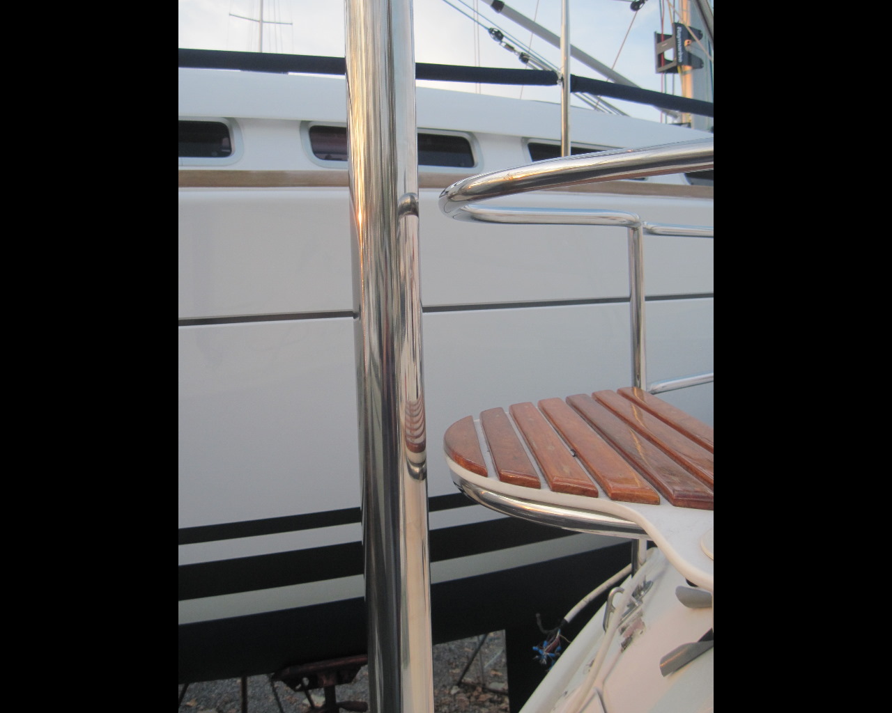

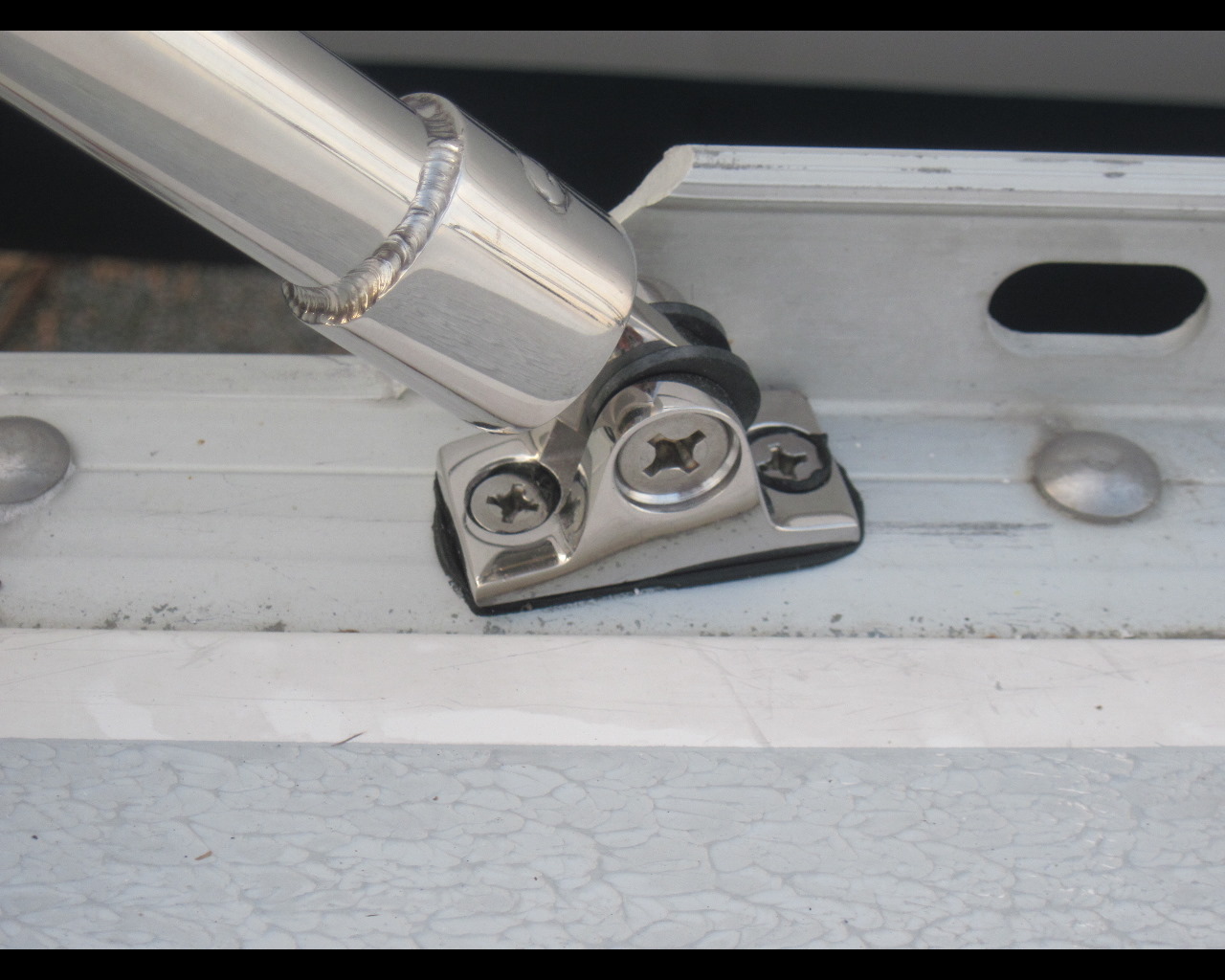

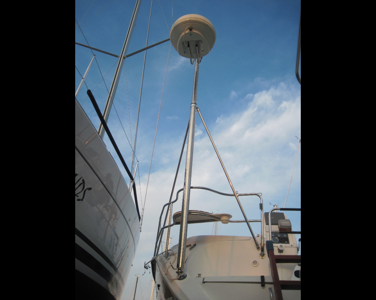

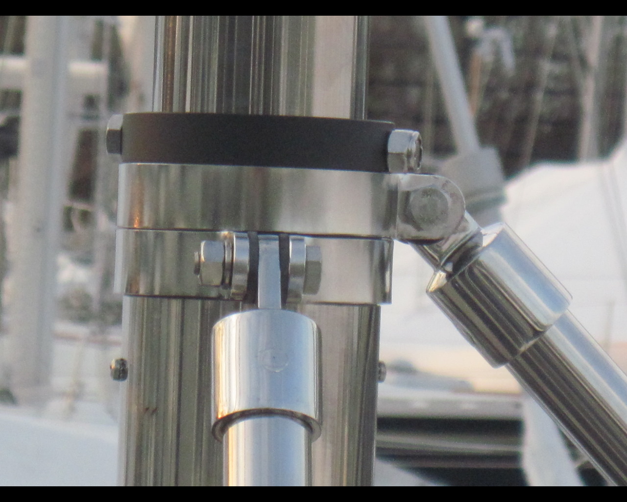

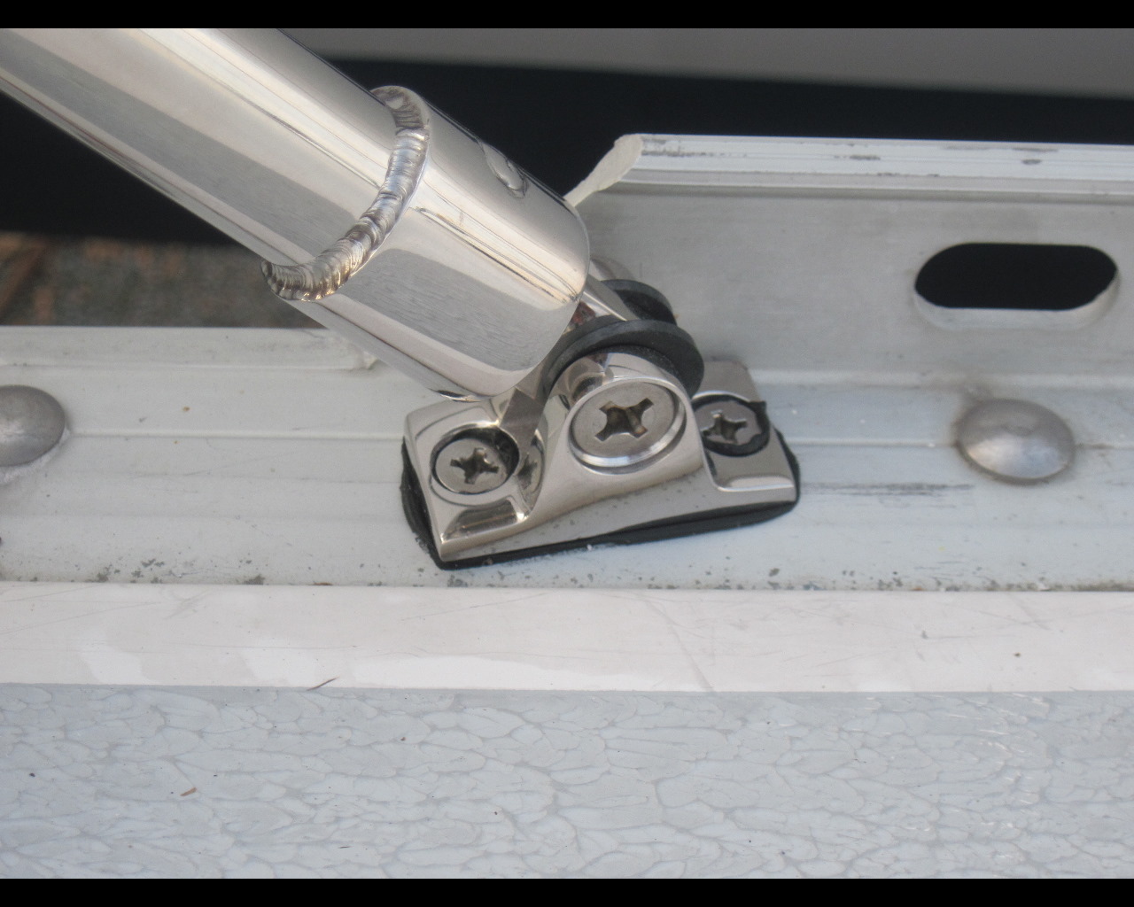

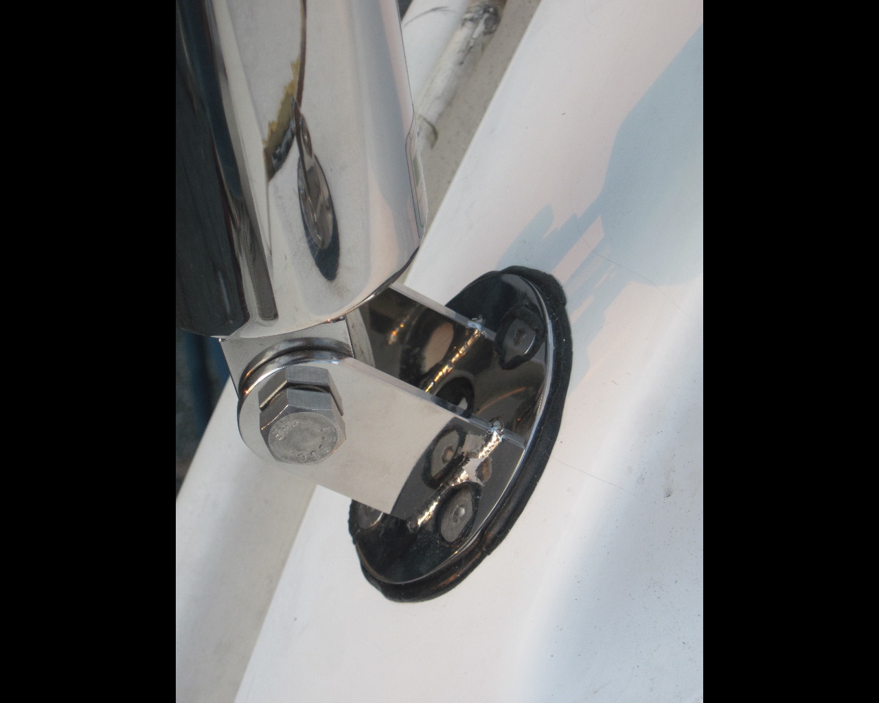

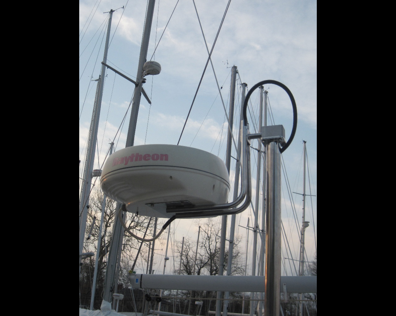

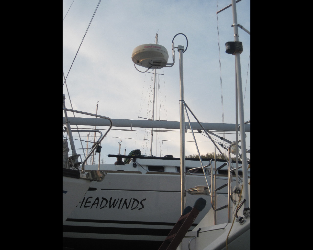

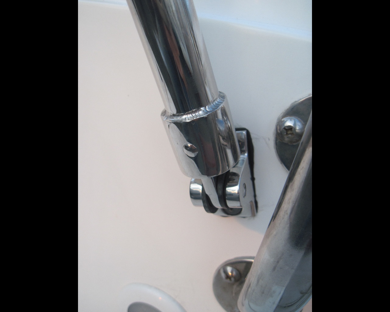

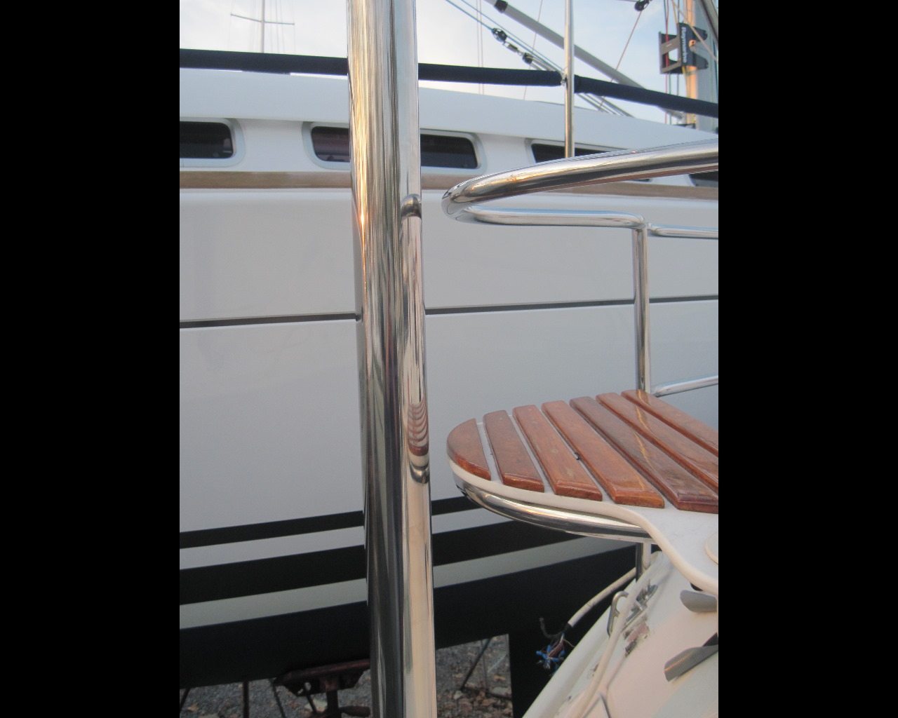

@duck21 - After reading your longer range plans above, I would think that you might want to hold off mounting until you can do the mast mount properly. After research and in-person inspection, I decided that the Kato pole was the very best pole, but that is me and you may want something different or a alternate price point. But the following shows my stern pole mount. I mis-spoke when I said that the 376 was a sister ship to my 40.5. The 376 is a later model and I was thinking of the 37.5. Regardless, I would expect that you have plenty of room on the transom to mount a pole and find two locations to mount the bracing at 90 degrees. IMHO I think that the stern pole is the best location for several reasons. First- you have less weight aloft. Second- the cable runs to the steering console are much easier. Third- when you need to do any maintenance on the raydome, it is near the cockpit and not half way up the mast. Fourth- the head-sail won't whack the radar when tacking. And in terms of radar range, you really don't get much more range with a mast mount vs a pole mount. Anyway, most of you radar working range will be 3 miles or less, and that is easily achieved with a pole mount.
So here are my pictures:
2015_0505_181802.jpg2015_0505_181826.jpg2015_0505_182002.jpg2015_0505_182010.jpg2015_0505_182022.jpg2015_0505_182038.jpg2015_0505_182250.jpg2015_0505_182310.jpg
My radar is a Raymarine 24" 4Kw unit and you will notice that it is mounted on a self-leveling damped mount at the top of the pole. This enables it to remain horizontal when heeled. I adapted that damped mount from an older back stay mount with which I was very unhappy. But the damping device itself was great.
Every installation is unique. I am sure you will find a good solution. However, planning, measuring twice or more, actual mounting, and cabling of the entire system is way more than a one day job. And it will take two strong people. Be prepared and good luck.
