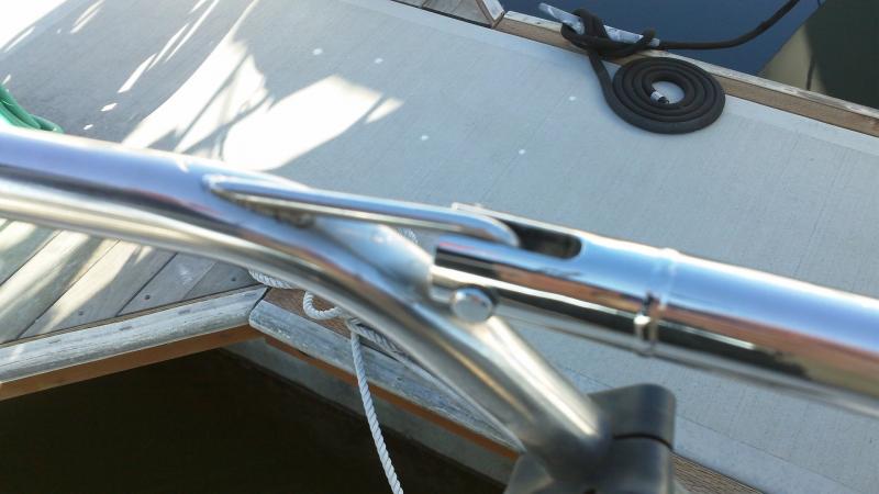

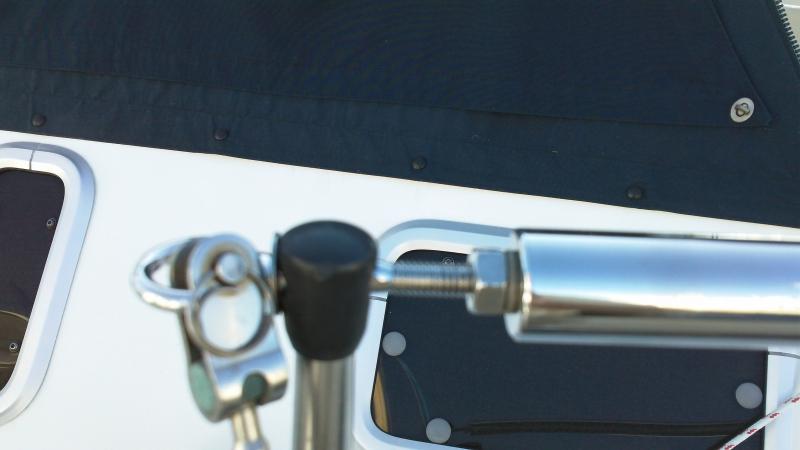

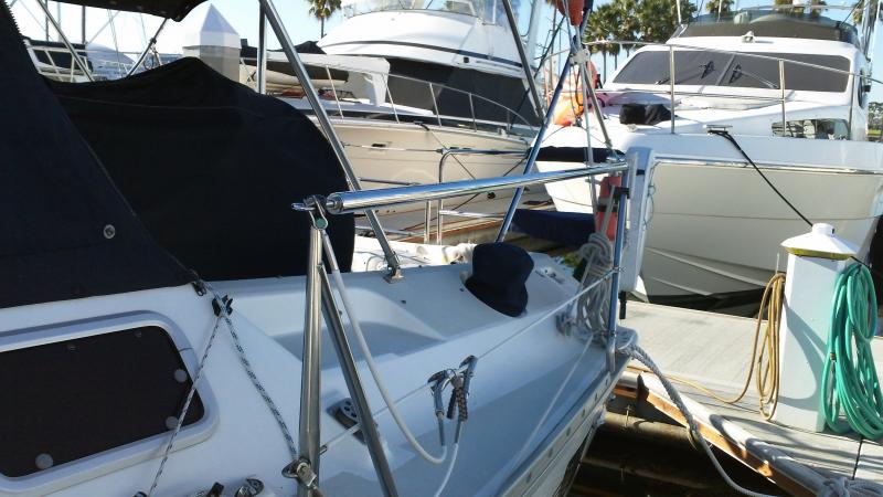

I want to add some additional (but removable) solar panel capacity to my Hunter 40.5. I had some stainless tubing made up with a fork on one end to attach to the pushpit and a threaded eye at the other in order to make the tension adjustable and to attach the lifeline gate. I used a jam nut to keep the threaded eye from moving. Garhauer Marine made them custom to my drawings. I am in driving range of them so I did not have to incur shipping. I also had them make up some other custom parts at the same time. One thing I took note of was an inch and a half difference in length port to starboard. The solar panels will attach with tubing connectors and I will make an adjustable strut to adjust the angle. Here's some pix.

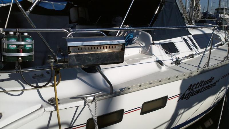

Very nice! So jealous. Love the rack for the propane bottles. Does that stay on even when you are racing?
Rick D
Jun 14, 2008
7,204
I made up the rack for the propane bottles from aluminum flat stock. I got annoyed of not having a spare and didn't like one hanging off the BBQ. And, yes, it all stays on when I race. This stuff offers trivial weight and windage. It's more about being cool to empty all the tanks, remove the cushions, tools & spares. I had a neighbor who removed his doors and drawers too. If you're going to do that, you ought to buy a sportboat to begin with IMHO.
