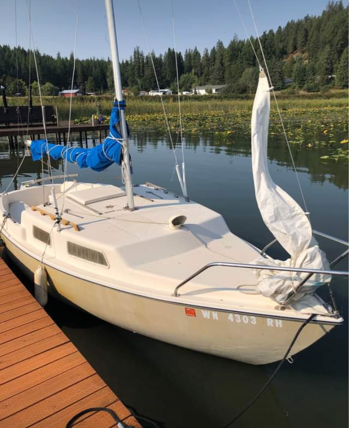

I just bought my first sail boat. Having trouble with what dia. Lines and sheets to buy. Any help would be great.

Moving to a house on a sandy beach next summer. So it was time. Buying a boat now is always cheaper. Have all winter to collect gear

post an image of your new girl.
