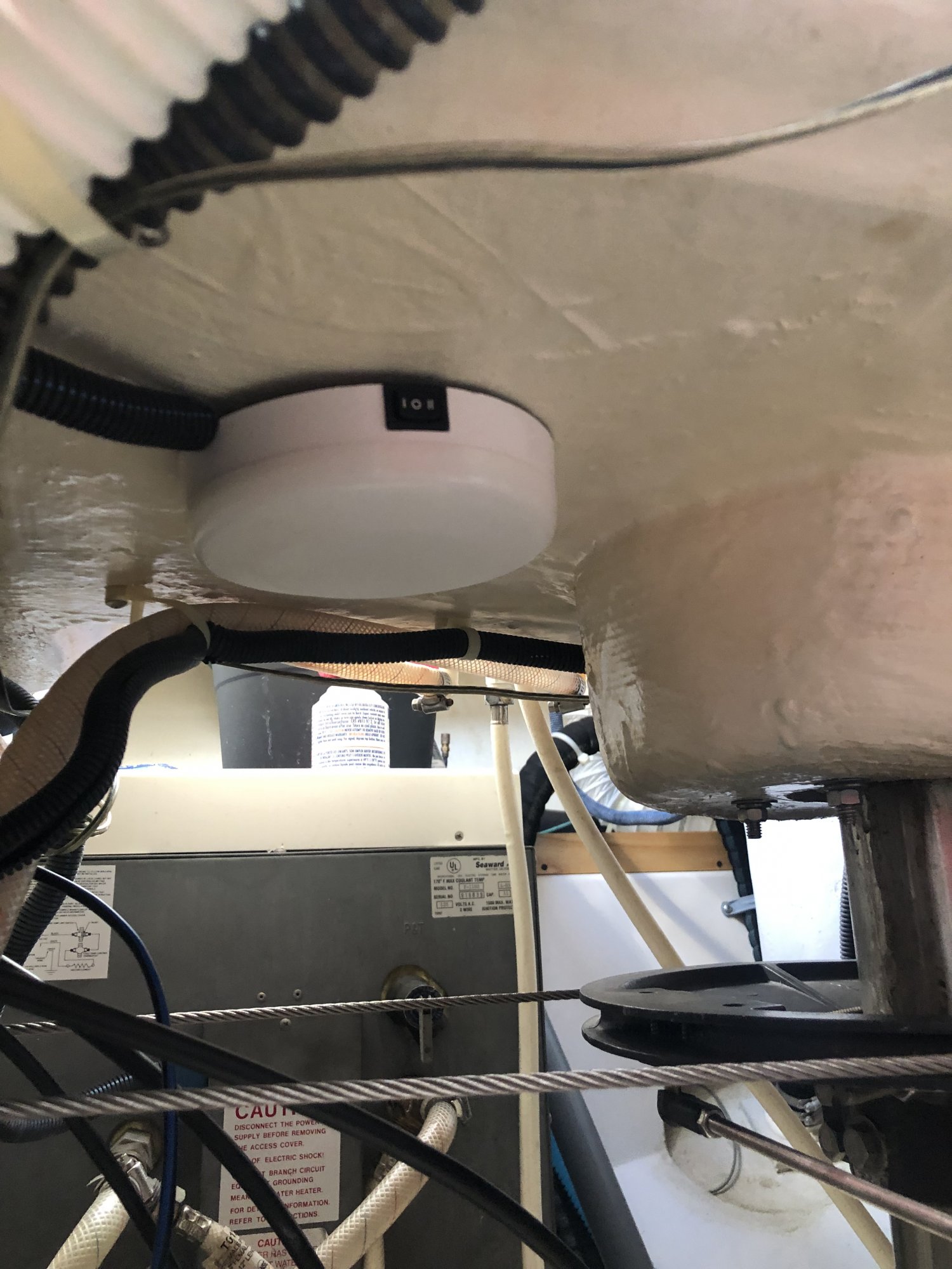

OK here’s the mystery of the week ...
Rear compartment cabin light does not work. Same fixture as the ones in the head.
Good voltage to the prongs and the switch works properly. Tried using the working bulbs from the head and none of them light up. Seems very strange no?

FYI this is likely a light added by a previous owner. Hull 65 doesn't have one.
As to the light. My head light went bad exactly like you are describing. I replaced it with an LED version from Catalina Direct.

Doesn't look like a particularly attractive light fixture, I'm not familiar with it, we do offer some Catalina specific lights, but I would upgrade to a light of similar size/footprint, the electrical connections will be the same:

I do not have this light on hull #160, but I think its a good idea to have one in this area. Possibly the prongs are bent and not making contact to the bulb, heat will sometimes do this. If there is power to the prongs, and a working bulb does not light up, its the bulb/prong connection. Or it is a LED lamp that is reverse connected.....

That looks like the light fixture that is in our head (we have two lights there) , your fixture looks like it is in the fuel tank steering gear area. We have no light there on hull 155 hence what Jesse said!

Check for corroded connections. Trace the wire back. Remove the light fixture and connect an incandescent bulb and see if it lights up with full brightness.

I have the same exact light in the same place on my hull. Probably OEM.

+1 for DaveJ comment RE an LED bulb. If you insert with the wrong polarity they will not work. 100% of the time. And if you insert with the right polarity in another fixture, they will work until years from now when they burn out. Sounds stupidly simple. Ask me how I know. If you have proper voltage measured right at the contacts (voltage when switch is "on", and none when it is "off"), then electricity is making it to the bulb, likely without significant interference from any corrosion. Absent the polarity issue, there's no physical reason why electricity at the prongs won't light up a working light bulb (maybe dimly if amps are low).

That light was OEM installed on hull #218 (2003) if we are trying to determine the switch over date. Try sanding the prongs where the bulb connects if you have voltage on the meter.

We have the same light on #258. Same circuit as cabin lighting. We did have trouble with the switches in head and tried to find replacements. No luck, so I took switch apart, cleaned up and has been working since.

You can have voltage to a circuit, but if you do not have enough amps to light the bulb the bulb will not light. This is normally caused by corrosion in the wires, I would suggest to check the wires for corrosion. If the wires are embedded in the headliner or in the core of the ceiling there could be corrosion there.

I have that light on hull #231, same as the overhead light in the head. The switch on the light in the head died years ago, so I replaced it with a mini toggle switch from radio shack. May be the same issue with your light.
