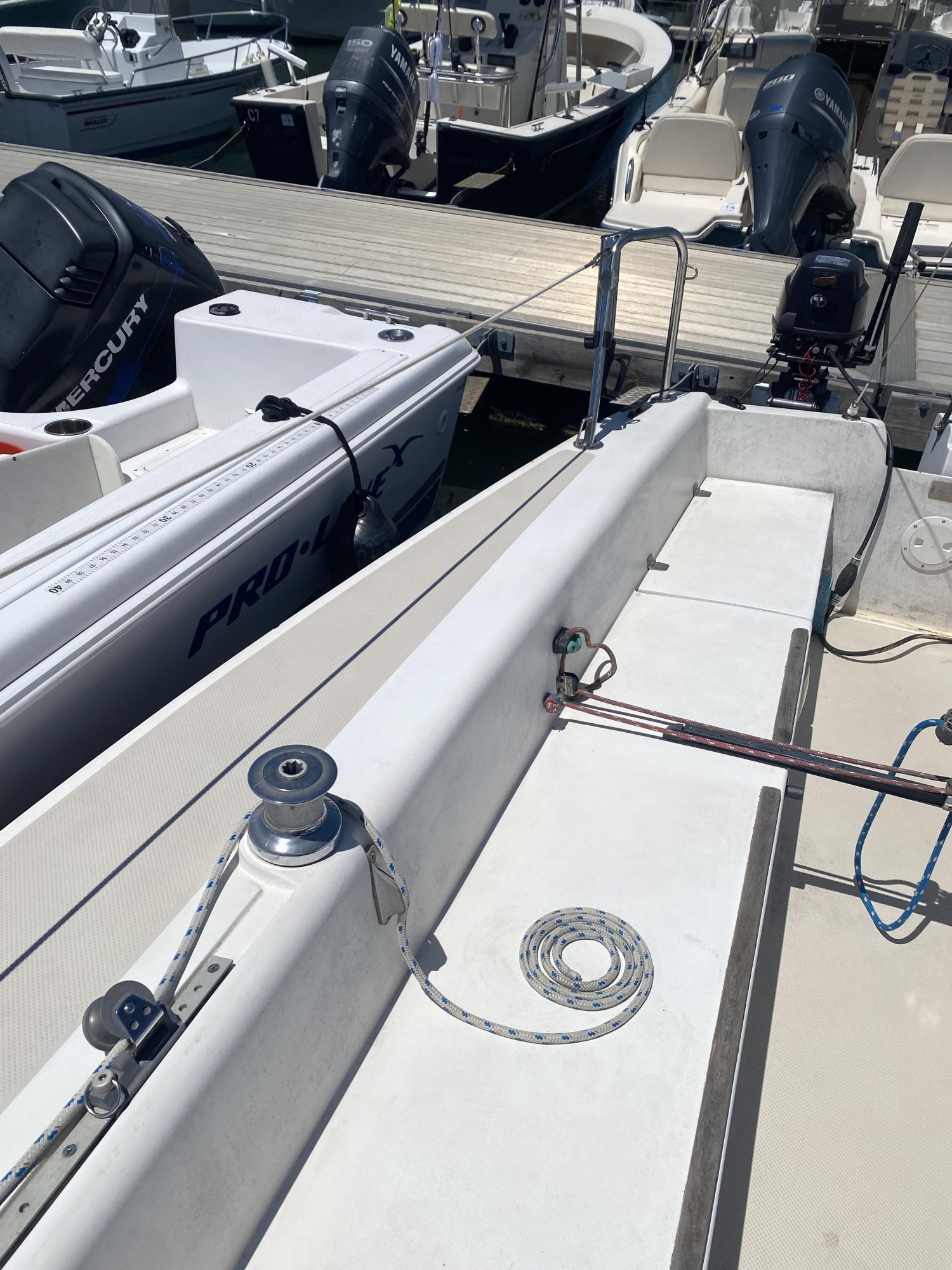

I single hand my Catalina Capri 22 often. The installed clam cleats for the jib sheets are far enough forward so that I have to leave the tiller to manage them. I do have a tiller tender, but in heavier wind, it's not the best option.
I'm thinking about putting another set further aft. Has anyone run into a solution for this?
Thanks very much!!

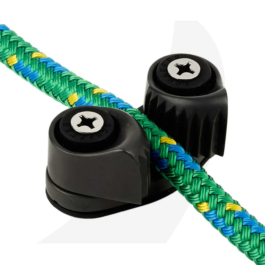

Cam cleats are what I would want. They may be a bit slower to release but if the line is correctly between the cams it is likely to stay there. Put an eye on it and a stopper knot and I think you have a pretty good system.

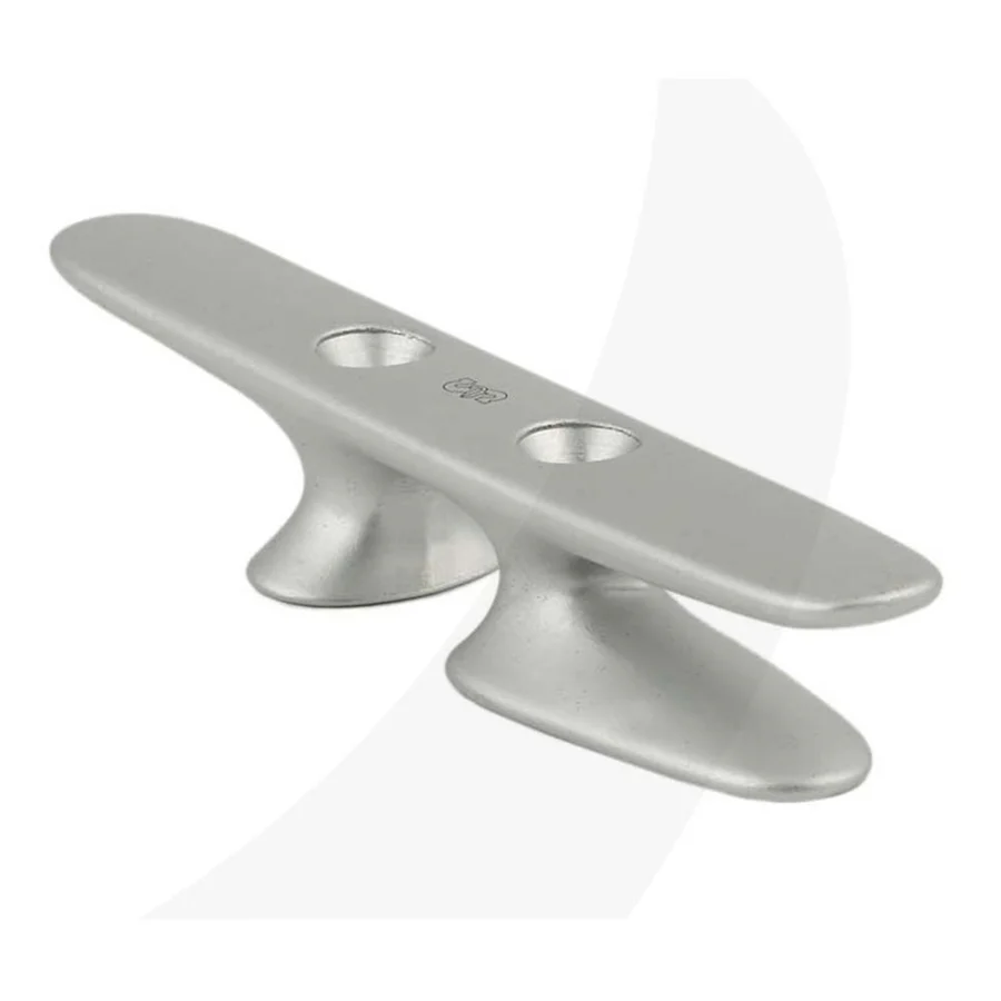

I added aft cleats (Actual horned cleats, not jam or clam ones) to my 1985 Catalina 30 which I single handed all the time. Don't forget actual backing plates.

My Mariner 19 came equipped with swiveling cam cleats on the aft end of the cabin top for the working jib sheets (no winches). The advantages of the swiveling cam cleats (with strap) mounted where they are:
  • easy release and tending from the skipper's position when single handing
  • swiveling allows cross-sheeting of the jib sheet leads in the cockpit. The starboard sheet can be tended from the port seat, and vice versa. This allows me to stay on the windward (high) side of the boat while tending the jib, main, and tiller.
My boom vang originally came with a v-shaped jam on the lower block. This never held under any real tension. On the Mariner, the boom vang is critical because if the boom rises much during a gybe, the boom end will catch on the backstay. So I replaced the lower vang block with one that has a built-in cam cleat. A cam cleat that holds when I want it to, yet is easily released when needed. Just like my main sheet and jib sheets. I have even gone to miniature cam cleats for the Tiller Clutch (another essential single handing item) line ends.

I posted this for a Montgomery 17 owner looking for parts. It supports your idea of a cam-cleat located near your helm. I like the cam-cleat idea over the Spinlock clutch because there is less risk of the sheet becoming jammed when you get a gust, and you need to quickly release the sheet. They will fit nicely on your combing. Just be sure to locate them where you will not be sitting. Test the area a few times before you decide on the best spot. You will not want to sit down on the cam-cleat.

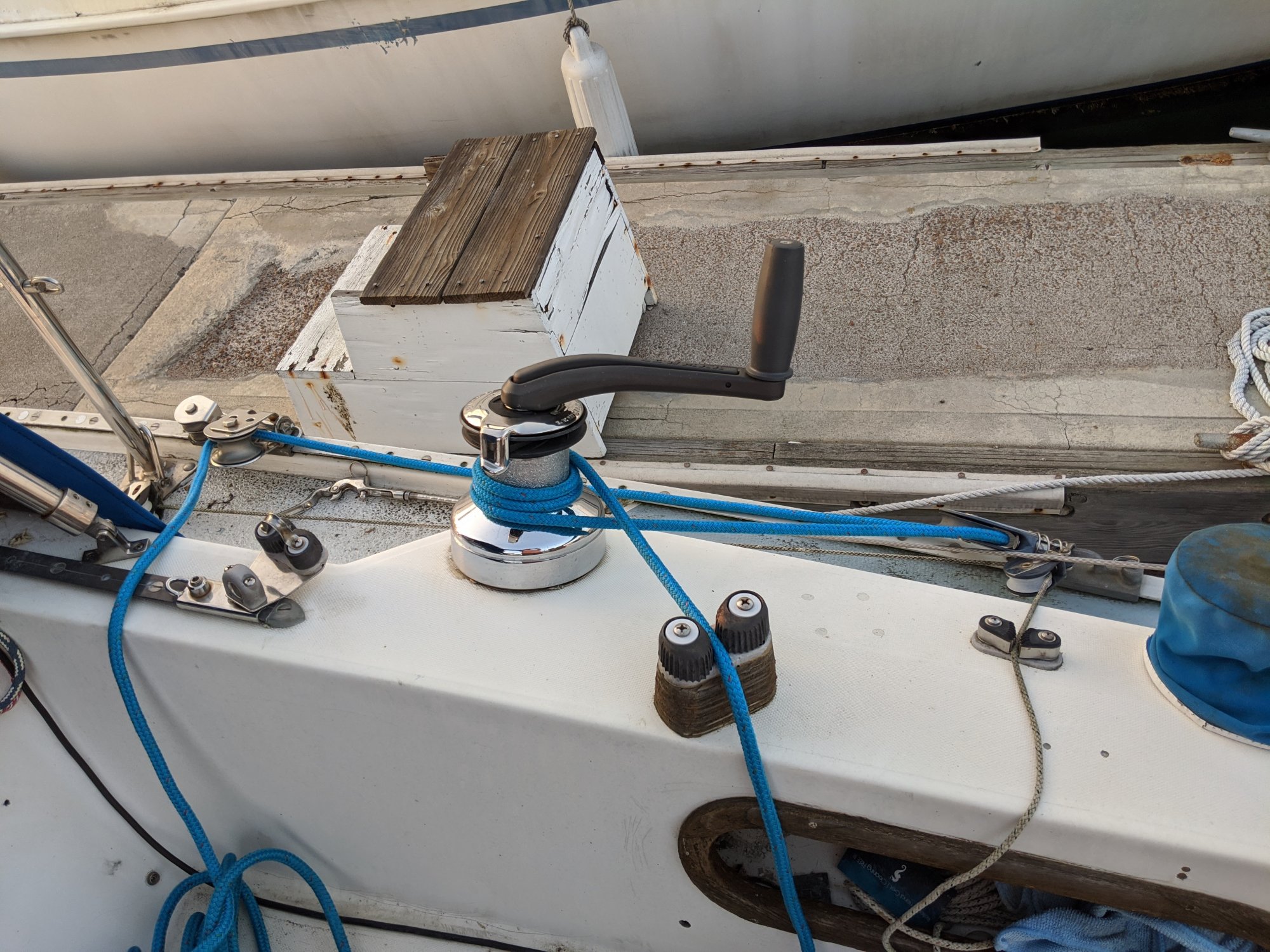

We did this on our Catalina 22 with the cam cleats. I 3d printed small riser blocks for them to get to the height I wanted. We do a couple of turns on the winch and then into the cleat. I have a winch handle, but have never had to use it -- with the winds we're usually sailing in 3 turns on the winch and you can tension by hand.

Cam cleats are what I would want. Put an eye on it and a stopper knot and I think you have a pretty good system.
That's my choice too. On my boat, which has the winches canted out a bit, the cam cleats are on risers to give the sheet a level exit from the drum. I do not use fairleads on the cam cleats. The sheets are entirely free to run when released from the winch. The open nature of it allows quick setting and release, no chance of a kinked line getting caught in the bulls eye fairlead.
