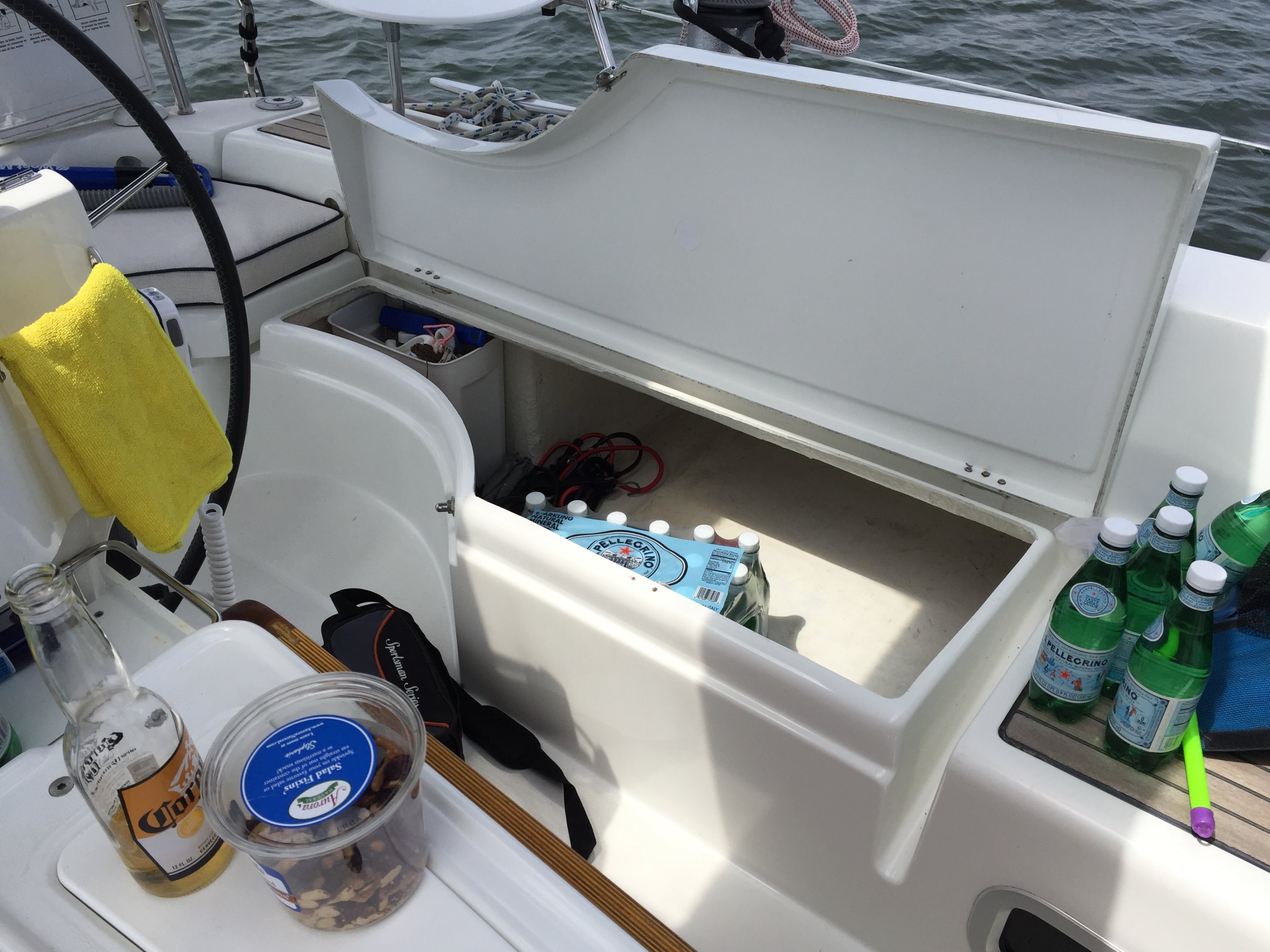

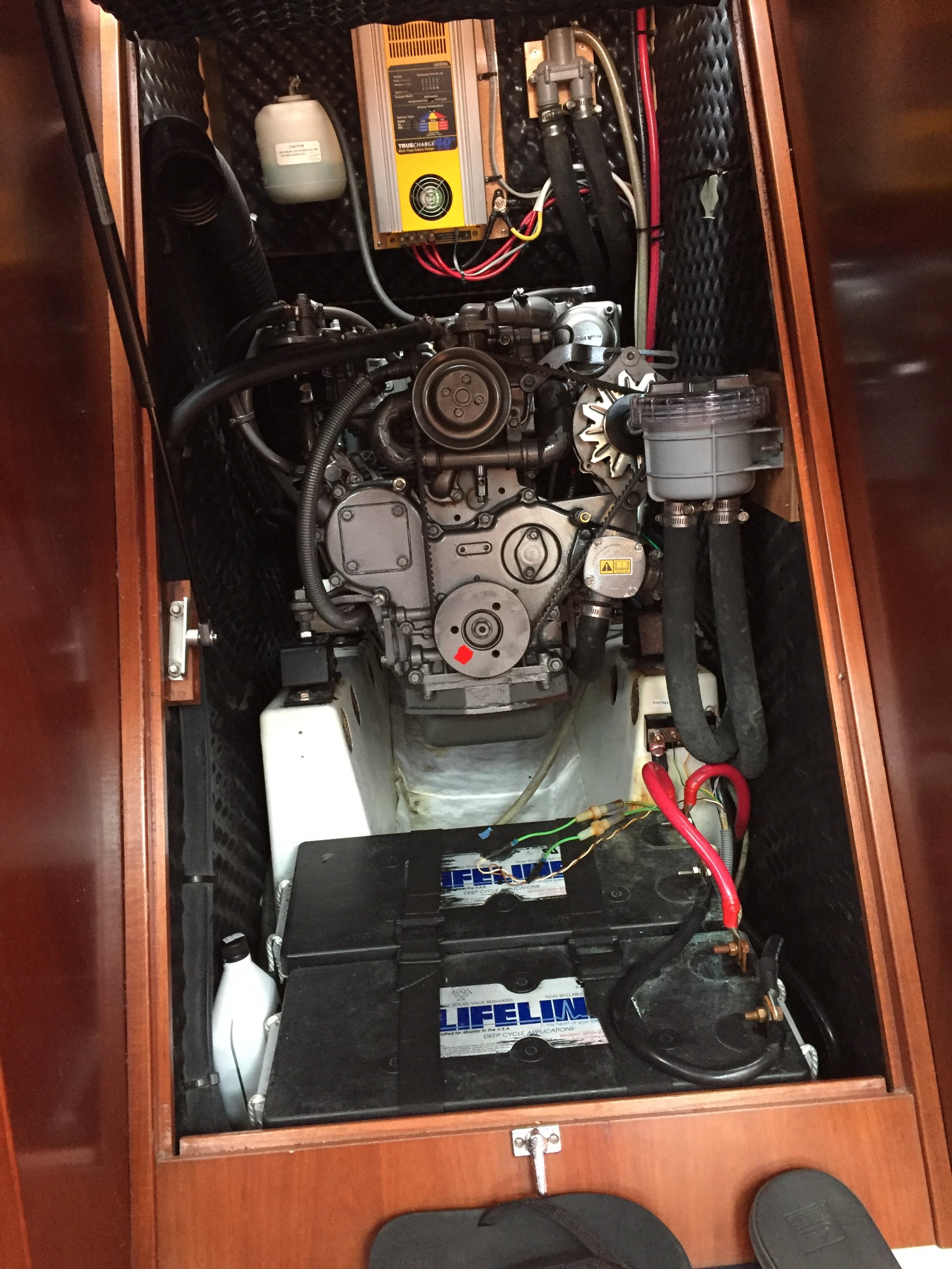

So based on advise from Maine Sail I would like to relocated my house battery bank. Beneteau place the house within the engine compartment which obviously gets hot regardless of the exhaust blowers built in to this space. Currently I have two 4D agms however wish to ditch these for maybe 5 group 31's so I don't have the task of lugging 150 pounds each worth of lead when they need to be changed. The current location is ideal in regards to being low and center in the boat. My best option would be my port lazerett. I will be able to get 5 group 31's in this space with no problem and still have plenty of room for additional storage. This puts the weight 8 feet aft and 4 feet higher than the current location. Also this could help off-set the fact that I have a 350 lb genset located in the starboard lazerett, however the genset is 4 feet lower and slightly aft of where potential new location would be. The boat does have a slight list to the starboard by design and is accented by the genset. Regarding wiring, the lazerett is just above the current battery switches so no real difference in distance and an easy wire run. Also I recently added 100 feet (160lbs) of chain in bow with 55lb anchor.
So I guess my question would be do you think this would alter / change drastically the performance of the boat? We are cruisers that like nice performance.
Attached are a couple of photos....
Thanks!
Current
Proposed
Thanks!
Current
Proposed
