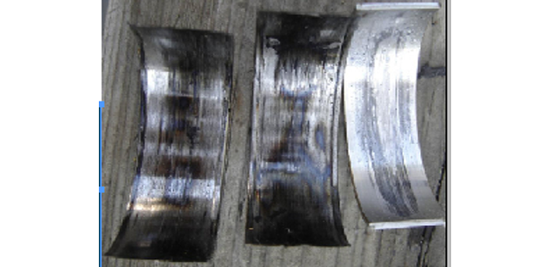

Sadly this weekend my engine, a Westerbeke 30b, developed a rod knock as I was returning to my slip under power. Upon hearing the noise I noted no abnormal engine conditions, but immediately shut everything down and sailed the rest of the way home. I've been paying close attention to the engine temps and oil pressures since de-winterizing and haven't noticed anything out of the normal this season (~170 deg water temp and no less than 30 psi of oil pressure at idle when hot. Closer to 50psi at idle when cold). I drained the oil which was slighty metallic and the dropped the pan to find obvious signs of bearing failure. I felt the play in all three rod ends and cylinder one was the culprit. I pulled the rod end off to reveal:
I went ahead and took the other end caps off; they looked and felt fine but I will follow up with a proper measurement to see if they're in spec. This is such a bummer way to kick off the sailing season. If anyone would be willing to share some wisdom I have a few questions:
How screwed am I? I honestly can't tell if the crank is salvageable. The crank journal is trashed and the discoloration scares me. The discoloration is not isolated to the bad cylinder which makes me raise an eyebrow though. Right now my fingers are crossed that if I take the crank to a machine shop they can turn/polish the journal within spec of one of the two available undersized bearings. A new crankshaft is going to run over $2k. I'd have to believe that rod #1 is trashed as well? There goes another $500.
